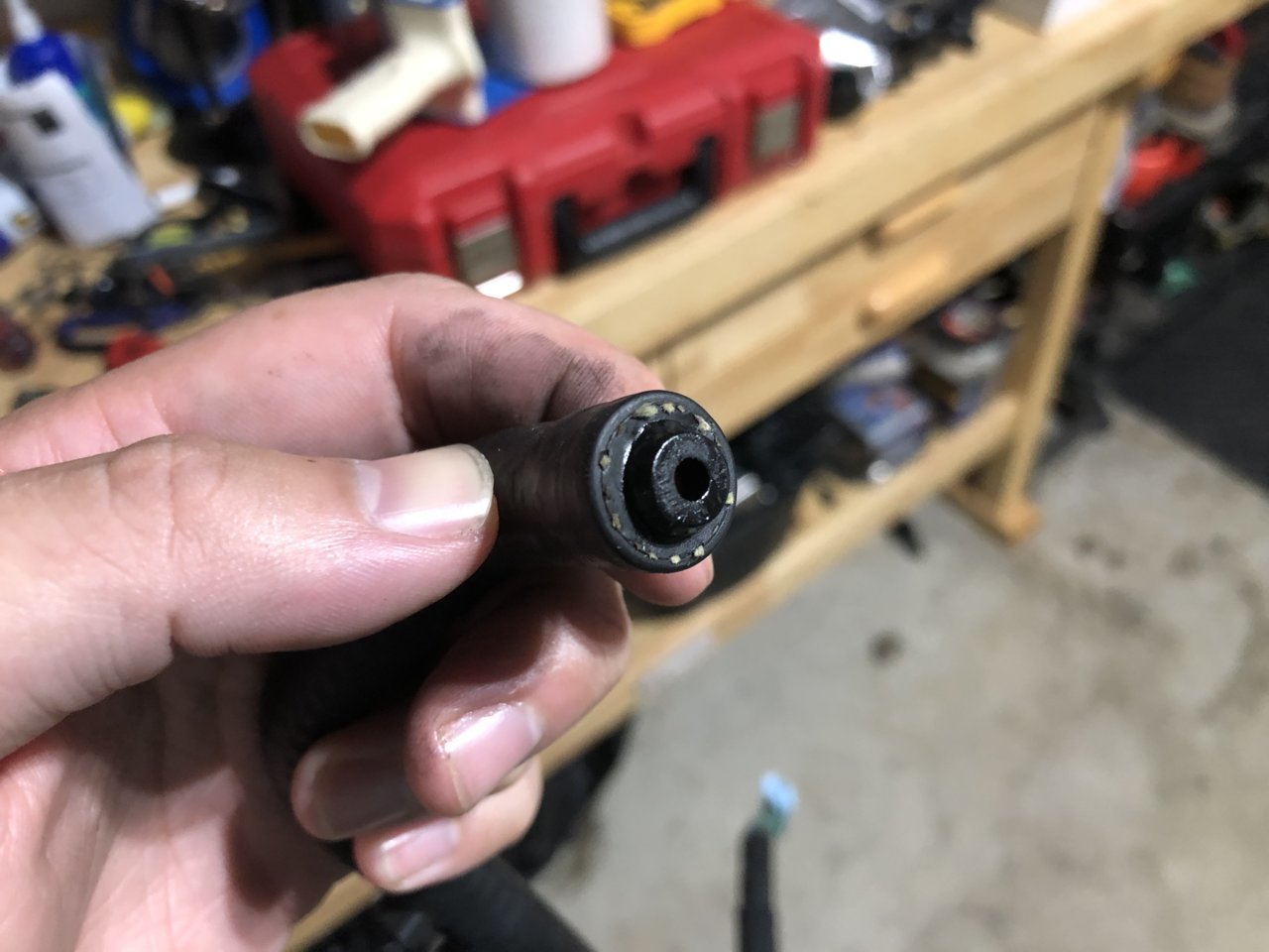

    Update:
    Pano hasn't leaked but I have an appointment next week with the dealer to go over the broken mirror cap, cracks in windshield, and other small items I noticed since I bought the car. I'm going to toss in that the vent in the rear has a missing tab as well, and see if it's something they can cover as well.
    Also, on the low coolant light issue, I think I know what it is.
    I checked the hose today and on the radiator elbow it had signs of a leak, which I thought was stange.
    So I googled a bit and found this:
    https://www.vwvortex.com/threads/coolant-isssue-after-installing-ie-intake.9464317/
    This guy has the same intake and the same issues with low coolant randomly.
    Upon browsing it seems that a check valve needs to be in the coolant line in order to get everything to function properly.
    IE doesn't include this bit of information or the valve in their $35 dollar coolant line, which is a huge oversight. I'm going to transfer the check valve over tonight and see if that solves the issue.
    APR instructions for transferring check valve: https://documents.goapr.com/ci100033a_mqb_coolant_hose.pdf
    Racingine hose that is identical to the IE one but includes the check valve: https://www.racingline.com/vwr17-g7r600
    Check valve to trnasfer:

    Got the check valve out of the stock host and into the IE hose.
    From stock it was in the end that was closest to the radiator with the chamfered end being in the direction to the radiator.
    the means the flow is from the radiator and to the engine. I put the check valve closer to the engine on the other side in the same orientation, with the chamfered edge facing the radiator.
    After a test drive and shutting the car off it no longer whines as the flow back to the radiator is blocked off. Glad I only drove without it for a few thousand miles! Most people don’t even run one and I’m sure that’s bad for the pump!
