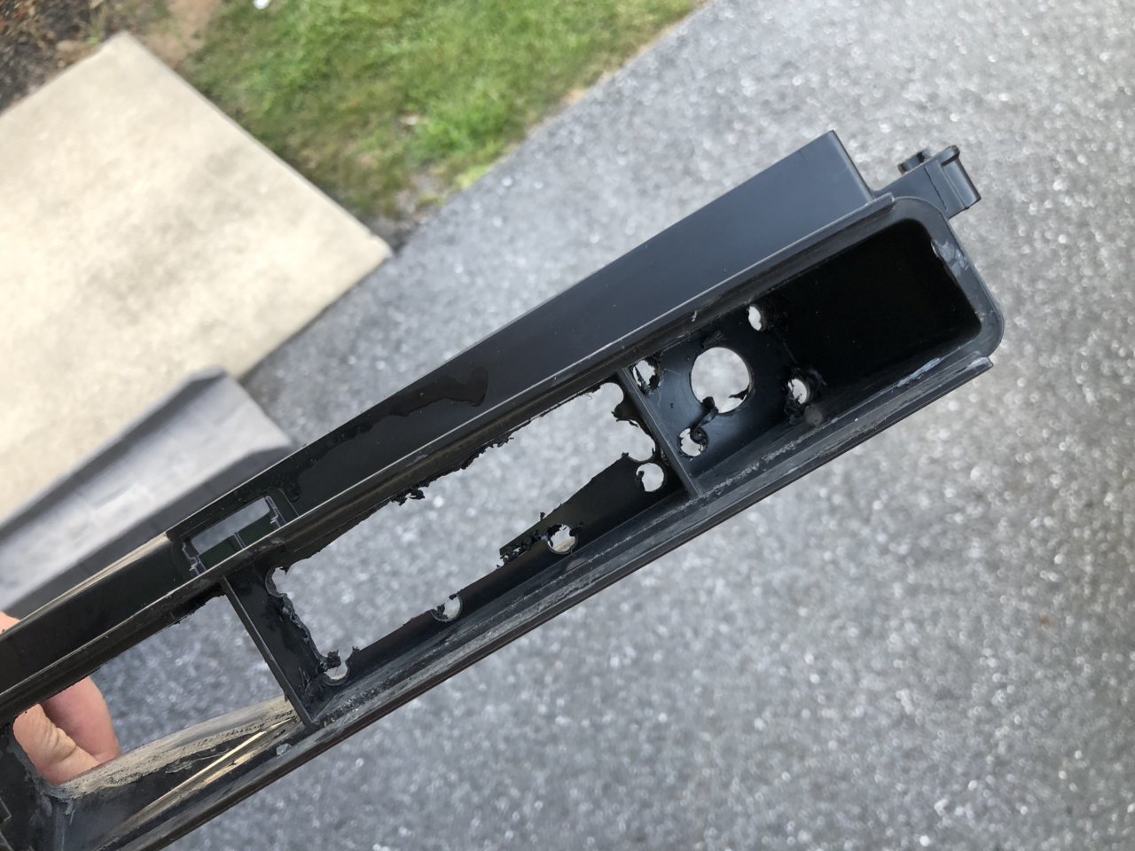

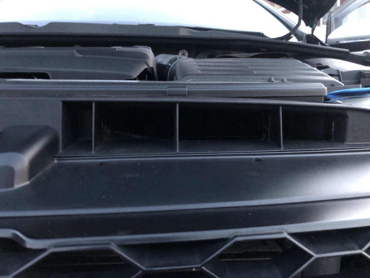

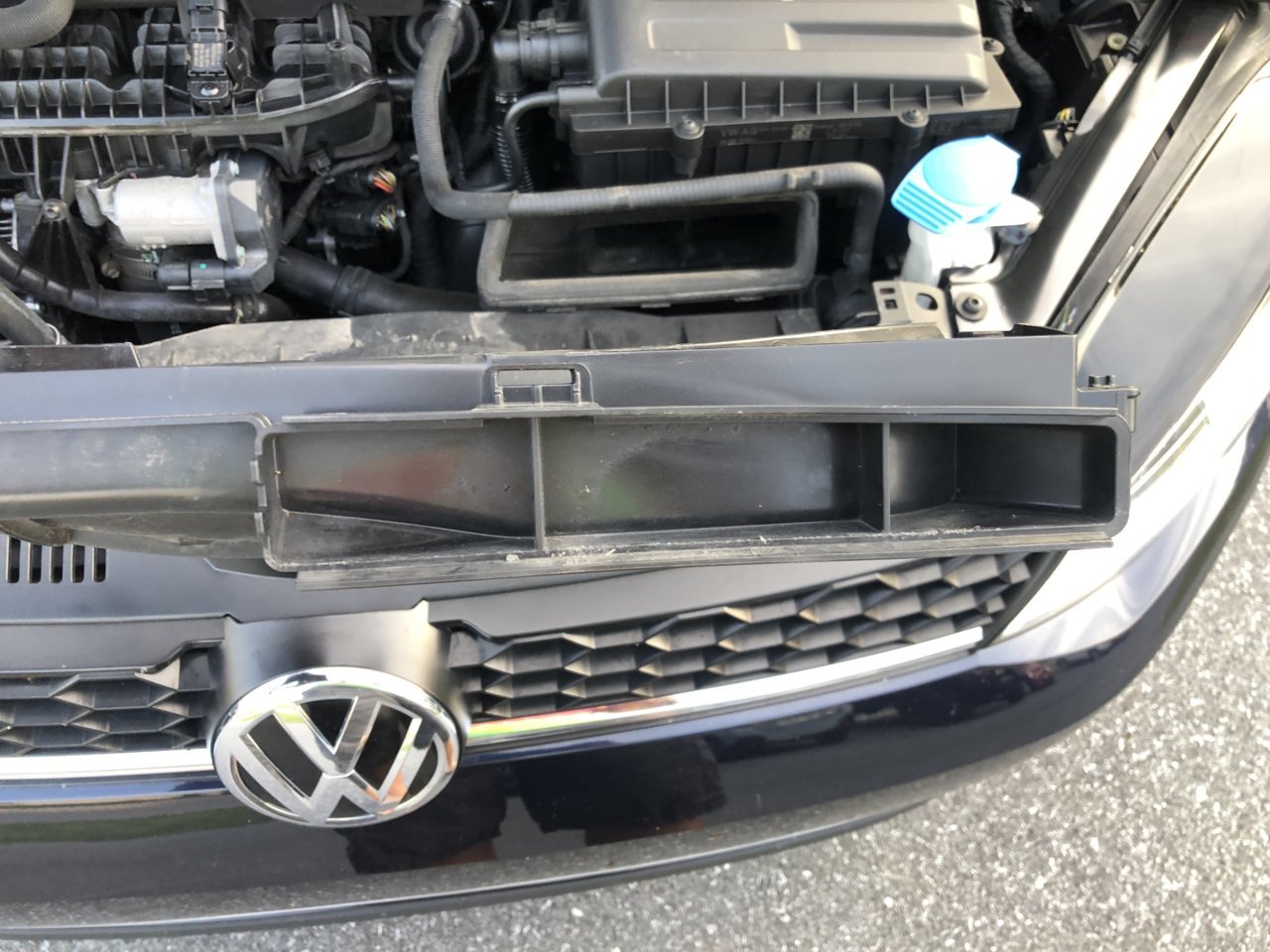

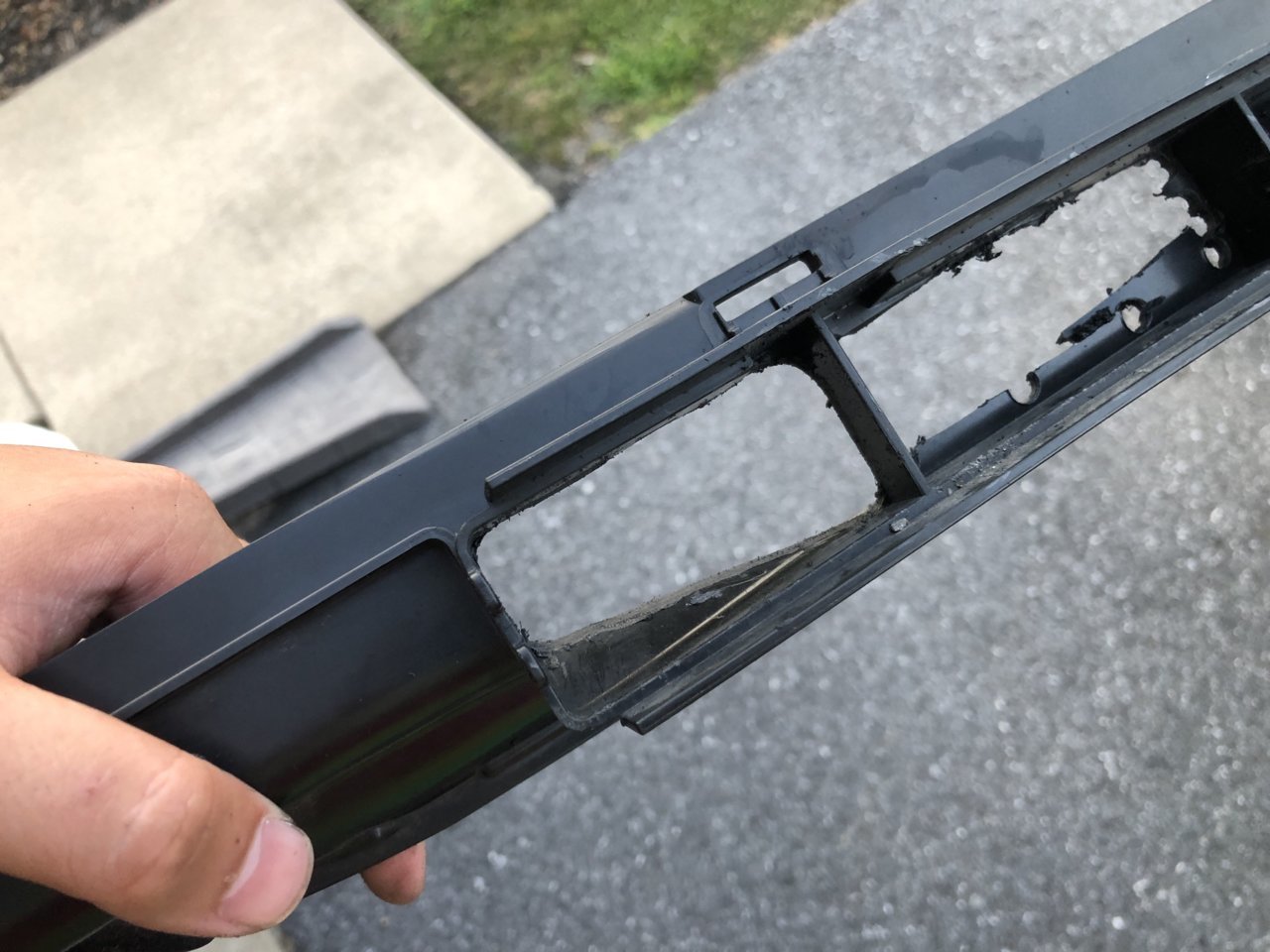

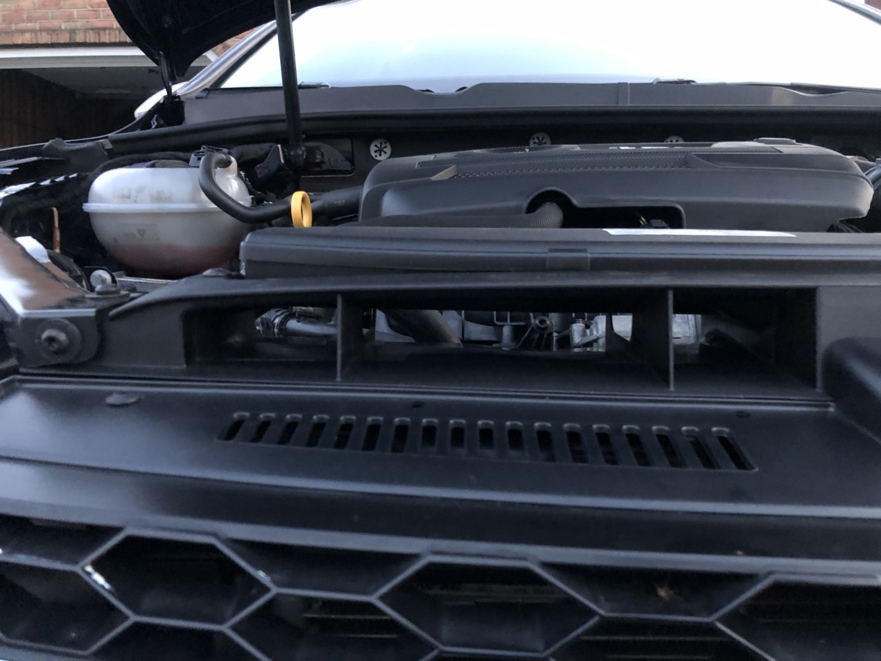

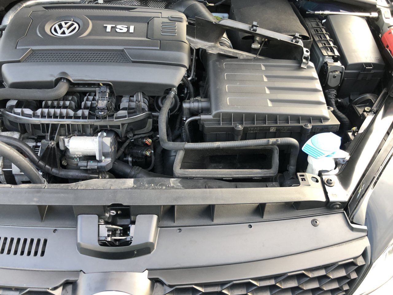

    On Friday, I wanted to try the airbox mod before our Saturday road trip to see if it netted better mpg or throttle response.
    First thing was to remove the snow baffling. (in the airbox, I didn't get a pic, so here's the one of the internet)
    And what the intake looks like without it:

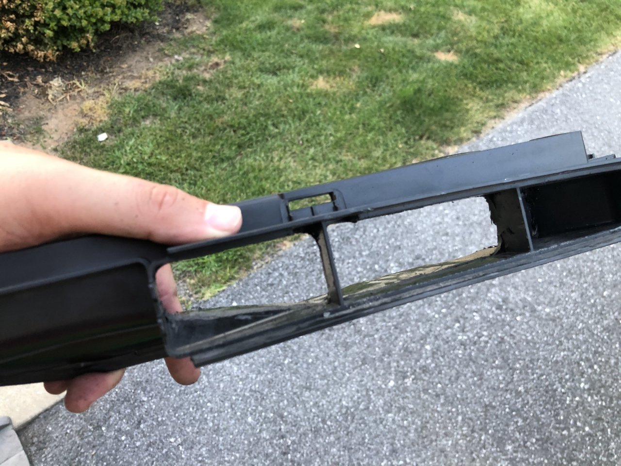

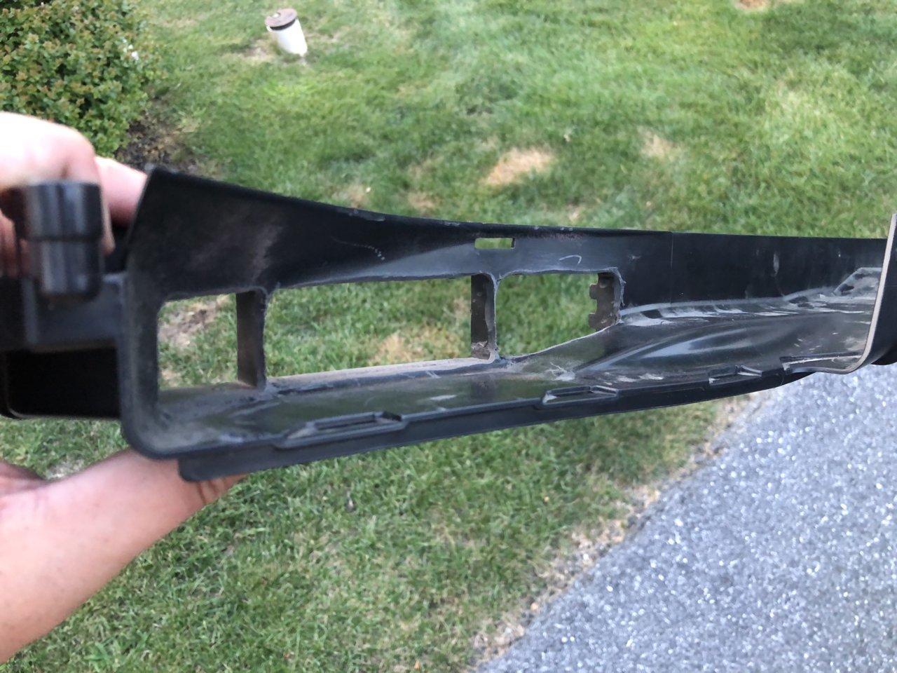

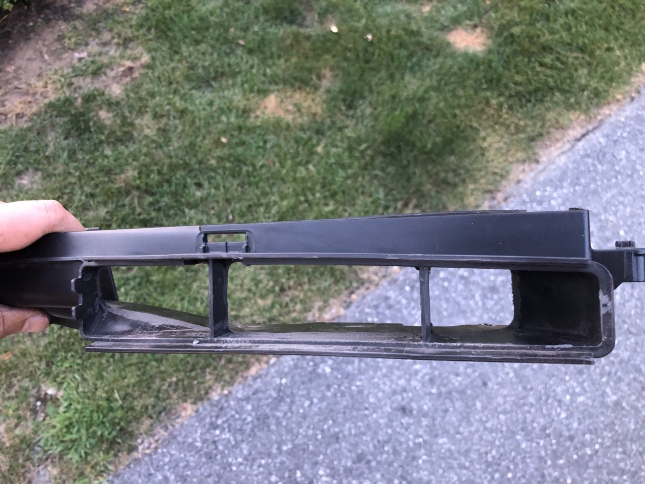

    next was to take the front scoop apart (it’s a partially closed intake from the factory) and you can see here that it directs air right into the bottom of the airbox
    here’s the driver’s side, you can see it’s blocked off
    So you open it up to let more air in
    Finished part:
    The backside of the trimmed piece:
    Here is the passenger side
    and here is the now open driver’s side
    I sanded everything and hit it with some back to black restorer to make everything look shiny again.
    This took maybe an hour including cleaning up the mess and the test drive. I didn’t drive the car enough before the mod to notice and mpg improvements but throttle response is definitely better. And I can kinda here the turbo spool a little bit, which is neat. Pretty stoked with this free mod.

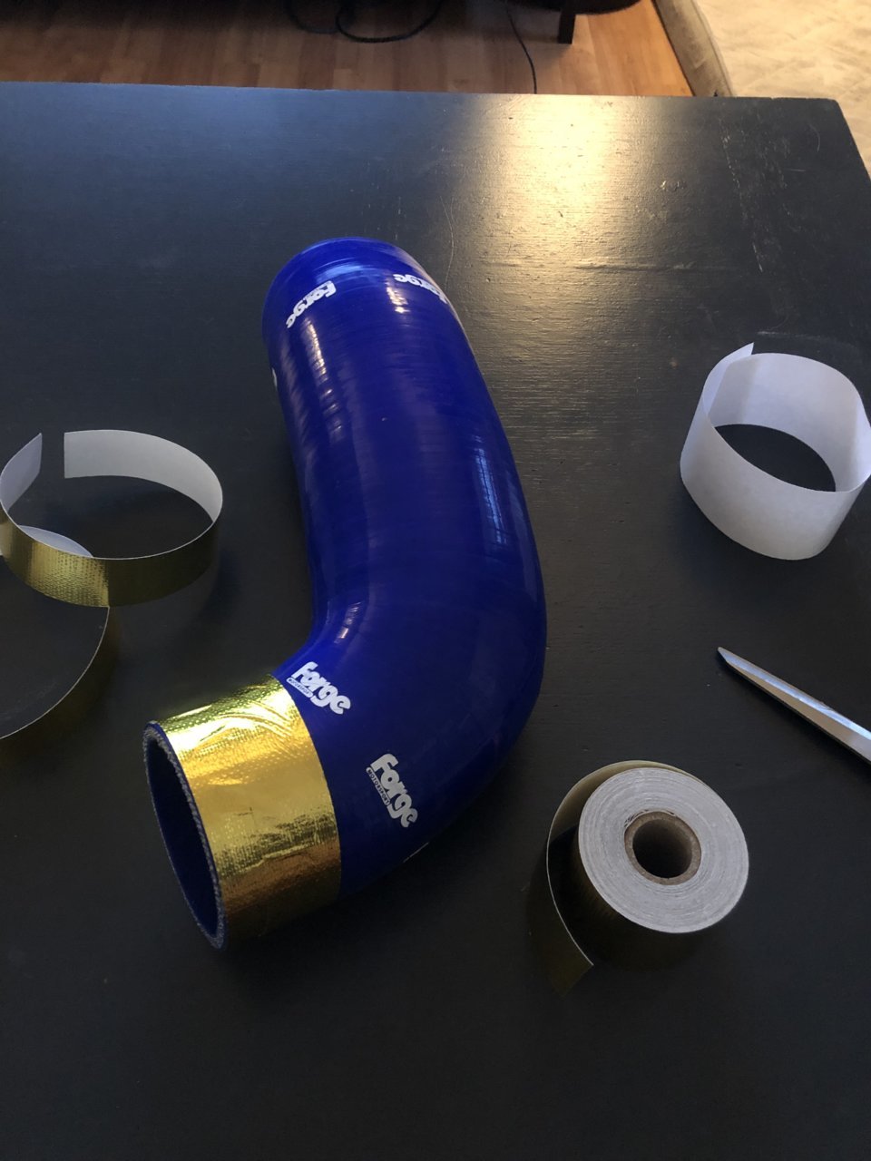

    I also made some impromptu buys spurred by a used part and more research from here:
    I snagged this for less than half shipped but I hate the blue: https://www.ecstuning.com/b-forge-p...f6bpQZLqWgl2VCecNiohPpNaAUp6uLixoCpooQAvD_BwE
    So I had to order a high flow panel filter to fully benefit from the rest of the changes:
    https://www.amazon.com/gp/product/B00CR9WWN0?ie=UTF8
    And I ordered some hot boi gold reflective tape to be used on the turbo inlet pipe to hide the gross blue. If it works great, if it doesn't NBD too.
    https://www.amazon.com/gp/product/B08XT1PCD8?ie=UTF8
    https://www.youtube.com/watch?v=cxUBz7MkiAA
    Also, I'm going to wrap my intake on my Tacoma with this stuff to try and help with the heat soak in the engine bay.
    So basically for the fraction of a full on intake you can mod the stock one to get basically the same airflow with no heat soak issues.

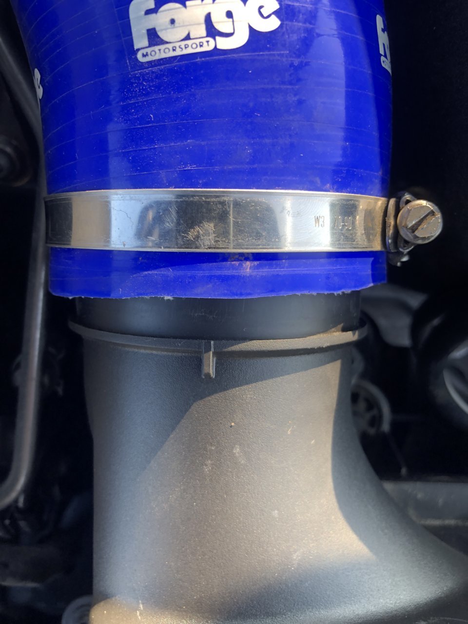

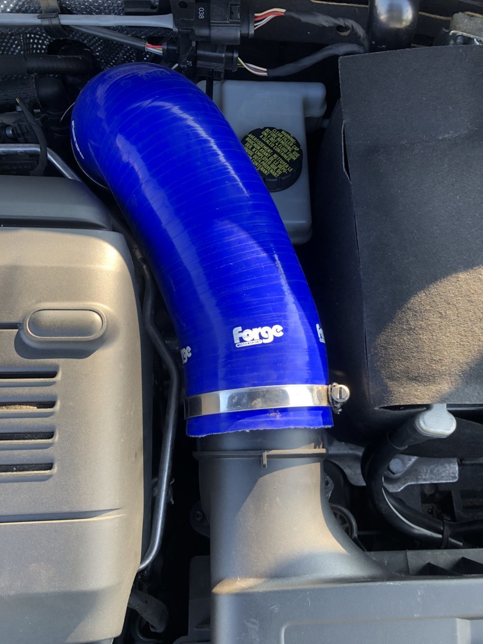

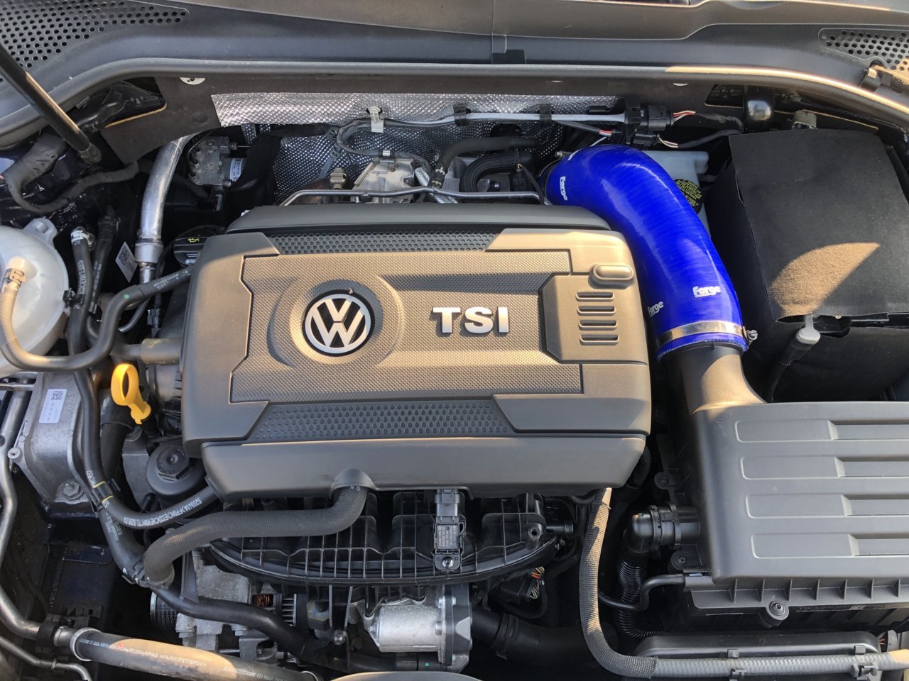

    Forge Motorsports intake arrived!
    got it used and it looks like the previous owner might’ve cut it short for some reason
    I was able to make it work without any leaks, so I proceeded to the next step!

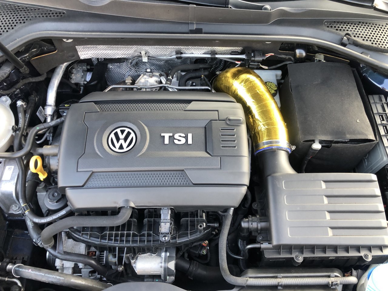

    So I hate the blue, especially as my car is blue.
    Hot boi reflective gold tape!
    Finished product
    oh, and I put a K&N drop in filter too. I can now hear the turbo a lot better and it does feel quicker on the butt dyno. I also need less pedal to get off the line. Overall love the results!
