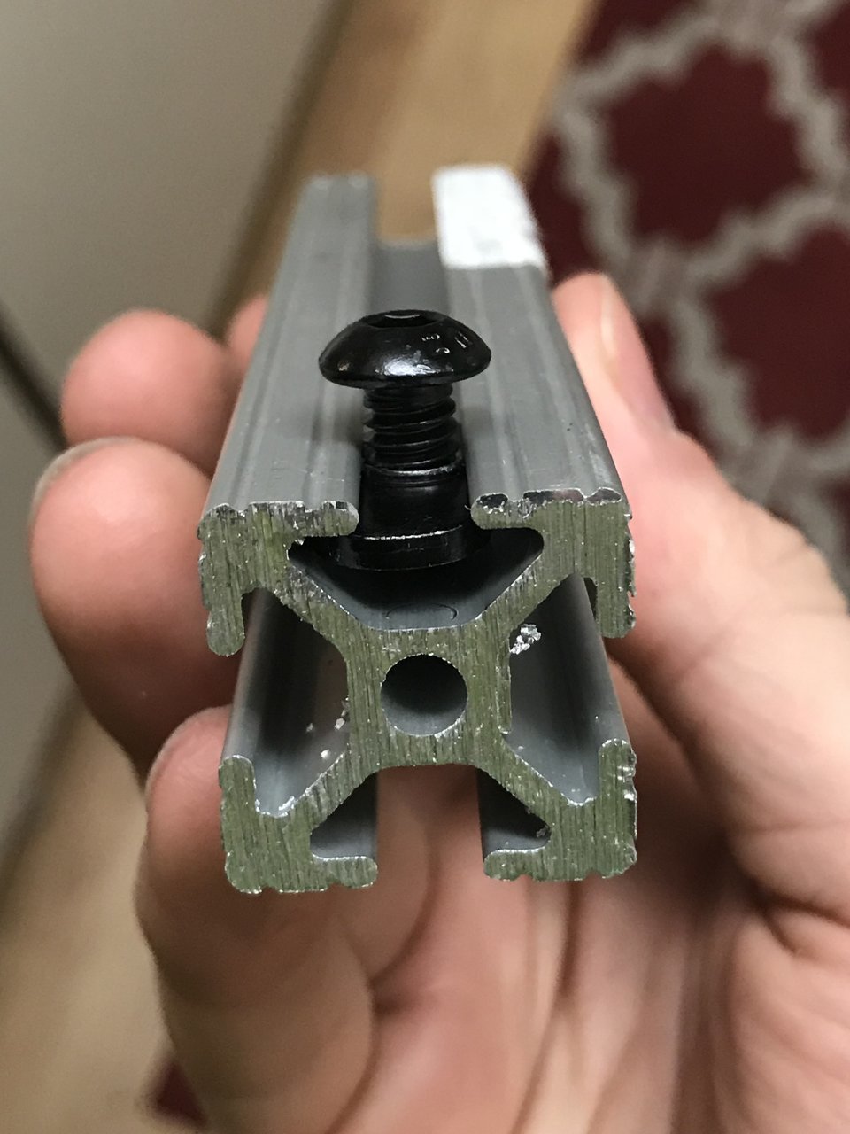

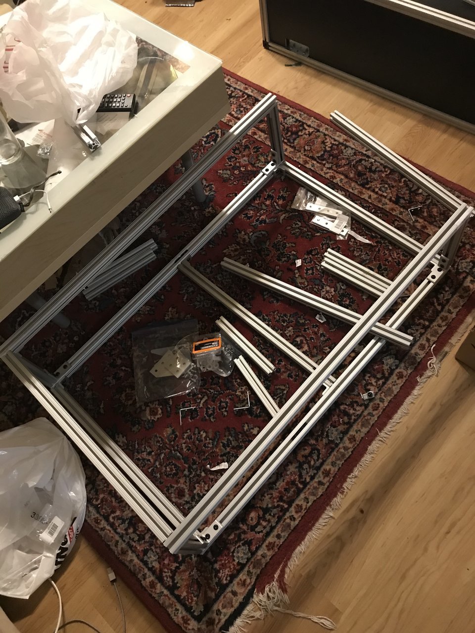

    Basically. I bought a pack of these and use them to construct the frame as well as attach the stove slides.

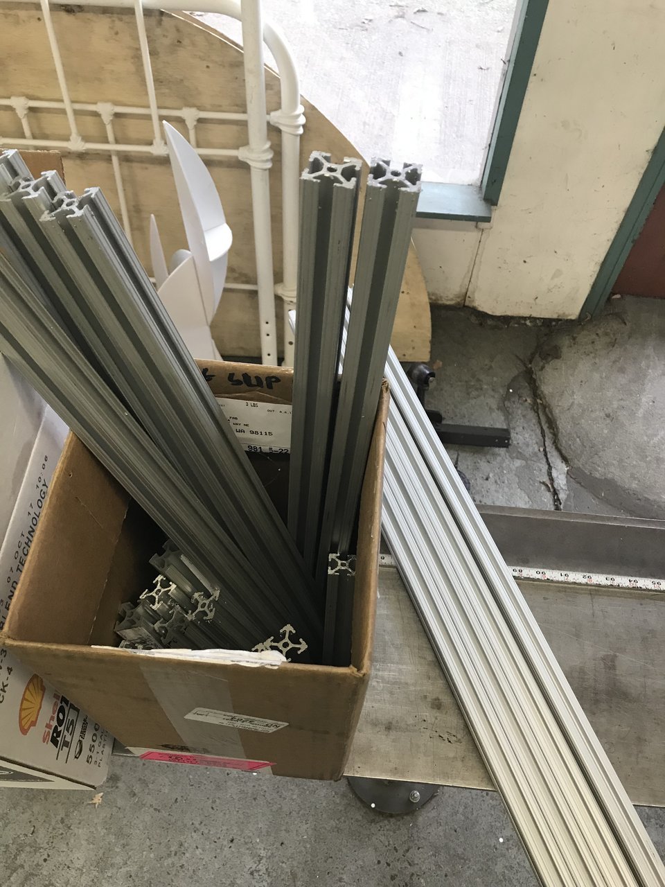

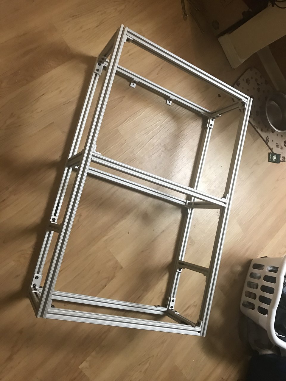

    Decided to redo my drawer out of 80/20 as well. The material itself isn't srper expensive, but the angle brackets I need to attach it are like $3.40 so it's almost $7 per bar and of course I didn't buy enough so couldn't get it finished up today.

    Finished up the framing on the drawer today, weighs only 16lbs.
    It's probably about $100 in 80/20...and another $100 in corner brackets.

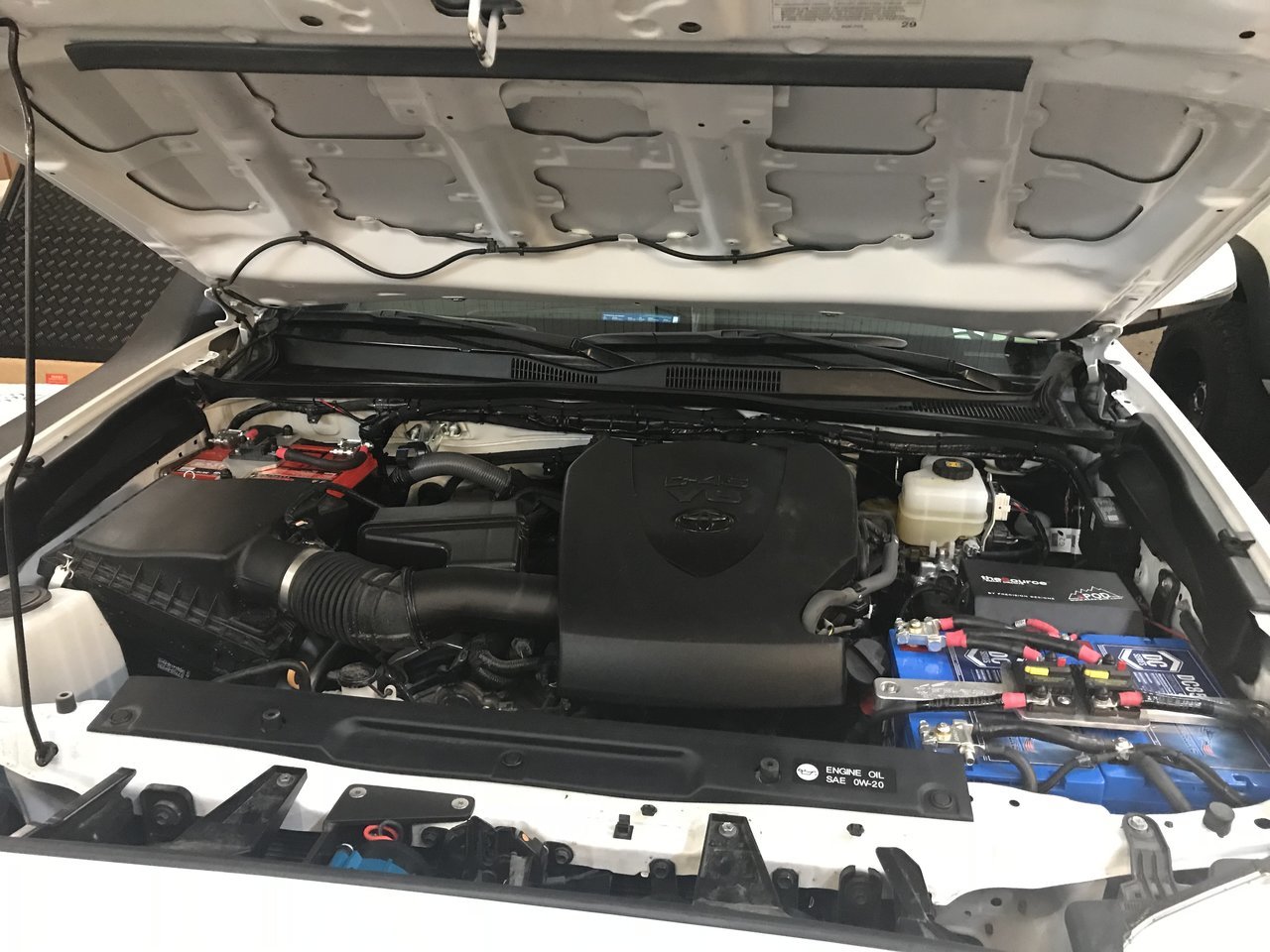

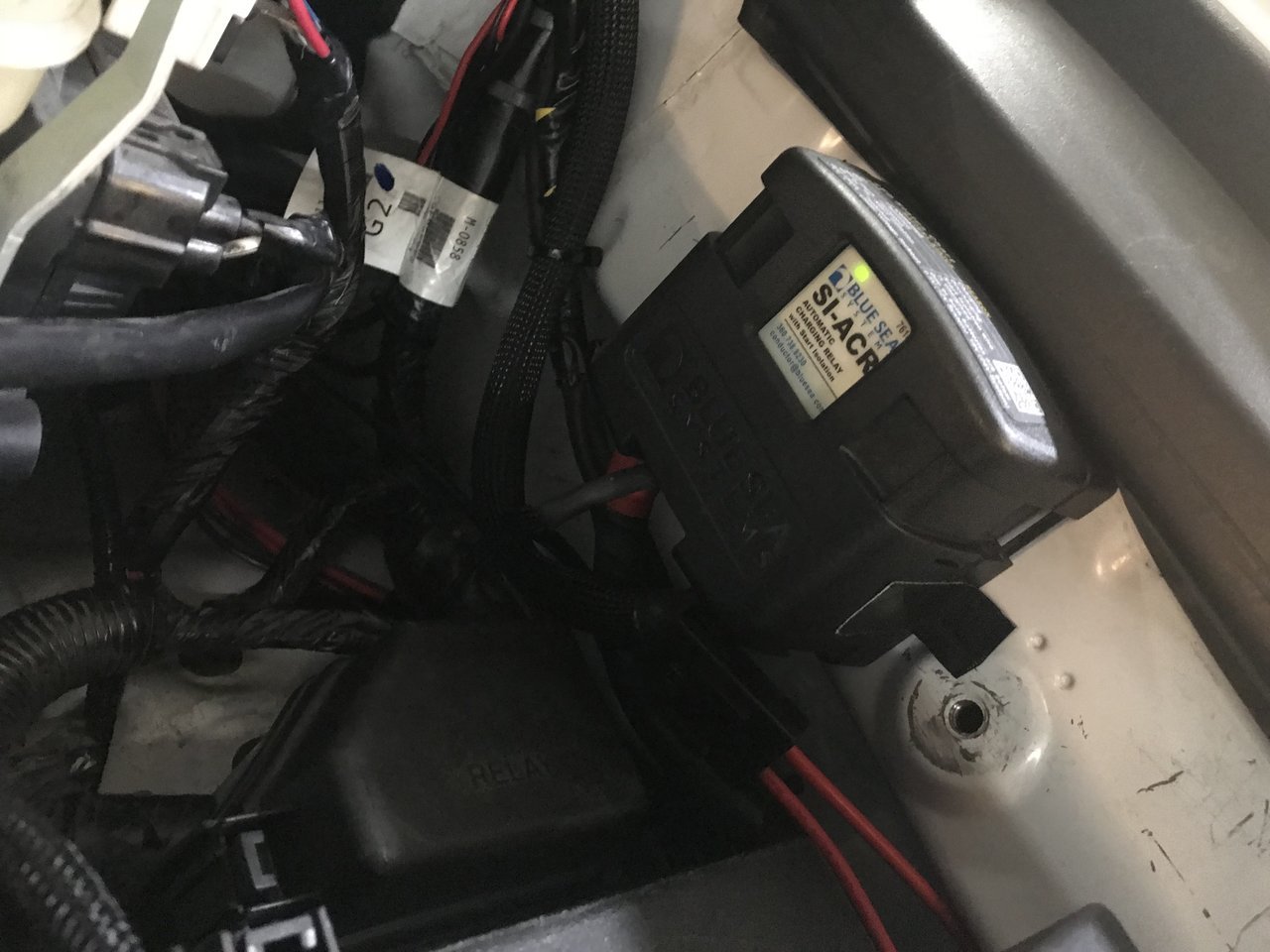

  12. Mar 6, 2018 at 8:10 PM
    #52
    danneskjold
    danneskjold [OP] Well-Known Member
    Aug 20, 2017
    #227402
    1,285
    Brian
    Shoreline, WA
    2018 F150
    I joke that I know how to do a lot of things but I don't do anything well.

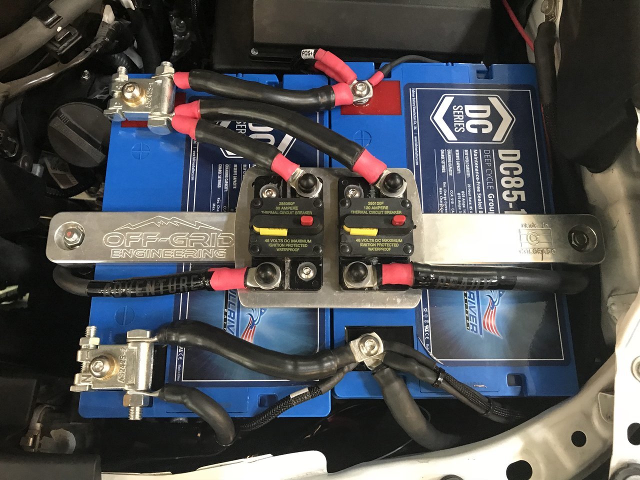

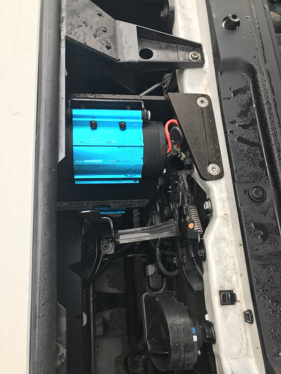

    I forgot to take some before pictures, but the dual battery system and all the peripherals under my hood hadn't gotten real complicated, ugly, and unwieldy. In the beginning it was okay, but as time went on and I added more stuff it got worse and worse.
    So I took it to the folks over at Adventure Ready and they did great work redoing my system.
    • New starter battery - Odyssey Group 34 relocated to passenger side
    • Dual house batteries - Fullriver DC85-12 batteries for a total of 170ah
    • Mounted Blue Sea Systems ACR to side of engine bay
    • Mounted ARB Dual Air Compressor behind the grill (mount is a soon to be released product)
    • SPOD wired to house batteries (was wired to starter)
    All of the accessories are wired to the house batteries so that the starter battery is completely isolated.
    Ended up paying way more than I wanted, but I got the piece of mind now knowing that everything was put in professionally and will last for years to come.

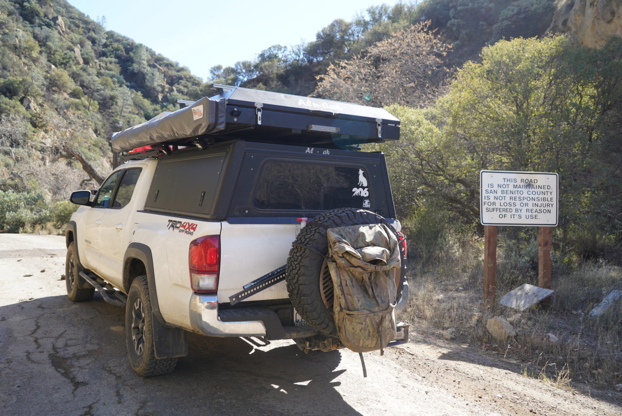

    Had to drive down to Fresno (yet again) for work, and afterwards went on a little camping trip.
    The goal we wanted to hit was Hernandez Reservoir, but unfortunately we never made it - but we were still able to salvage a good trip out of it.
    I had been eyeing Hernandez Reservoir for awhile now, and using a map I basically followed dirt roads leading out of it until I converged on I5. With the route put into Gaia GPS we departing from I5 around Mendota area our goal was to drive down Panoche Road (dirt) until it hit New Idria Road and then follow that to Clear Creek Road and into Hernandez Reservoir.

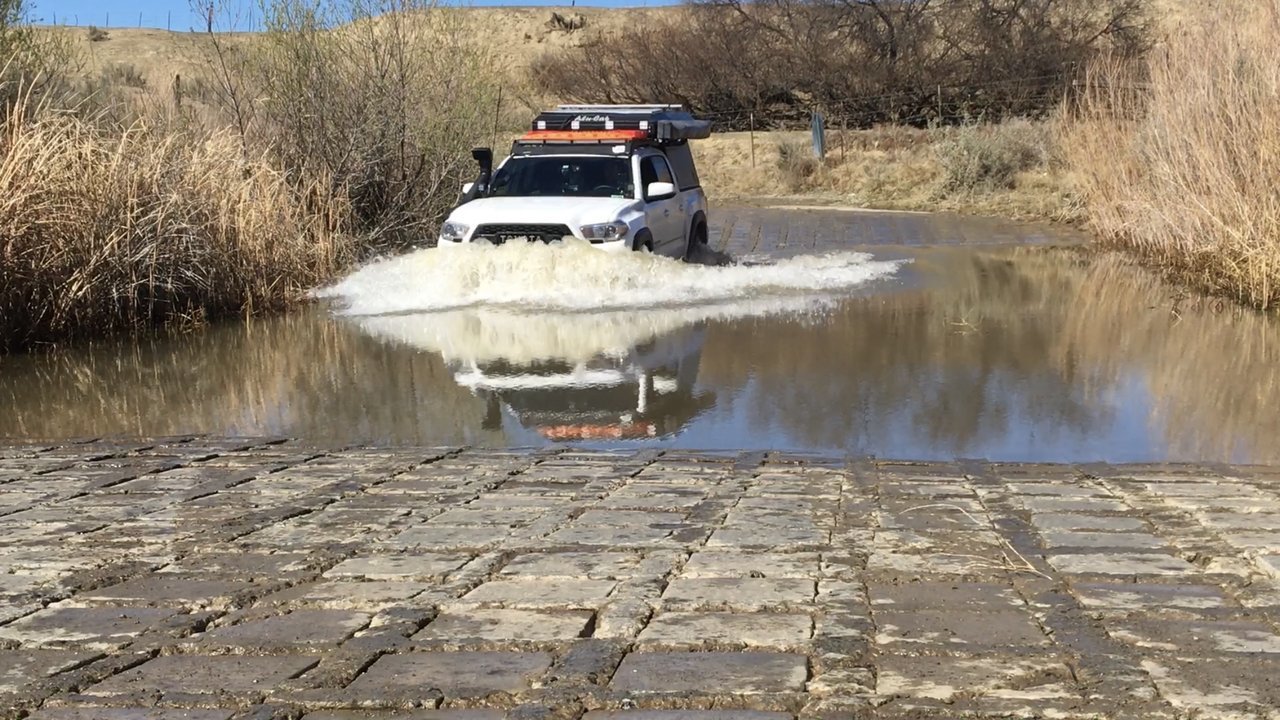

    The first problem we had was water across Panoche Road at a low point. It had rained substantially a couple days before, and given that this was the only portion of the road that was paved it's clearly a known issue. My Tacoma had no problem making the crossing, but the water was too high for the RAV4 that came with me.
    A detour was found that took us all the way back to I5 and up around on Little Panoche Road - a beautifully paved road for several miles until it crossed from Fresno County into San Benito Cty and the beautiful payment promptly ended dumping us onto a rutted patched paid road that took us to New Idria Road.
    New Idria Road lasted for probably close to 20 miles until an ominous (and welcome!) "This road is not maintained" sign at which point the patchy asphalt turned into a dirt road.

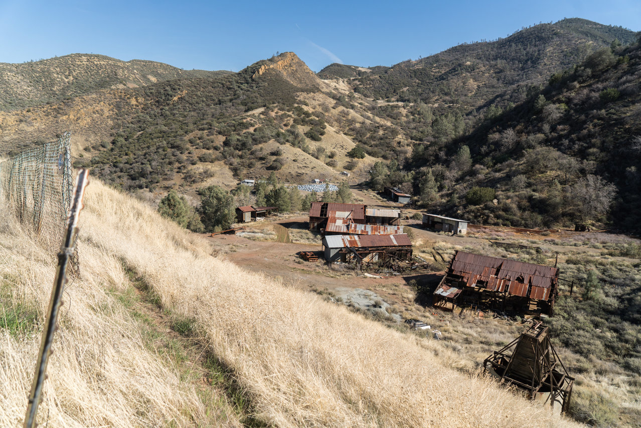

    A mile or so up the road we ran into New Idria Mercury Mine, which to be honest I had no idea was there. Originally built in the 1850's New Idria Mine was in operation until the 1970s and of course, now, it's a ghost town and EPA super fund site.
    The dirt road proceeded past New Idria Mine and snaked it's way up through the mountains. There was quite a bit of mud because of the recent rains, but otherwise the road was in good condition.
    We also passed the New Idria Dam which because it's position reminded me of an infinity pool.
    Unfortunately - shortly passed the dam we encountered a locked gate forcing us to turn around and camping at "Chileno Camp" maybe a mile down the road. Chileno Camp was a nice, open clear, spot which presumably housed Chileno miners at some point.
    For dinner cooked some steak meat on my Front Runner tire grill which is one of my favorite pieces of kit.
    The site showed significant signs of use - lots of trash (mostly beer bottles) were strewn around as well as some pieces of abandoned firewood. We used the firewood, and I did my best to pick up the trash but only had room for a bag in my truck.
    You can see my tracks here: https://www.gaiagps.com/public/bYlzcCAHzagjlc6N7HgjpXOk
