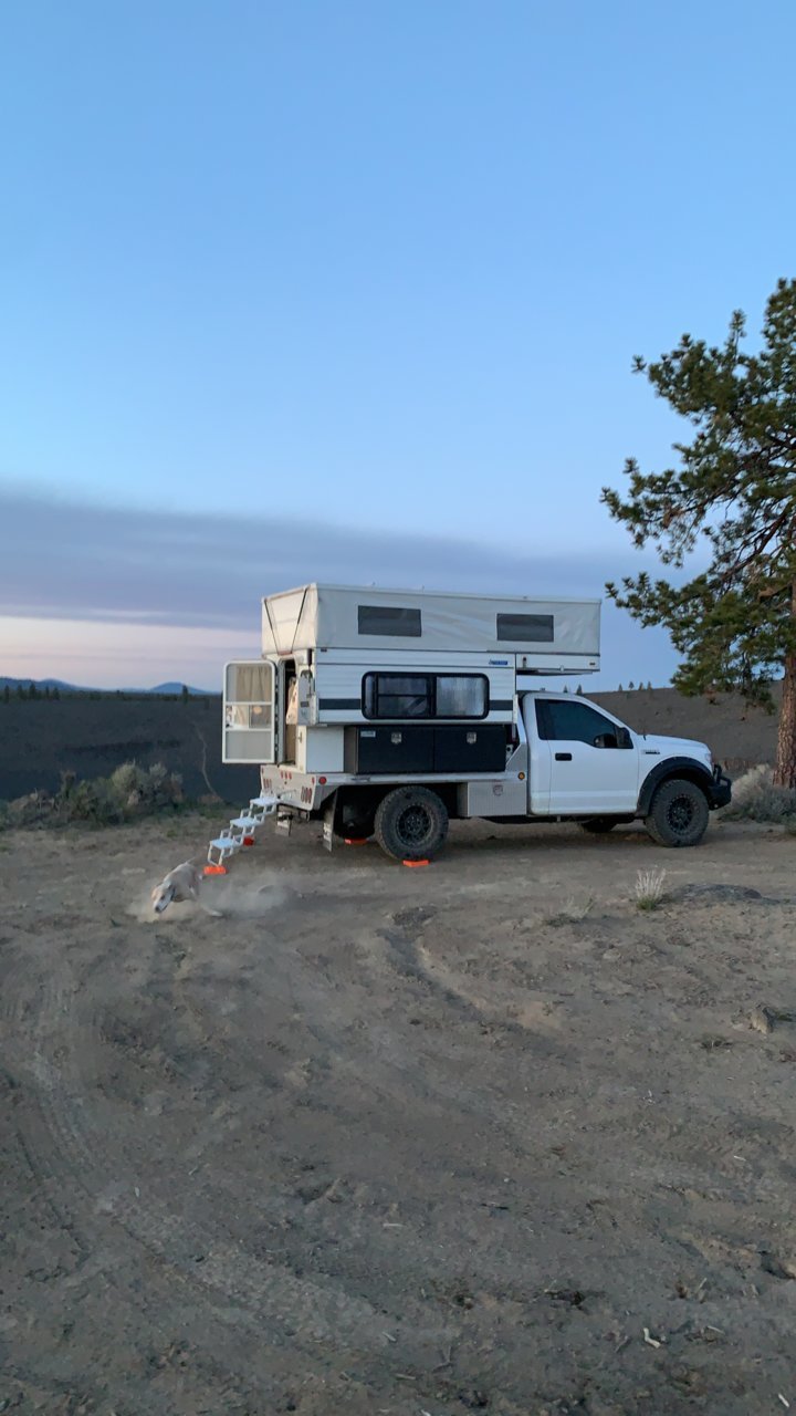

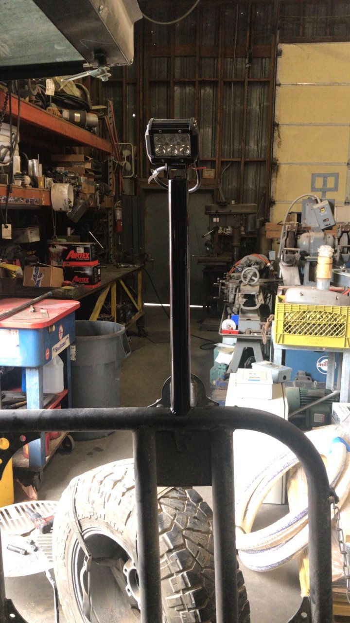

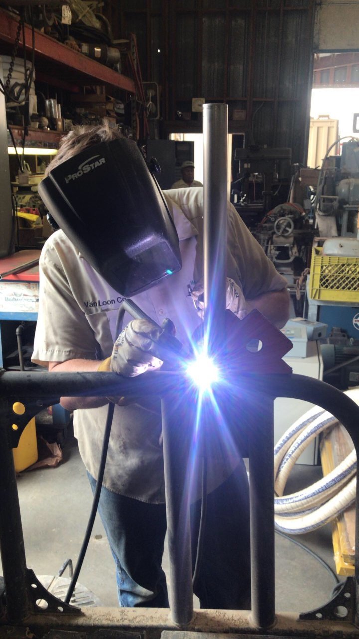

    I really need to update this thing but funny you should ask today.
    I have had an SOS Concepts High Clearance Dual Swing Out which I absolutely love mounted for about 3 months. I had it installed in SC and it went great - owner is a super nice guy and the worksmanship is fantastic.
    I had a metal pipe welded on today so I could mount a light to illuminate rear of truck and my kitchen.
    SaphiraTaco[QUOTED] likes this.
