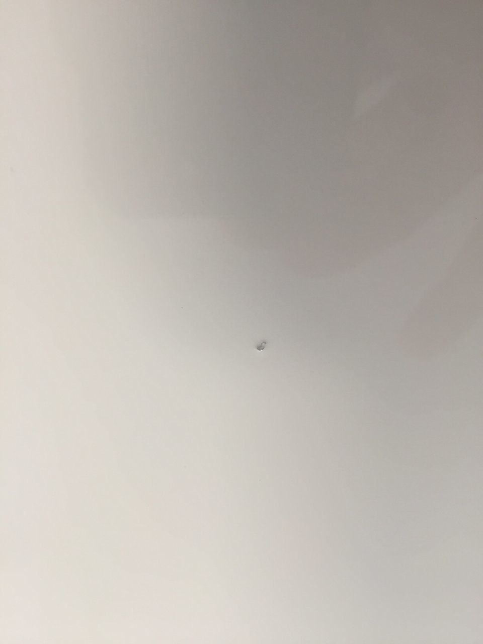

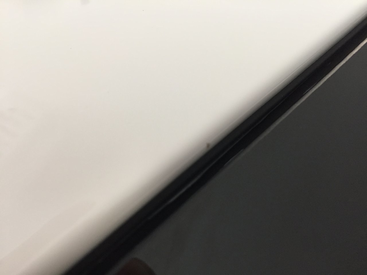

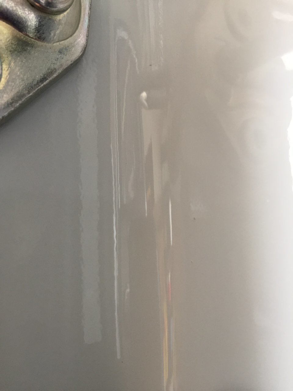

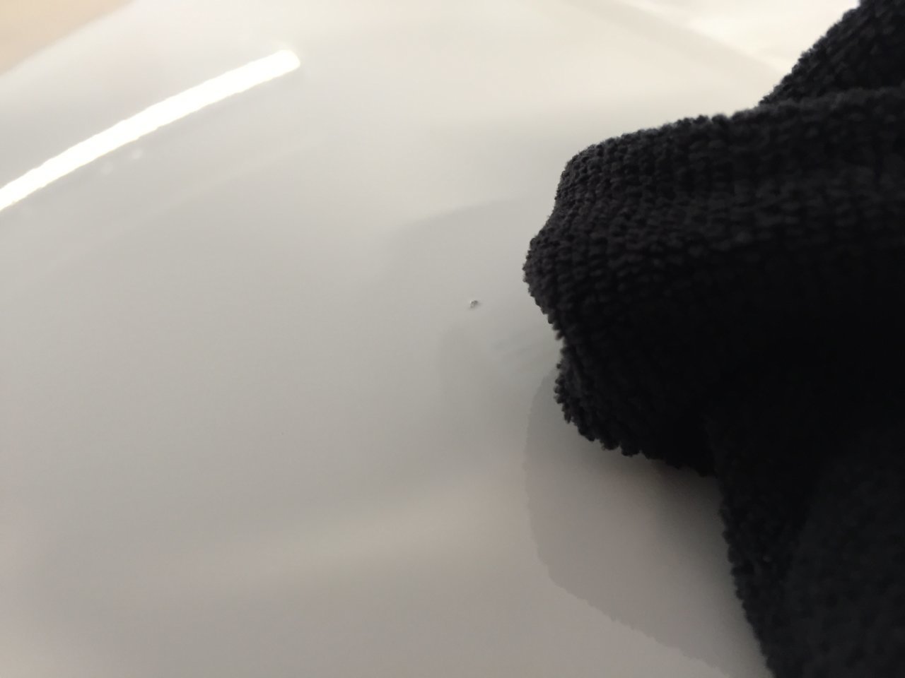

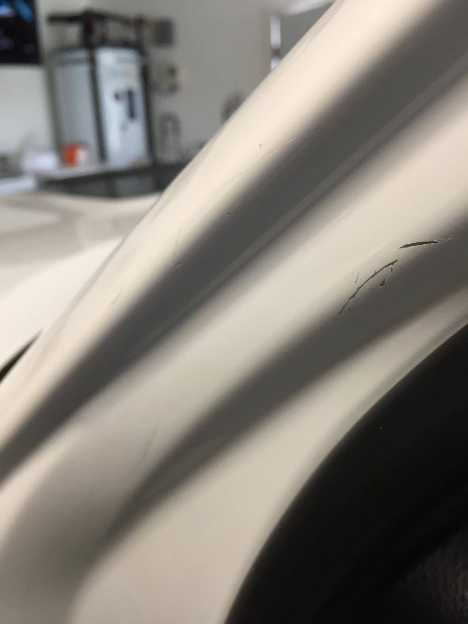

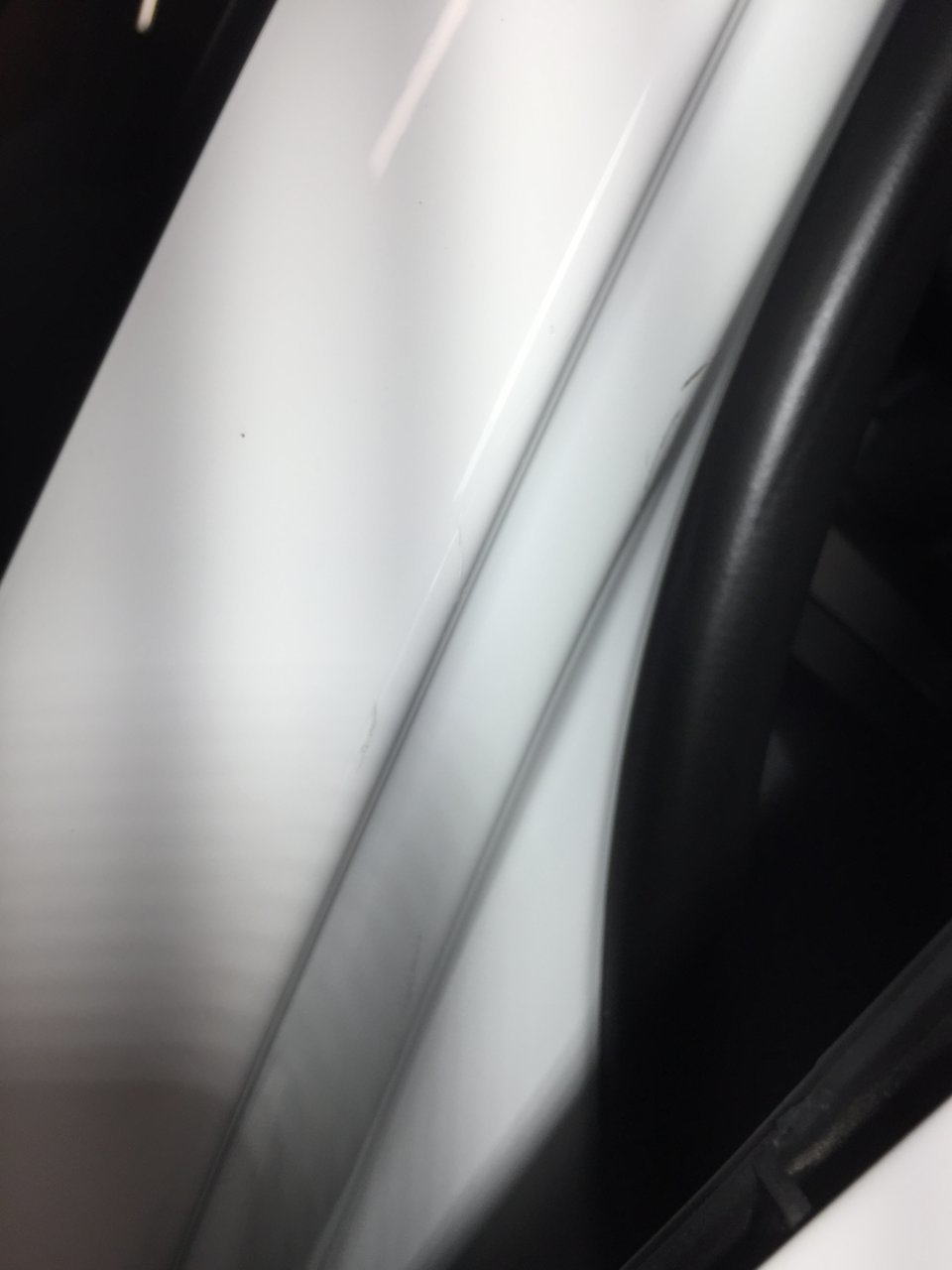

    15D90BAD-ABB4-4635-8BD0-A13963EF6450.jpg 4E957E58-6508-44AB-92D4-0801F0E8E9CA.jpg BEEBDAC7-D7E5-4006-A2B7-F8480AACCE30.jpg 83CA158E-680B-4841-B8D3-8CEAA76EC1BF.jpg C5C249C6-0F45-4D59-956E-2CD01BB696C8.jpg B75C5065-E22A-43CC-AD4A-A9A140DFCB87.jpg Help my brand new Trd pro 2018 super white Tacoma’s paint is all messed up. It has pimples under the paint every where and some good scratches in the driver door frame. This thing has less then two hundred miles on it I’m so bummed! The dealer is Big island Toyota and the don’t seem to give a fuck at all. I think I’m going to have to get a attorney. I have been in twice but they give me the run around. This is the worst paint job I have ever seen!

    This is good advice. Have a pro look at the pimpling and see if they can't tell you how it may have been caused.
    The picture you posted of the "scratches" look like scuffs you could easily clean up with a clay bar. Can you FEEL the scratches? If they aren't deep enough to feel you can paint correct them (ie buff them out). If they are deep enough to catch your fingernail #1 it's in the door jam so you never see it #2 just keep it clayed and clean and you'll never see them.
    It's incredibly rare to ever get a automaker to cover paint defects. The largest reason being it's really hard to prove once you take the truck off the lot, that the damage isn't your fault. The door jam scratches aren't going to get fix by them. No way to prove they sold it to you that way.
    The bubbling/pimpling might be more serious. Have a paint guy look at them and they'll tell you if some detail work will fix it up. If the issue is a paint defect that requires a repaint of a panel, get a quote and take it into the dealer and ask that they pay for it.

    All over the hood and roof, inside the door jams.

    OP this truck was most likely a transportation damage claim .. I see (a dealership painter/bodyman ) a lot of trash in the paint that wasn't buffed and the larger dark specks would be impossible to buff out due to the depth of the trash. A transportation company often damages new vehicles on pickup and delivery and they dont just shit can them there usually fixed at the delivery point and are not responsible to notify the customer under a certain dollar amount . Most flaws in paint work are because of this . The scratches on the windshield pillar are most likely from door disassembly. Probably coming up and over with a removed mirror .
