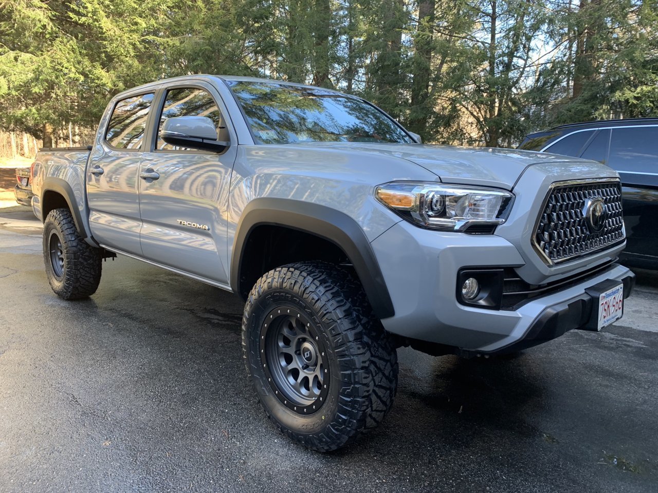

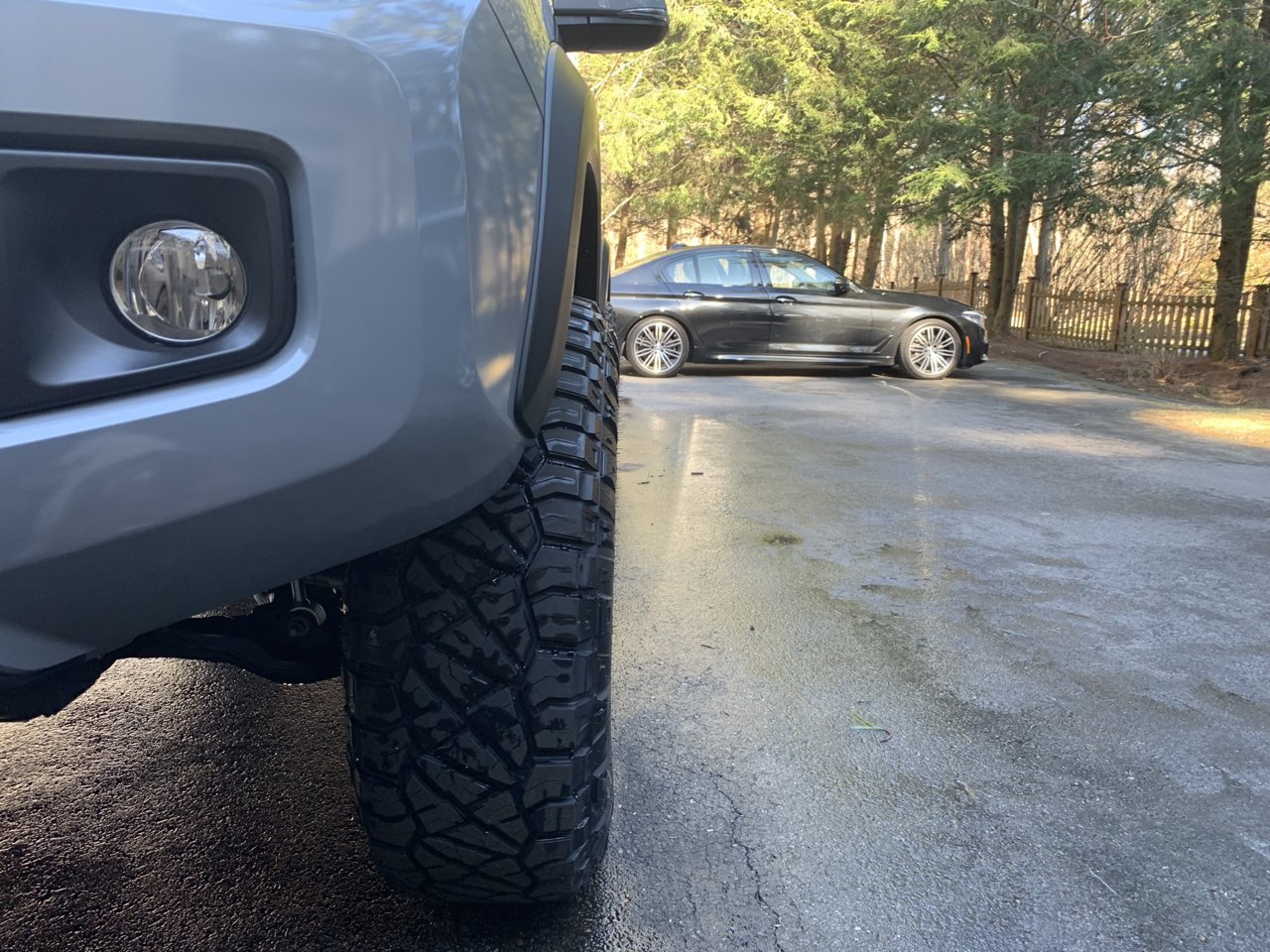

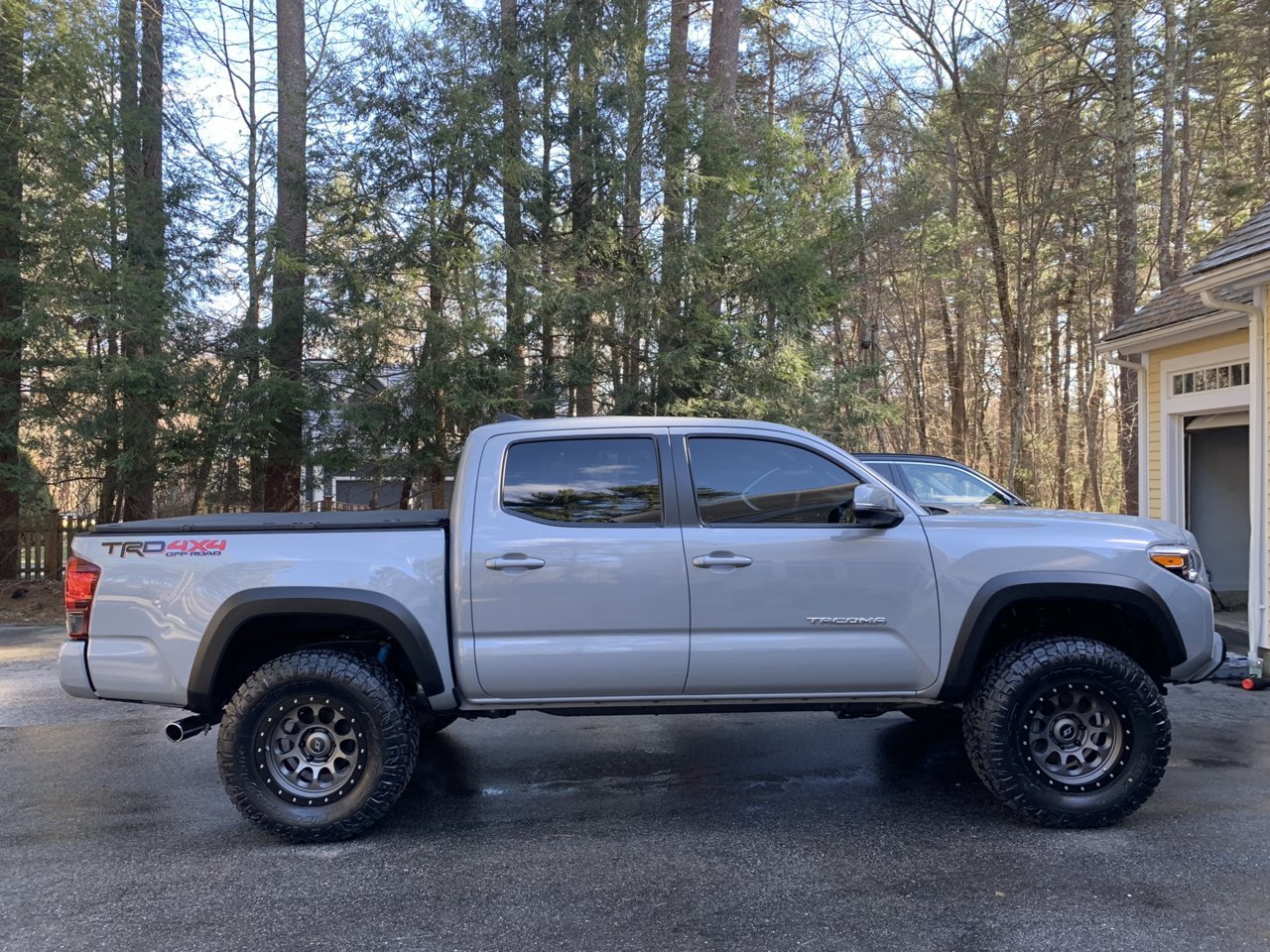

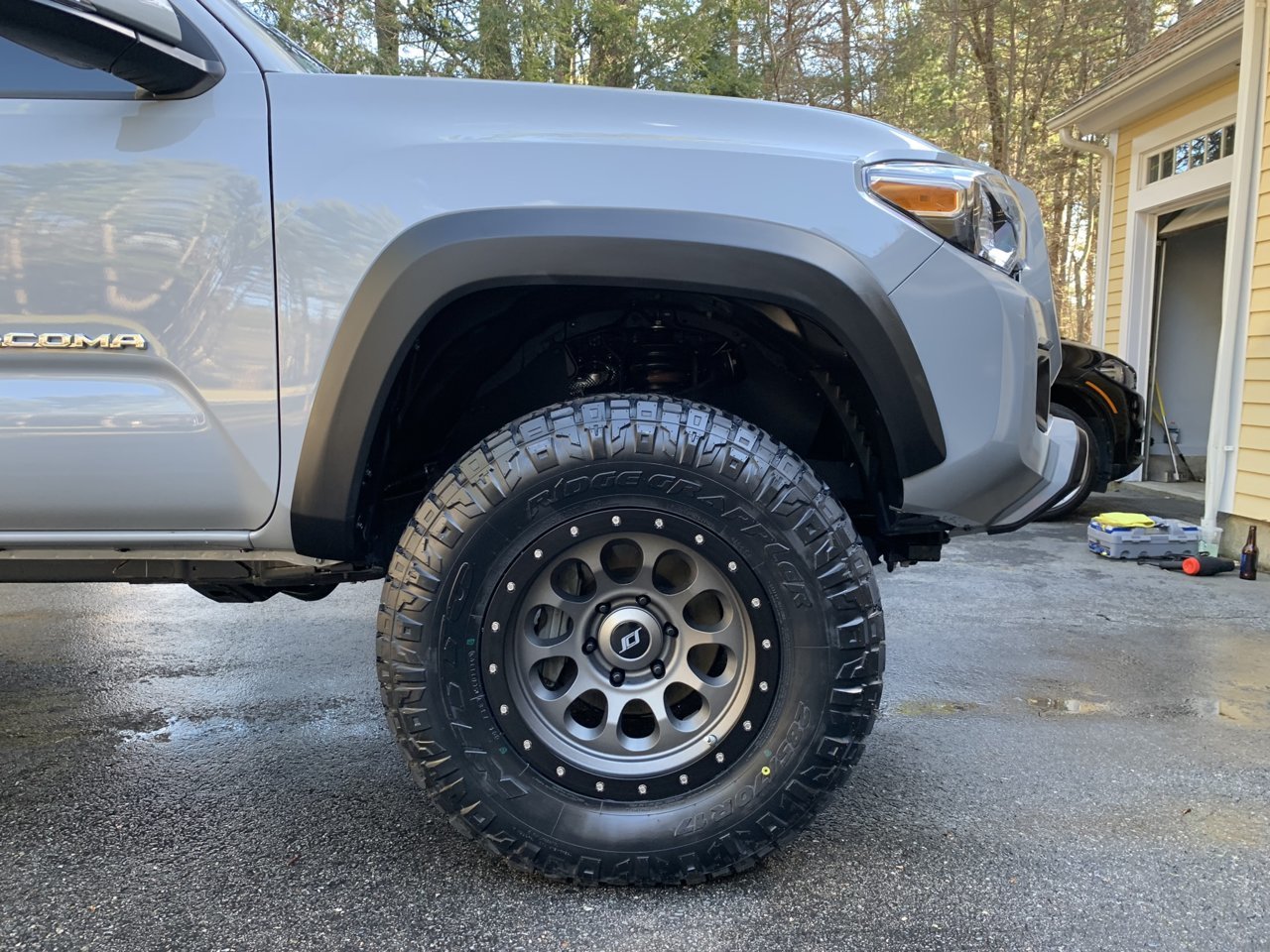

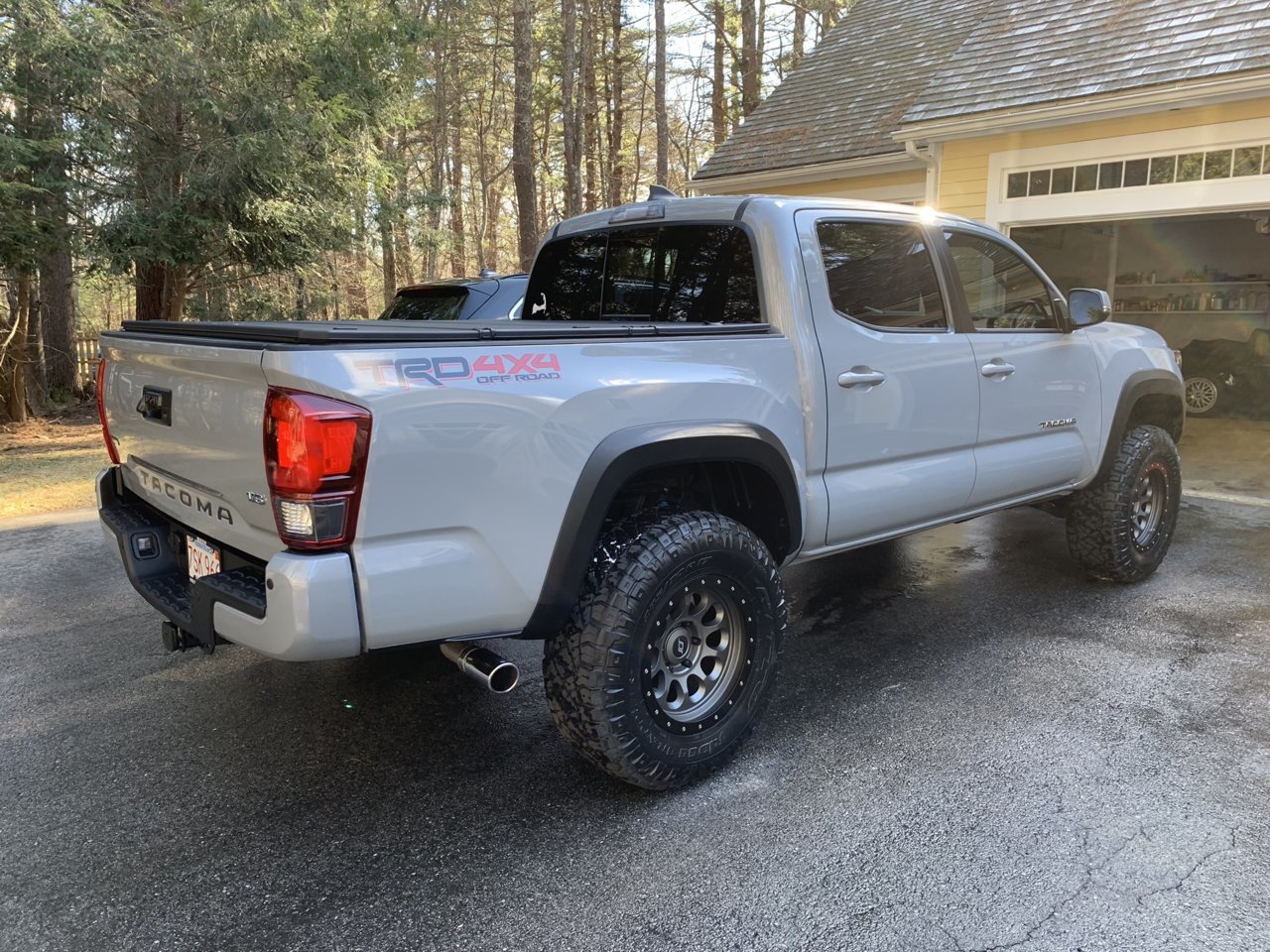

    As I searched this board many times, I figured I would give back and present the specifics of my Taco's mini-build. The board was very helpful in choosing my setup; I'm very happy with the end result:
    2018 Tacoma DCSB TRD-Off Road Cement/Black Leather
    PARTS LIST
    -Tires: Nitto Ridge Grappler 285/70/17 C Load Rating
    -Wheels: Stealth Custom Series (SCS) Ray 10 Matte Gunmetal 17x8.5 -10mm offset
    -Lugs: SCS Extended Thread Spline Lugs 24pcs. M12x1.5
    -Front Shocks: Bilstein B8 5100 Ride Height Adjustable Shocks set to 2"
    -Rear Suspension: WULF Suspension 1" rear lift kit blocks + U bolts
    LABOR LIST
    -Mount & Balance wheels and tires incl. 4 new OEM TPMS sensors
    -Install Bilstein 5100's
    -Perform laser vehicle alignment
    NOTES / THOUGHTS
    -Since I just recently purchased an Ingersoll Rand air wrench and was dying to use it, I installed the rear lift blocks. Took a few hours but if I had a post lift and did it again it would take an hour and change.
    -Living in Boston, not the suburbs, proved challenging to find a local shop to perform the labor. I called no less than 10 shops within an hour's distance. Many of them would either only do parts of the work, require me to purchase from them, or were booked a month out. I settled on East Side Motoring in Waltham, MA. They work on many high end vehicles like Ferrari's, Lamborghini's, etc but also do 4WD builds. They were very accommodating and booked a week out.
    -The cost of new TPMS sensors just about outweighs the cost of 'reconditioning' the factory ones. Not to mention the should did not have to dismount the factory wheels and tires.
    -Significant cutting (dremel) was involved to make sure the tires didn't rub. Note this had to be done in order for the truck to pretty much be drive, period. Don't fool yourself into thinking this setup is plug-and-play. I'll still need to chop more as it will run at full lock.
    -This truck is a 3rd vehicle and while I don't drive it daily, I plan on doing some light off-roading on the Cape Cod beaches.
    -Between the lift and larger wheel/tire size I added about 4+ inches to the height of the truck overall. Noticeably higher, like, much noticeably.
    -Debating whether to add a TRD Pro grille...
    -Best of all: This build was wife approved! She loves the setup and look and actually talked me out of the Matte Dark Bronze Ray 10's. Glad I went with the Matte Gunmetal.
    Happy to answer any questions - thanks TW for all the help in choosing this setup!

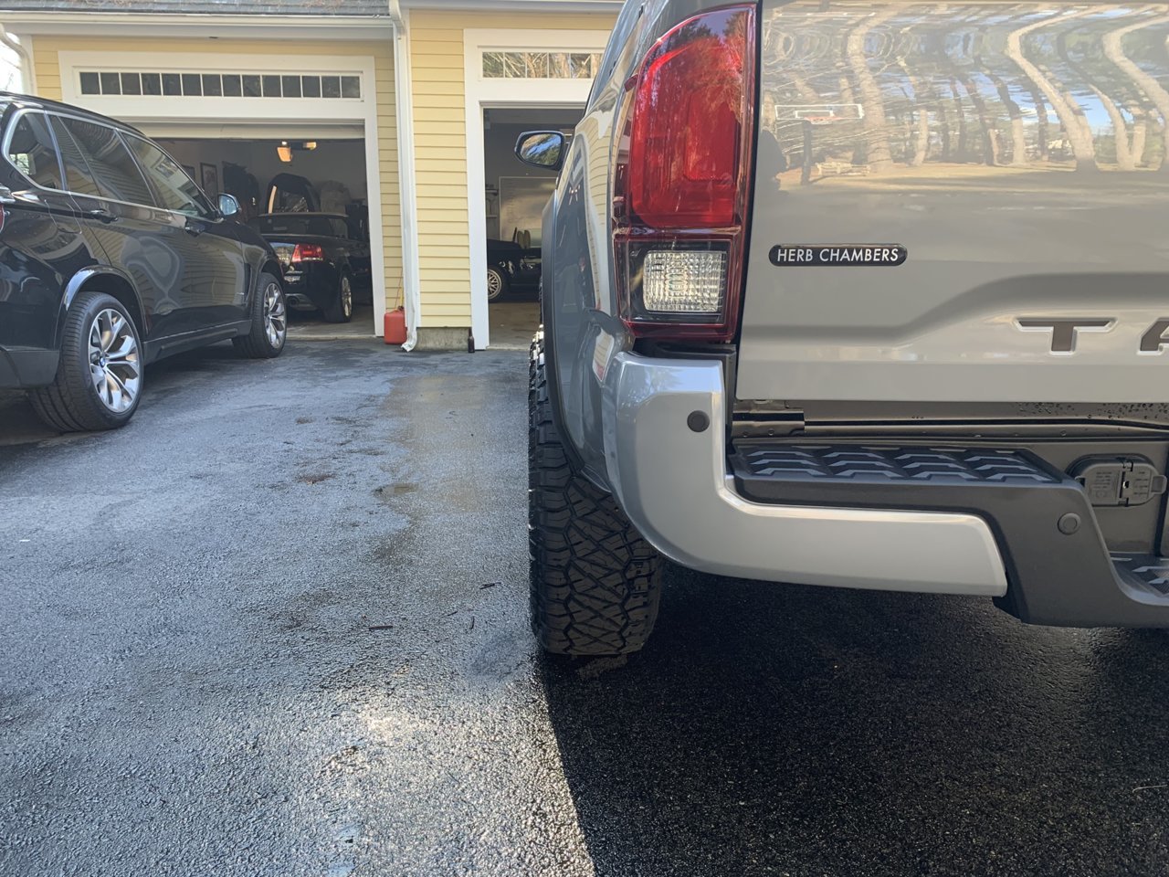

    Looks great ! Who is Herb Chambers?

    Good question. I’m not a pro but I did t lot of research. With the -10 offset on the Ray 10’s be mindful that they’ll stick out slightly. I was looking for a 275/70/17 but that was a tough size to find. My $.02 is that if you go with the 285 you’ll need to do some cutting but with that suspension setup probably not that much.

    Dealer here in Boston. Friend works there so I kept the sticker on - but now that I see it in photos I think I’ll remove it

    Stock UCA’s, yes. I feel the Ray 10 -10mm offset pushes the wheels and tires far enough away so it’s not an issue.
