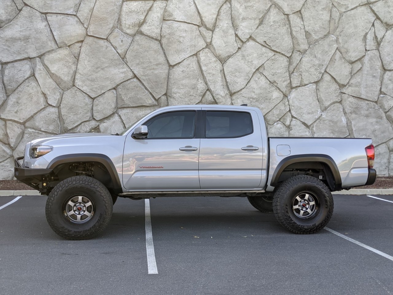

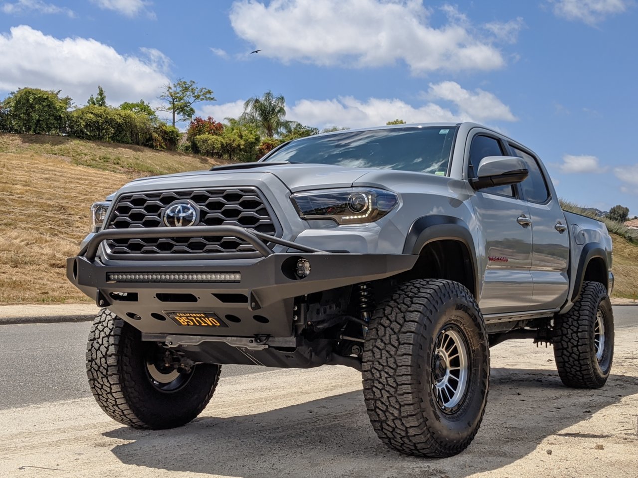

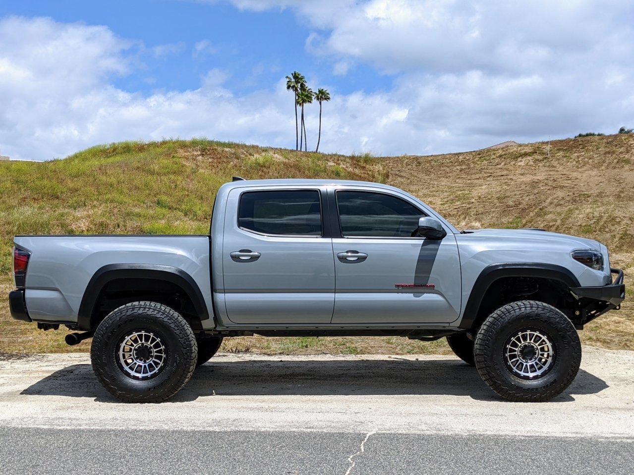

    April 2020, 35s get mounted up, here's the truck on the alignment rack. At this point, I brought the front up on the second 5100 notch which put the front lift around 5" and I added another .5" out back for 3.5" rear. Also, I found a good deal on the 2020 grille which I really like and mounted it as well.

    The 35s didn't clear well at all. April 2020, This forced a CMC and aggressive trimming. Now the 35s fully clear and I haven't rubbed on or off road since.

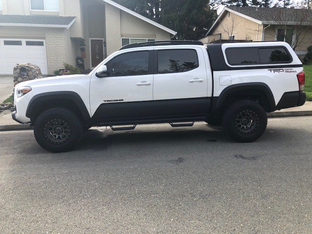

    2016 Super White DCSB
    Truck New.jpg The truck looks great I like what you have done! I am also a RWD owner, great thread.

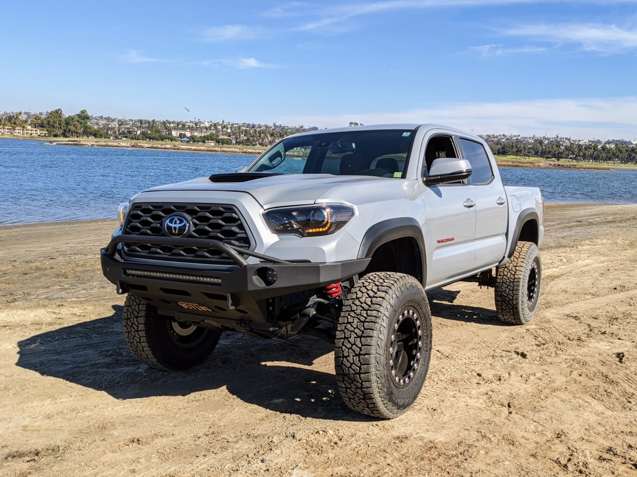

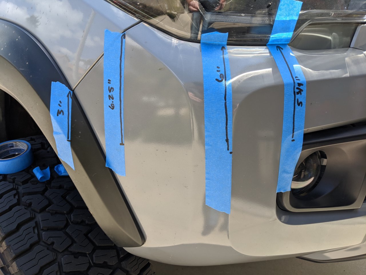

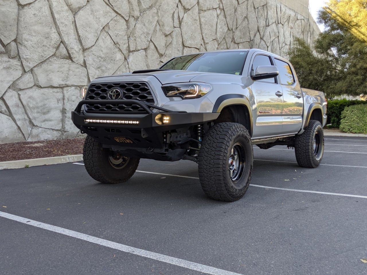

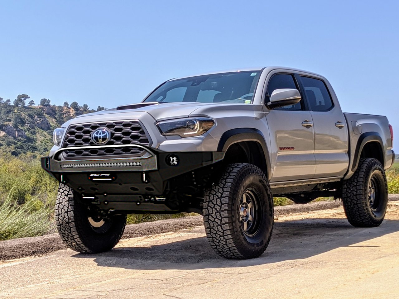

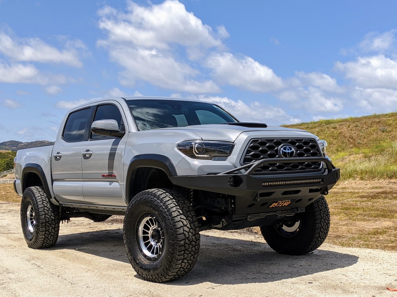

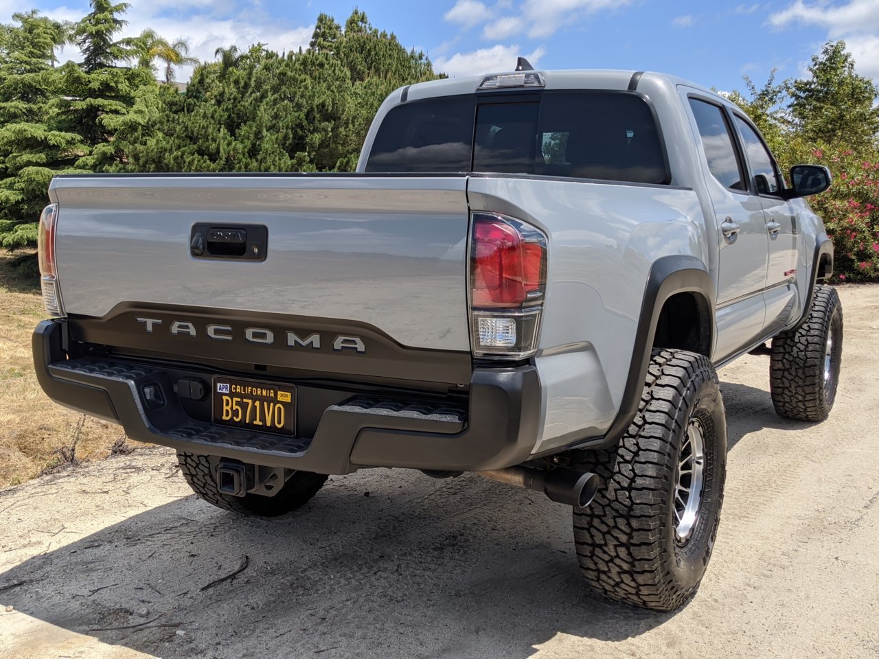

    Demello Front bumper install complete.

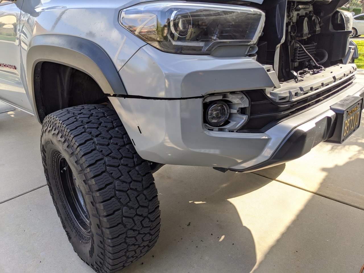

    For outfitting this thing with lighting, I opted for the $265 Baja Squadron SAE driving lights (Street legal) and the $179 Rough Country 30" Black Edition Light Bar. Not a bad score. I did order a light bar switch for the dash, but the Rough Country has a 3-position switch for marker LEDs/OFF/ON. Both kits come with tons of wiring to install. The Rough Country kit had relays, fuses and nylon wrapped cable and waterproof connectors.
    Ok, first step and the most unnerving, cutting the stock bumper. No going back. I went to harbor freight and picked up the small angle grinder that can take the thin 3" discs. I felt the 4" was too big and a dremel too small. I did use Demello's measurements and they turned out very well.
    J&ATacoma likes this.
  6. May 31, 2020 at 8:23 AM
    #66
    dal3_gribble
    dal3_gribble [OP] Well-Known Member
    Apr 14, 2018
    #250494
    1,202
    Crew Cab SB TRD Offroad
    Final result.
    Now I'm not a big flashy off-road light guy. I like good headlights and good driving lights. However, I gotta admit, the light bar is actually pretty cool. I love how the lightbar has a low output driver light setting. It kind of brought out the 16 year old kid in me with my first F150 that I probably put like 10 KC lights on haha.

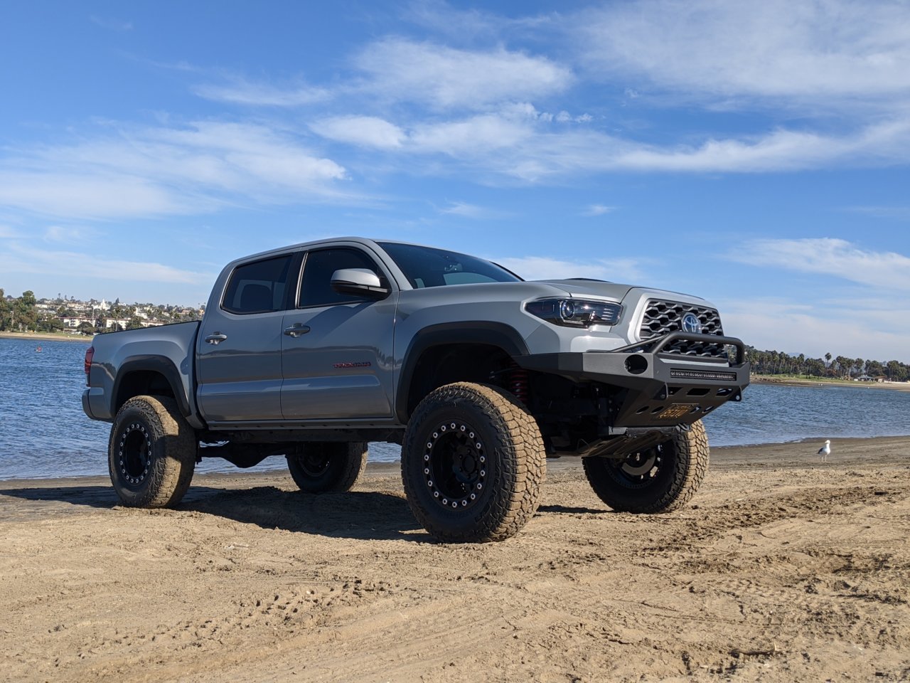

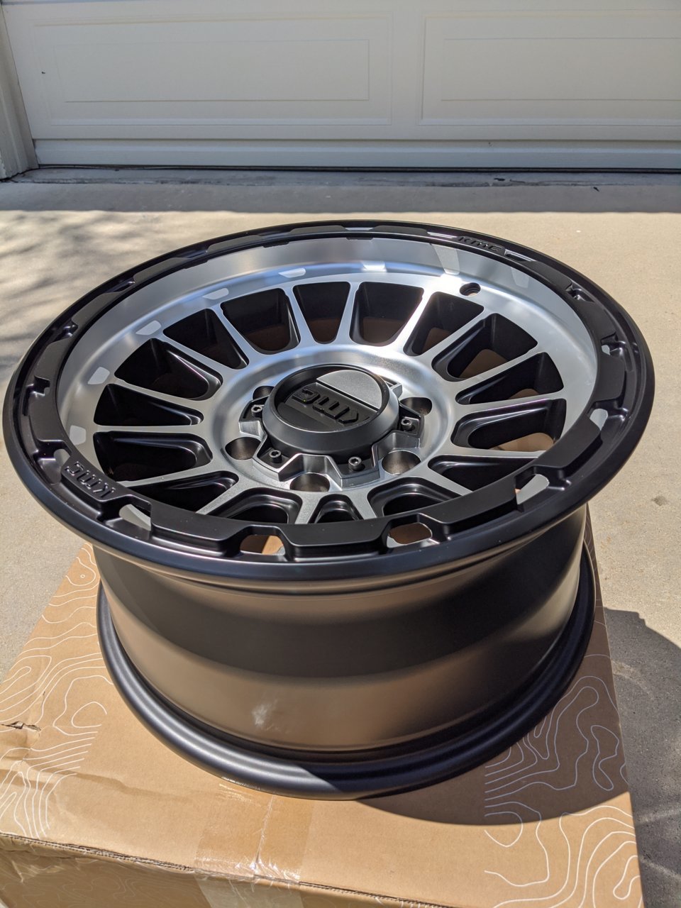

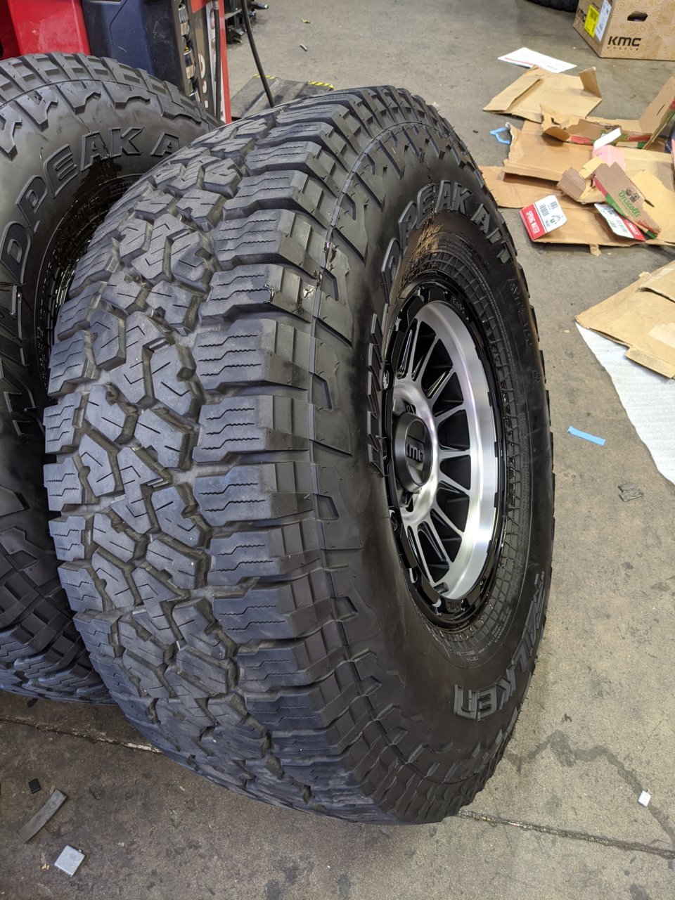

    I wanted to go with a higher contrast wheel to the grey/black. I went with the KMC impacts.
    Got these mounted today and I haven't seen them anywhere here on TW. They're one of KMC's newer designs, I think they've been out for a few months. 16x8 0 offset, machine faced face with black lip ring which is cool and I like how it's a modern design without faux beadlock bolts and bolts everywhere. These are going to be such a PITA to clean but I digress.
    [​IMG] [​IMG]
    MOUNTED

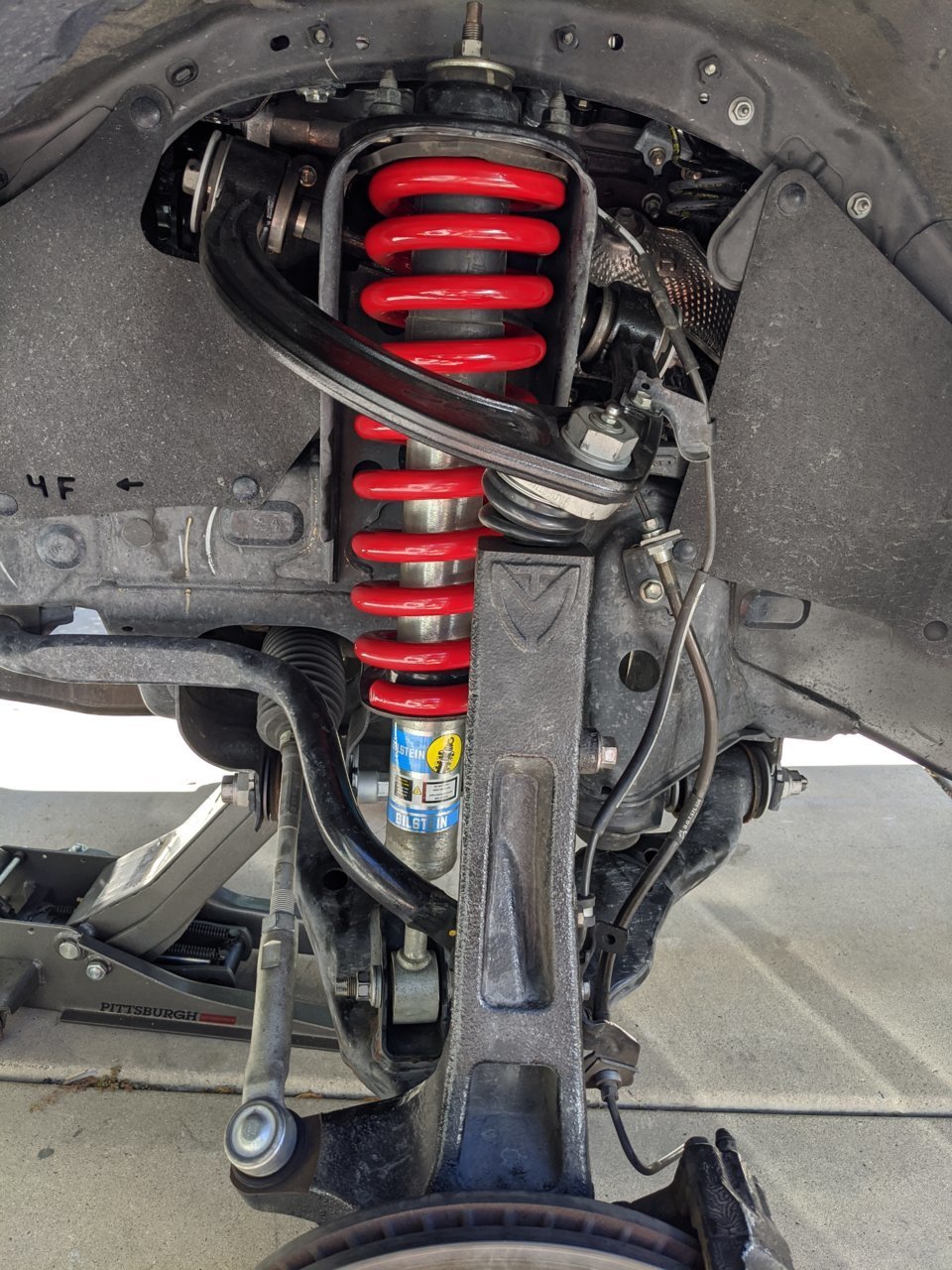

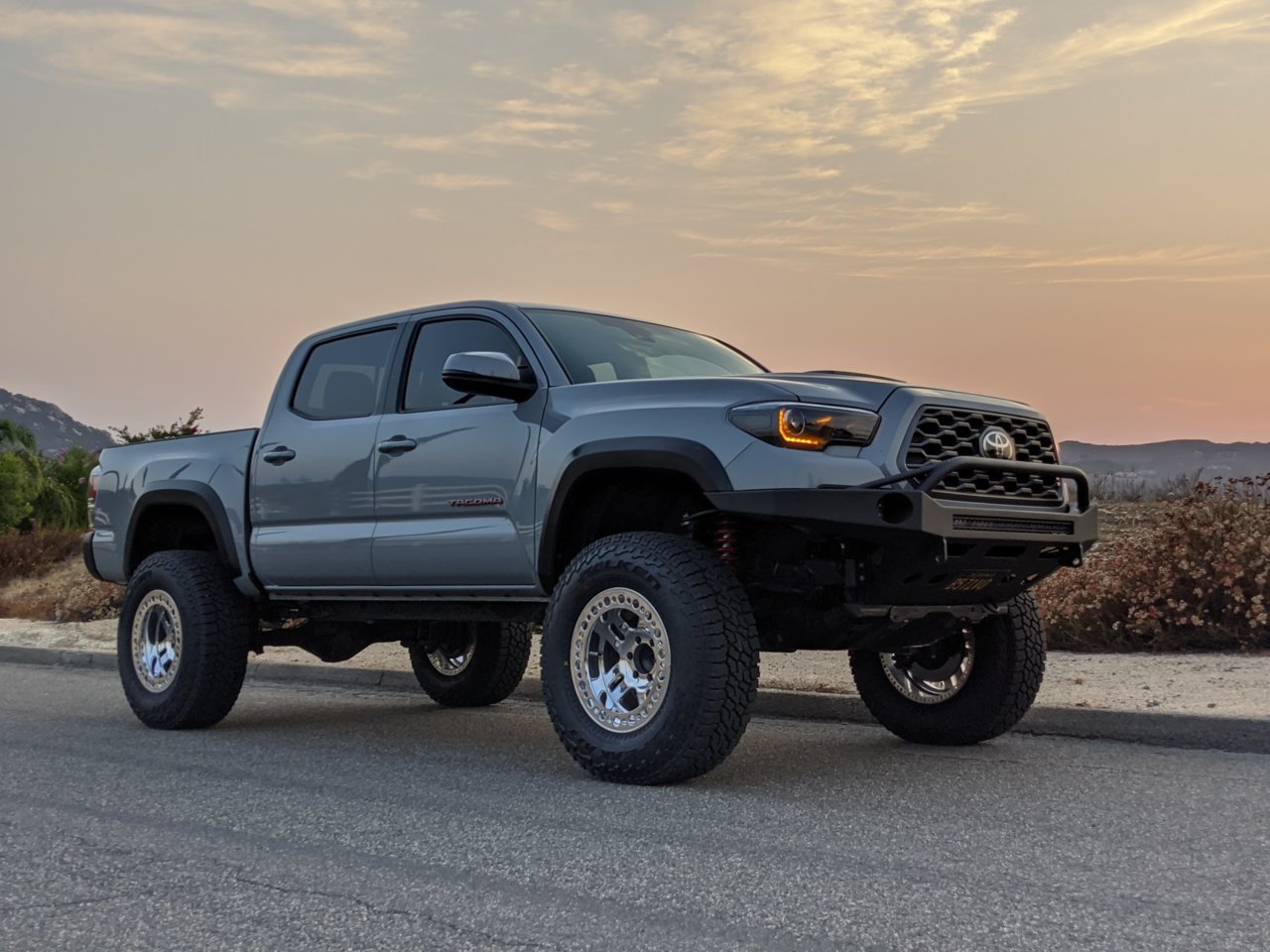

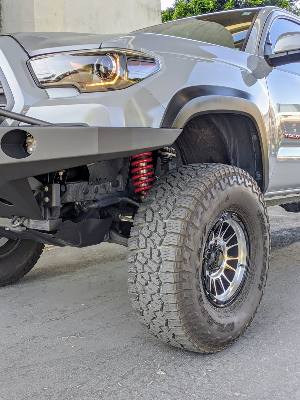

    Couple more updates. I got a set of free TRD OR springs from a local member and had them powdercoated red. The high clearance front bumper really allows a lot of spring to show so I took advantage of it. I also put the SPC UCAs on to get the alignment dialed.

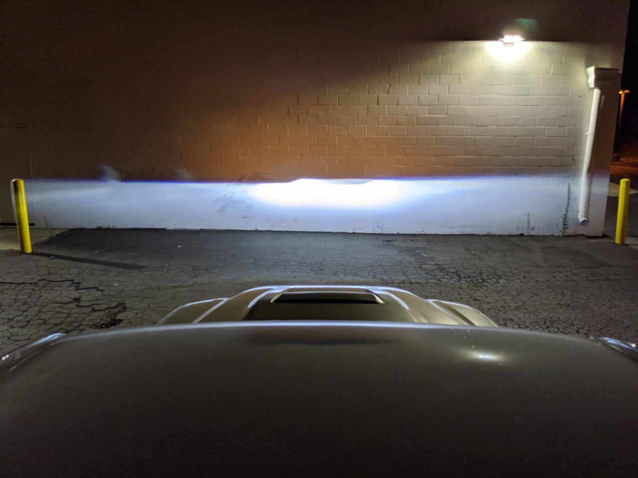

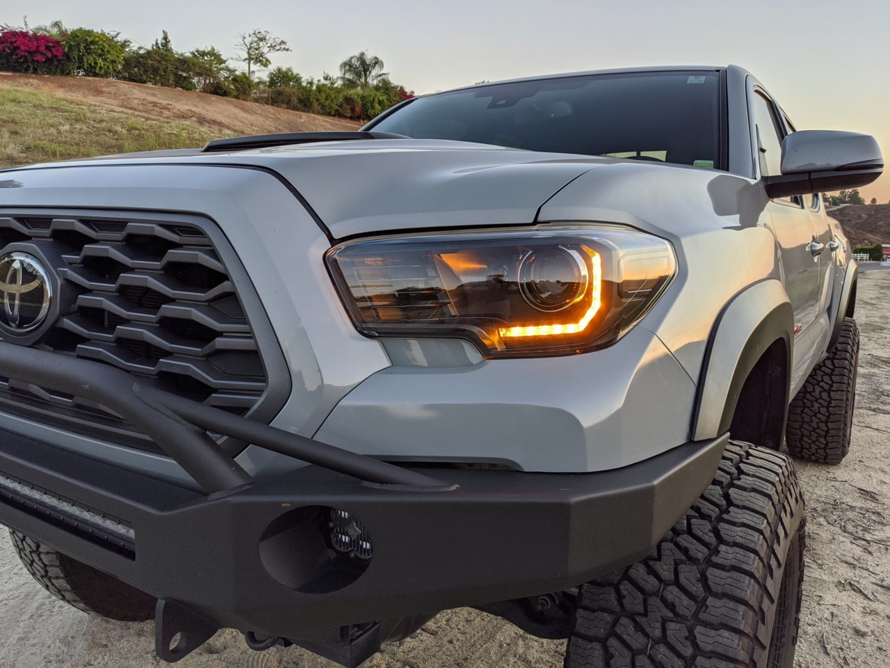

    I reopened the headlights up again and retrofit Morimoto MLED 2.0 Bi-LED projectors and Diode Dynamics DRLs.

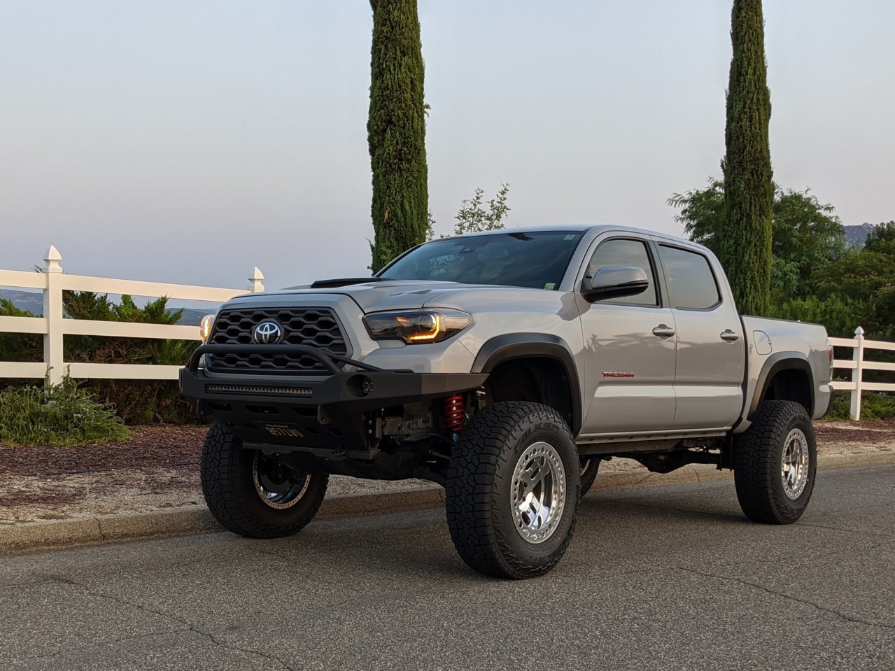

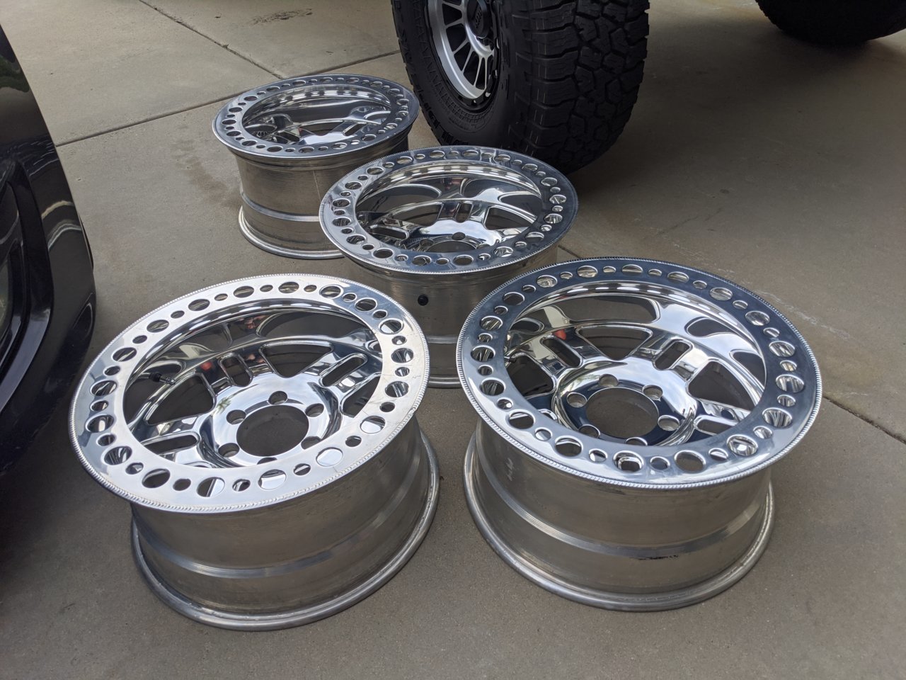

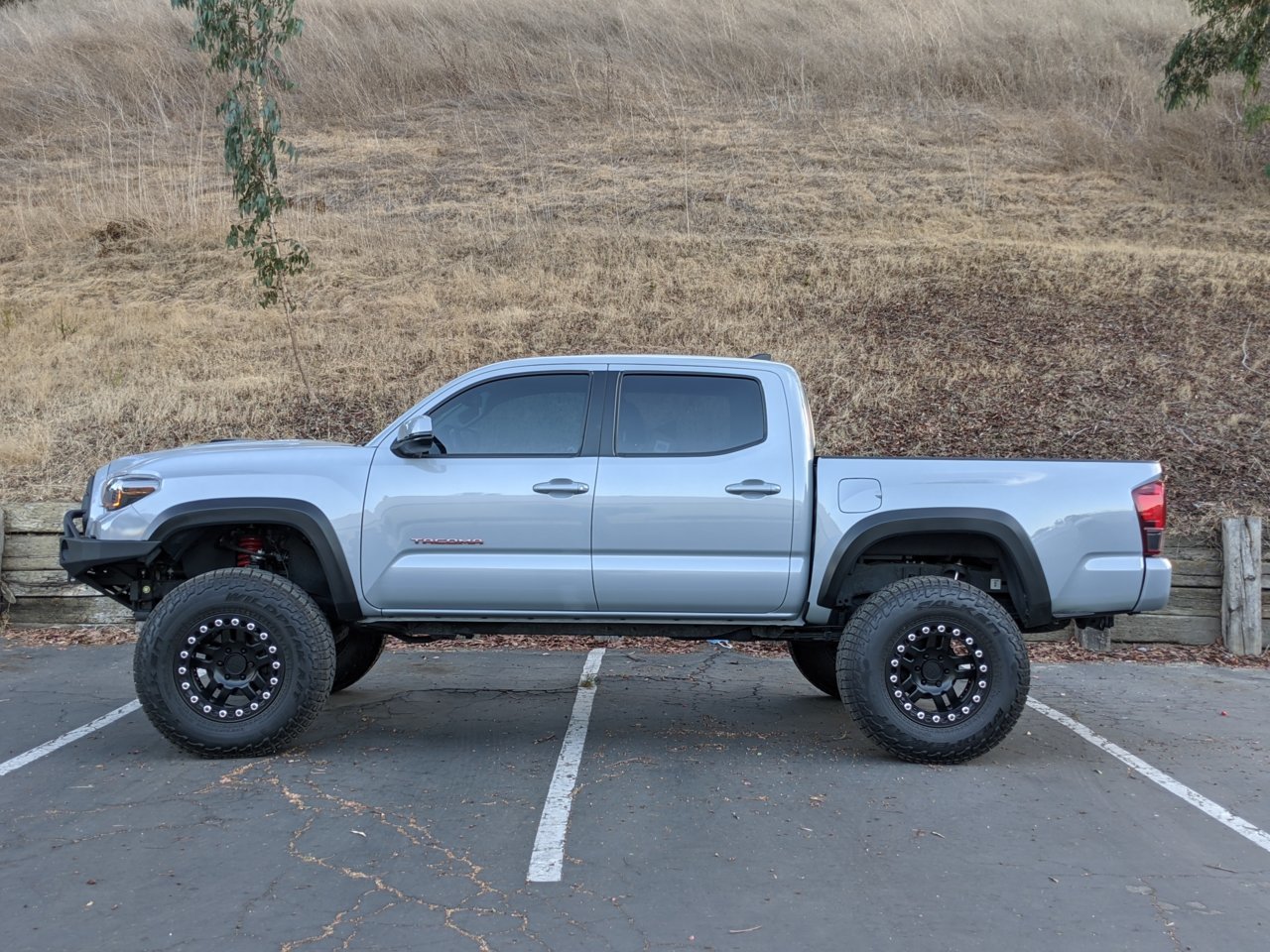

    I got my hand on these 2003 Billet KMC wheels on Craigslist for $300! They were from a show truck back in the day and never on the road. They also have OMF welded synth-locks aka wheel stiffeners custom welded on. Truly one of a kind. I wrapped Falken Wildpeak A/T3w 285x75r18 (35x11.5) around them.

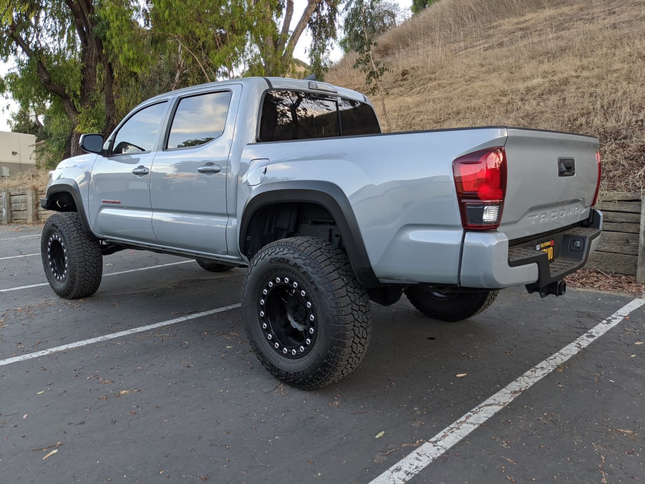

    Had Billet wheels powdercoated black.

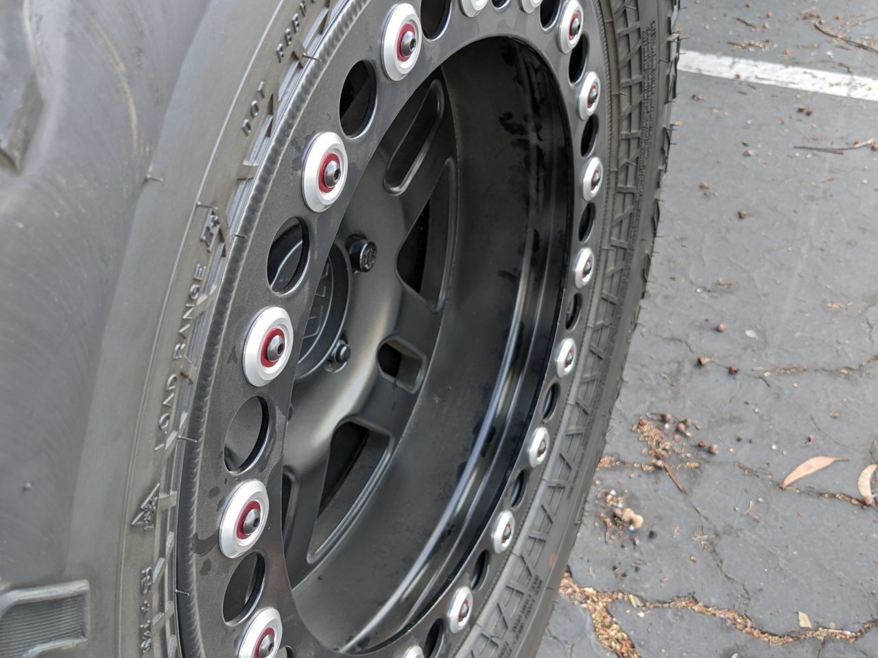

    I played around with hardware for the simulocks. These legit look like beadlocks now.
