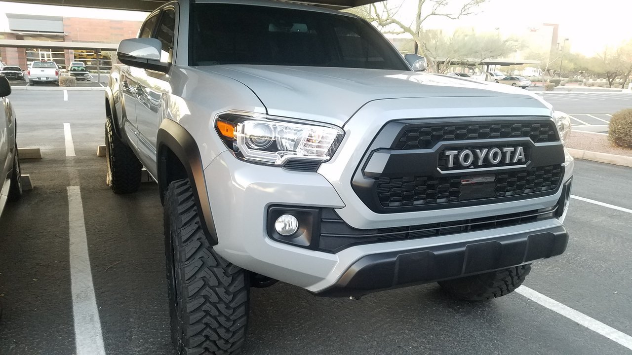

    Mine is just the regular OEM Pro grille. They aren't necessarily year specific because they all have the removable piece in the lower middle. You just need to buy the "radiator garnish" as they call it.

    If you have a 17, you don’t need the shiny piece. It’s for 18’s that have safety sense, it helps the sensor behind it function.

    As of now, you'll have to use the radiator garnish for the Pro grille if you want the adaptive radar cruise control to work correctly. I wasn't too thrilled about how it looked when I first saw it on a 2018 TRD Pro, but it doesn't bother me anymore. Even with the radiator garnish, it still looks better than the stock OR grille IMO and it's much better than having my dash light up with error messages.

    Welcome to TW @poketako! That sucks that your dealership wont help you with switching your grille out. It's really not a big deal to do. To answer your questions:
    1) No, I didn't have to have my sensors re-calibrated. My radar sensor works fine and haven't had any issues at all.
    2) It's pretty simple to remove the factory grille and replace it with the Pro grille. You will have to disconnect the radar sensor and then remove it from the grille once you have the assembly out. I think it's only like 3, maybe 4, screws for the sensor. Just make sure you disconnect the wiring first. On the Pro grille, you'll need to remove the bottom middle piece and get an extra piece they call a "radiator garnish" (Part# 53141-35060) for the adaptive radar sensor. Here's a video on how to remove the grille.

    It seems to be hit or miss on going without the shiny piece. I’ve read on here both, working with and without. You can always go without and see if it works to your satisfaction. If it doesn’t, just order the piece.

    Yes you can but the garnish protects the sensor. Put a rock through the radar sensor and you will be taking out a loan to replace it.
