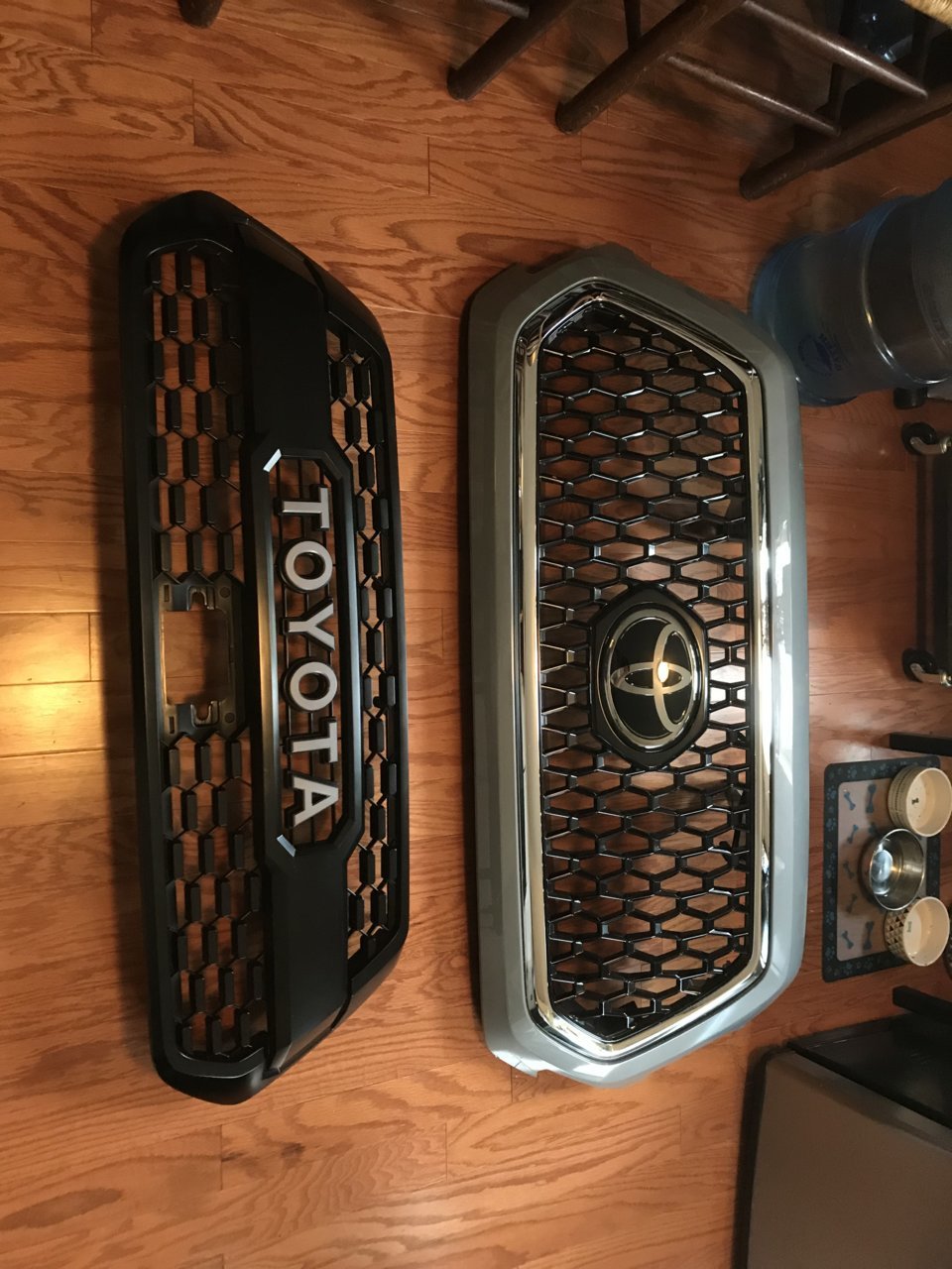

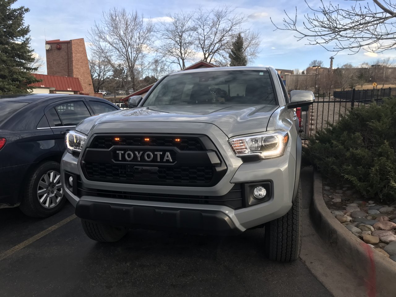

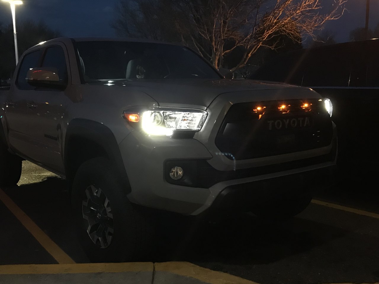

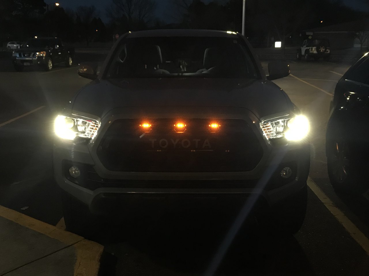

    Took some patience, but Toyotaparts4u.com came through with a 2018 pro grill. I saw a few posts of people who had poor interactions with Barbara from TP4U but she was great about communicating with me and why it was taking so long. She told me that 8 people were on the waiting list and Toyota was requesting VINs for each of them. She collected the needed VINs and once they were approved, the grill was sent out, along with the garnish. Considering the cost of what I paid, and the struggles people are having getting one, I’m happy I waited it out. I was super close to canceling the order and buying a Chinese replica...
    Install was super straight forward. Only broke 1 tab on the old grill...to install the TSS sensor, remove the bolts from the old grill, reuse the silver nuts that mount the sensor to the grill, and use some speed washers to secure the plastic tabs on the garnish to the grill. The old harness works fine, but you can’t connect all the harness tabs to the new grill without running out of length.
    Haven’t had any problems with the sensor. Also, I installed the TacomaPros raptor lights. Hope this helps! C5CF2658-9A7E-44F1-B6F3-D783DAAD0C00.jpg
