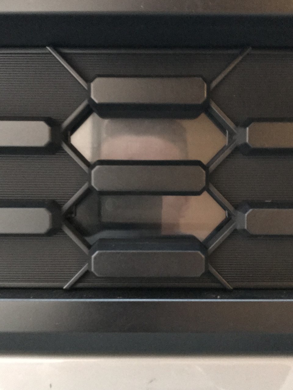

    07F86B1D-55AB-4151-A019-3B12F33881DB.jpg put the plexi on the inside

    how did you put the plexi on the inside? 3 m tape?

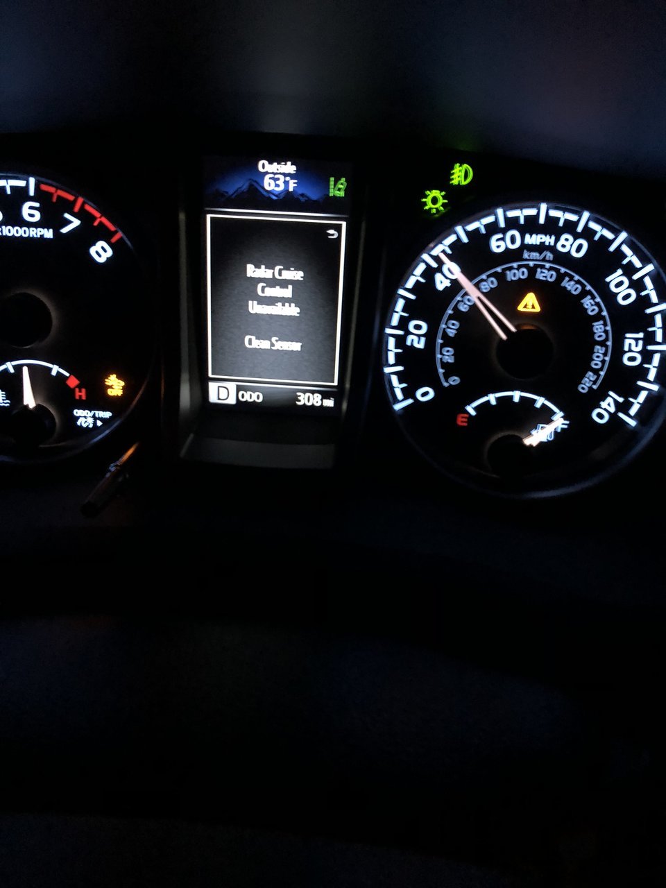

    whats that off light for by the odo button?

    It's the ACC/FCW light. Pretty much any system where that radar plays a role.

    The reason Toyota puts the plexi on the outside of the grille is so snow/dirt/grime don't get packed into those spots while your driving and block the radar. It does look way better the way you have it rigged though.

    You can mount the sensor no problem but for my issue the sensor is seing something, as of now imma put my oem to see if the sensor will still play right way.

    Nope the sensor is clean, the issue is when i mount it on pro grill, i will find out later coz i just put back the oem grill, oh FYI for anyone will try to removed the trd pro grill ; good luck its hard to removed it bacause theres 2 tabs on upper left and right are bigger the holes itself , its design to hold the grill secure

    I would think it was said Plexiglass. Those sensors are sensitive. Did you put a piece of Plexiglass between the sensor and the grille? or just mount it directly?
