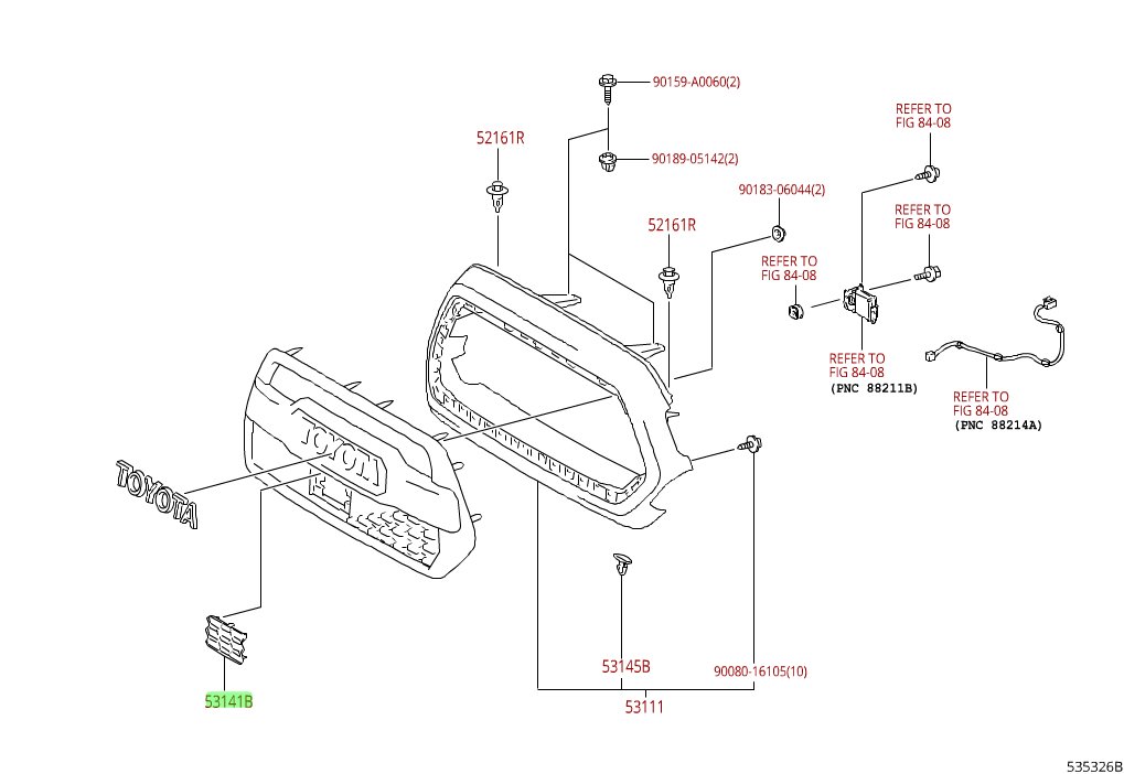

    I used same OEM grille for my 18 that has been being used for the 16's and 17's. But, for the 18's you will need to order one additional part. You will need the garnish that goes in the bottom of the grille in order for the TSS to work. The part number is 53141-35060 (pictured in a previous post). This part can be ordered at partsfactory.camelbacktoyota.com for $50.03 plus tax and shipping.
    You will also need to have some calibrations done to make sure that it is working properly and within specs as Ruggybuggy pointed out above. The dealership I worked with installed the new grille and calibrated within about an hour. I do not know how much the calibration will cost. Keep in mind, as Ruggybuggy pointed out above, the TSS may work after installing the new grille, but may not be working correctly. For example, the lane departure may not indicate that you are veering out of your lane until you well into the other lane.
    As for the Chinese grille, I do not have any answers as I bought the OEM. It appears there may be several different versions of the Chinese grille out there. I would think, though, that as long as it has the removable section at the bottom that is able to accept the garnish, it should work.
    I can confirm that installing the grille and moving the TSS to the location at the bottom of the grille without using the optional garnish will not work. While it may initially appear to be working, you will soon find that it is not working correctly and will probably get error messages on the screen and warning lights letting you know.
    If anyone has any questions, let me know.

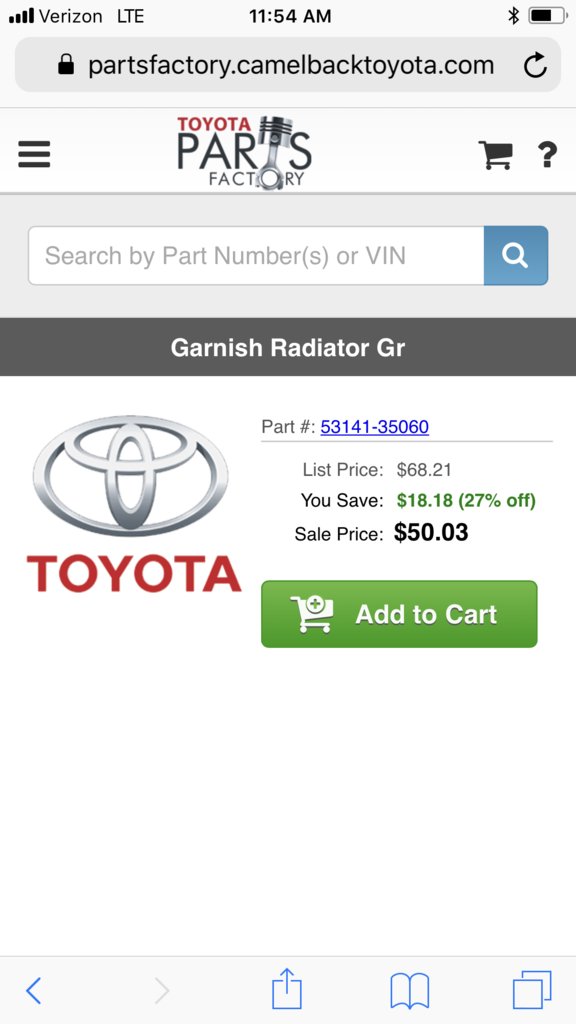

    Also, the list price for the garnish is $68.21. Toyota is apparently really proud of this part, and recommends the dealer charge $86.12. If you are going to buy the part at your local dealer, I would not pay more than $68.21 (full list). Or, you can simply order on line and save yourself some money while supporting a dealership that is not trying to rip you off. $86.12 for this shitty little piece of plastic is crazy.
