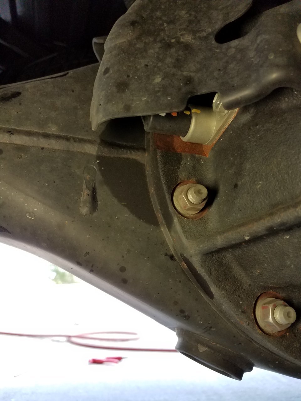

    Alright guys... Would you take your ride in for this? What will they do? Is there a tsb someone can post? 2018 TRD OR 4,800 miles.

    I would. It's not dripping, but you'll at least want it documented. I imagine it'll get worse. I remember this was an issue with 16's and some 17's but thought this was cleared up by the 18s. I believe they replaced the seals.
    Where was your truck built?

    There was a recall for earlier years. Something about the bolts not torqued to spec. I'm not sure why your even asking the question if you should take it back. That is a critical malfunction in the manufacturing process that if left could result in catastrophic failure. TAKE IT BACK IMMEDIATELY

    Agreed... take it in... thats the look of a high mileage diff, and its supposed to be new.
    Make em fix it.

    I was told by a Toyota dealer's service dept. that ... once the truck is brought in for a rear diff seal leak ... they have to keep it until it is fixed for safety reasons.
    They were keeping some trucks a long time due to the lack of diff seals in the system.
    Dealer said ... they give out free rentals for those problems.
    Checked my diff and it was OK.

    Seems like barely a seep. I'd let it go rather than have some dealer messing with my dif.

    Eh with only 5k its bound to get worst. I had a seep from my rear main seal and didn't find it and have it addressed until 70k miles, cost $1200 to replace. Worth documenting and having it fixed now rather than down the road.

    Mine looked like that at 5K too, and then it dried up and went away, I think some of it is just some grease from assembly.

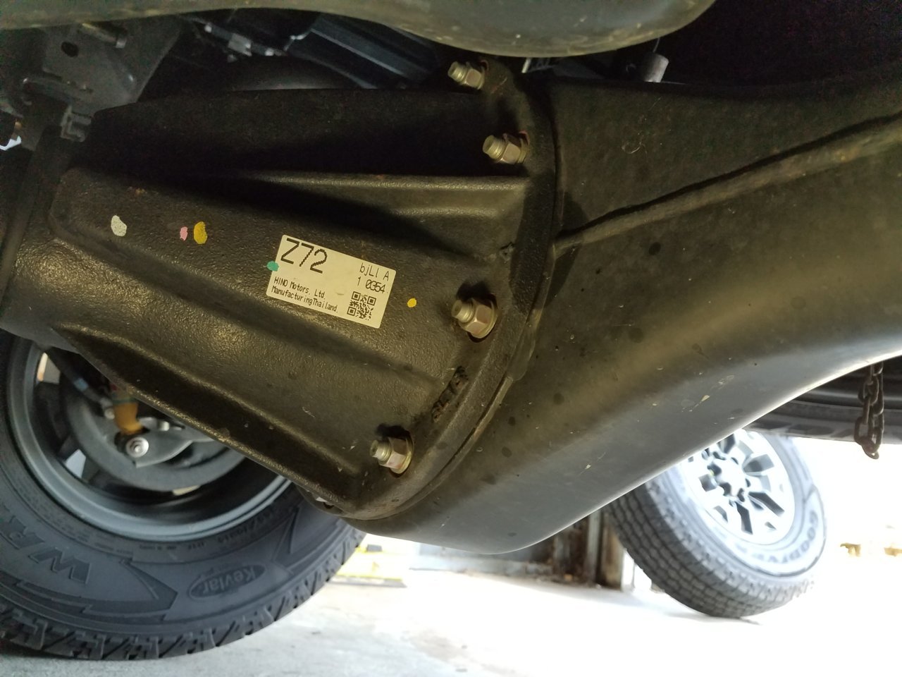

    I took these pics at 5k, that stuff wore off and it's still totally dry today with 20k.

    Mine look like yours OP, but unlike @shakerhood mine got worse. They kept the truck 38 days waiting on parts. Gave me a loaner Nissan frontier from enterprise rent a car. Fix was new third member housing, gasket/rtv, oil, and rear brake assmbly.

    Just brought mine in with 6k looked the same... they said it was from manufacture and tightened the bolts...

    I would retorque the bolts and add 5 ft/lbs and clean it up with brake clean and see if it comes back. If it leaks again, then you know you have a real issue. Why waste your time if there is no need to.
