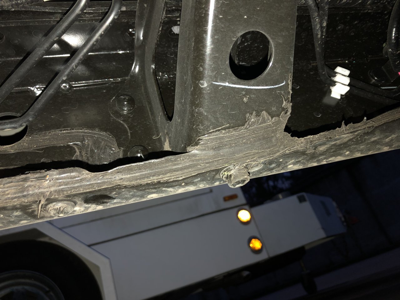

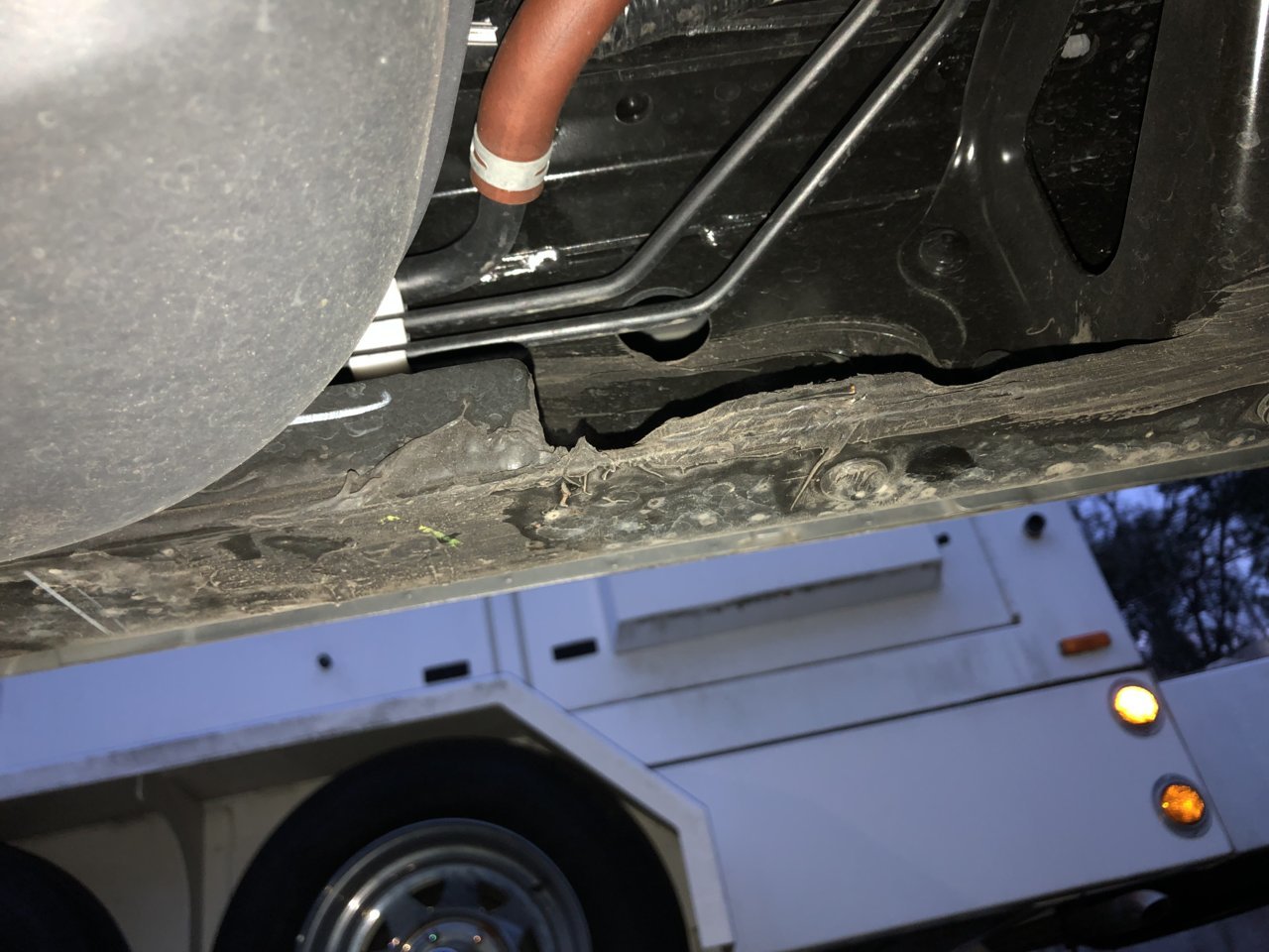

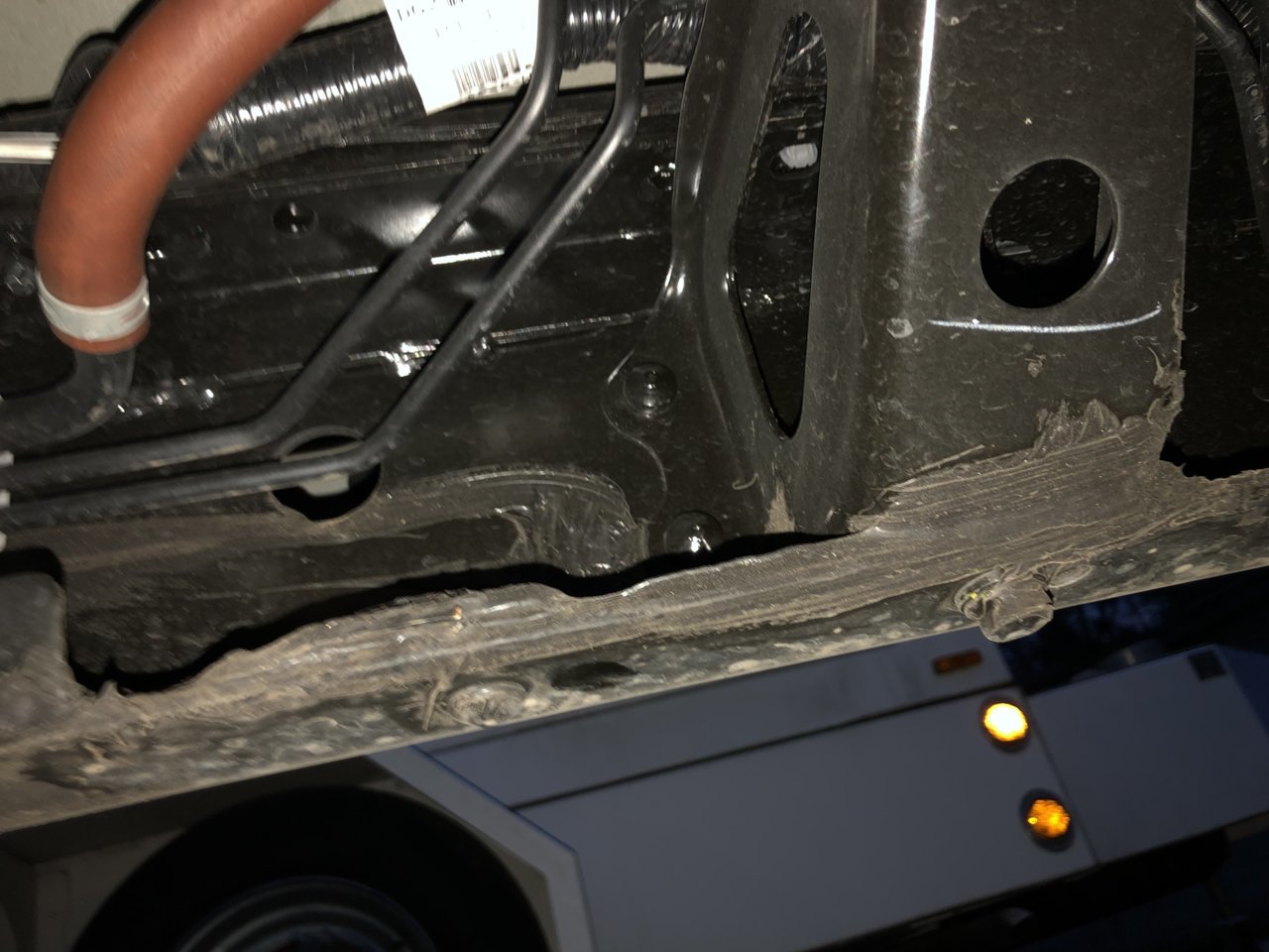

    While we are on the conversation of my truck what’s all this crap on my frame? Saw it while looking at the diff.

    Seam-sealant. All good.

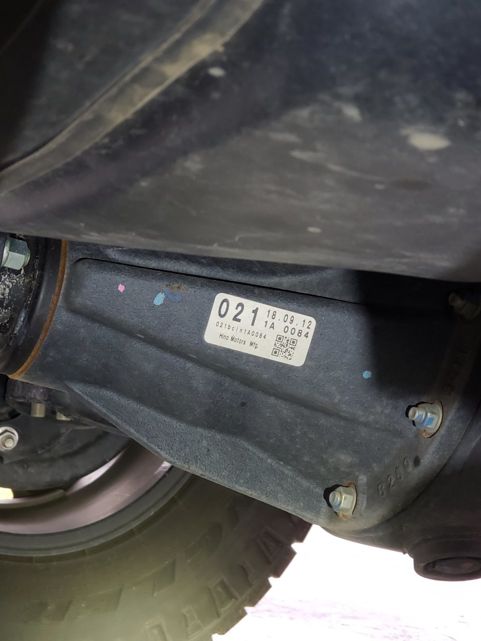

    It was seeping through pretty badly

    Yea HINO makes a bunch of Tundra and Sequoia parts. I believe the manufacture the entire rear Tundra axle.

    The number of chicken littles this site attracts is phenomenal. I have 2018, same small weep spots after a couple thousand miles. Mentioned it to the dealer at my check up, they retorqued the bolts and cleaned of the diff. 6000 miles later and no signs of seeps, even after I did the breather mod.
    At your next check up, make note of it to the dealer. They will likely do the same thing they did to mine. No need to rush to the dealer or make a separate trip unless diff fluid is leaking on the ground. If the spots are diff fluid, the amount that has seeped out is insignificant. The issues for the 2016/2017 models consisted of significant amounts of diff fluid leaking out, which eventually led to the diff seizing up.

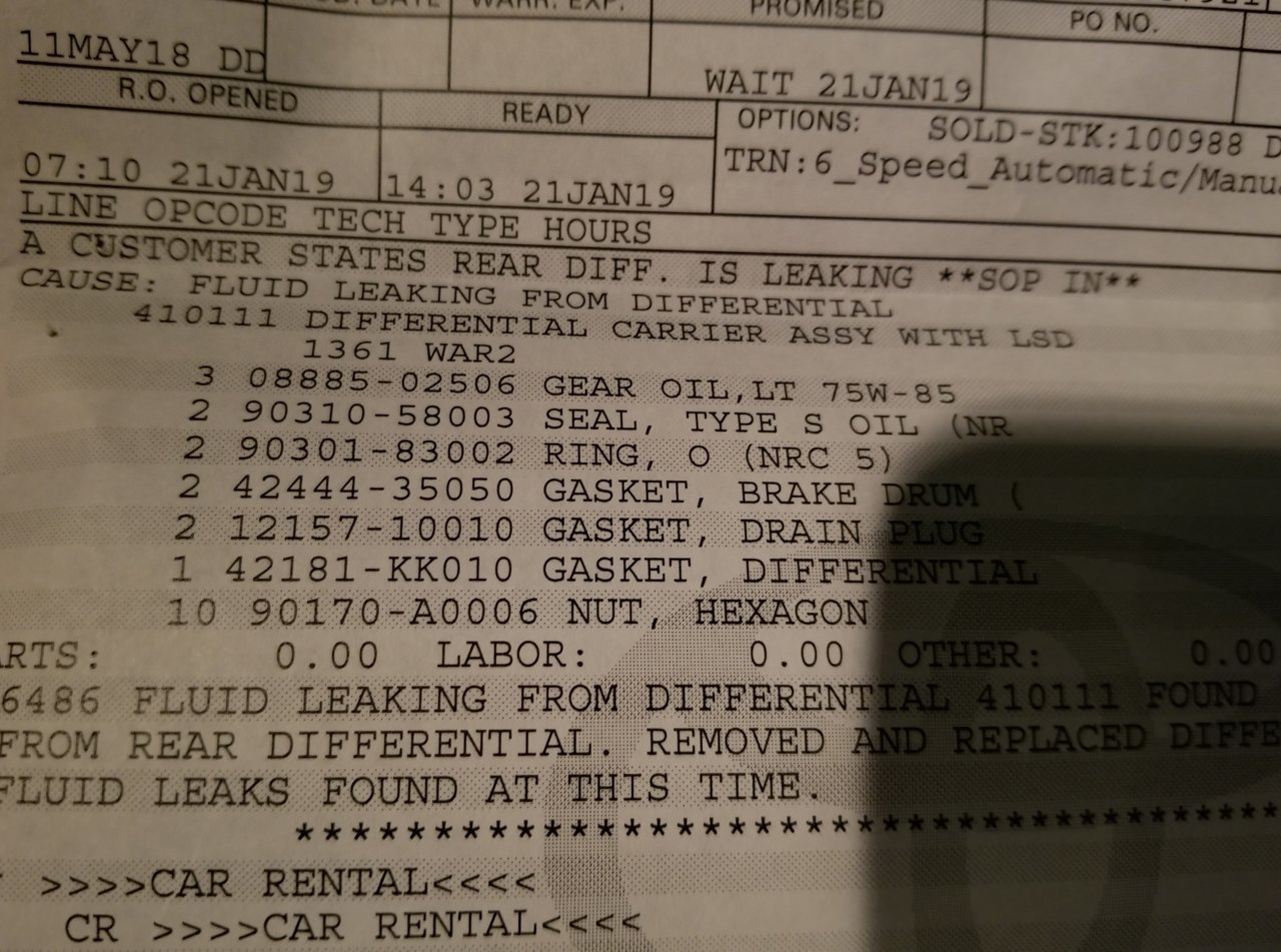

    Pulled up as the service department was opening this morning. The tech leaned over and looked it it. We walked inside. Sent me over and I got a 2019 Camry loaner. They are replacing the gasket and nuts per the safety recall H0G. Pretty easy experience thursfar.

    Checked my diff and looks just like the OP's except not as 'wet'. Made in Thailand. Will mention it to the dealer at my 10K service. Good catch, thanks all!

    Just got my truck back. That was quick. New gasket, new bots, new fluids, and cleaned my diff off.
