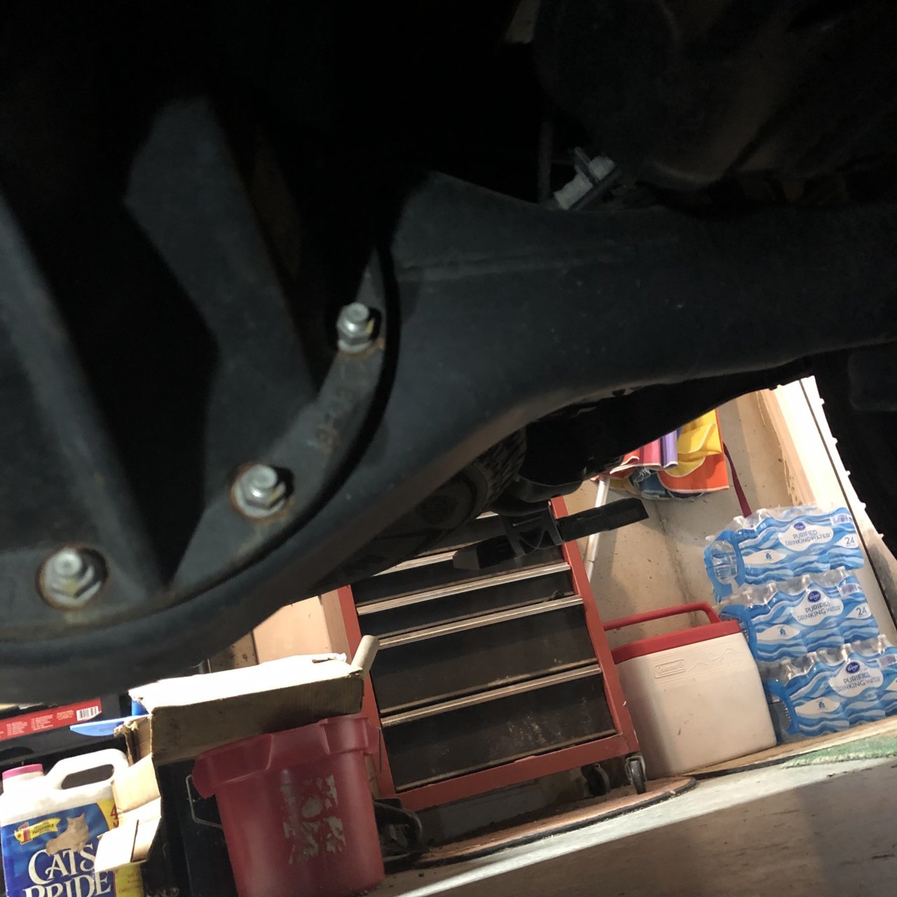

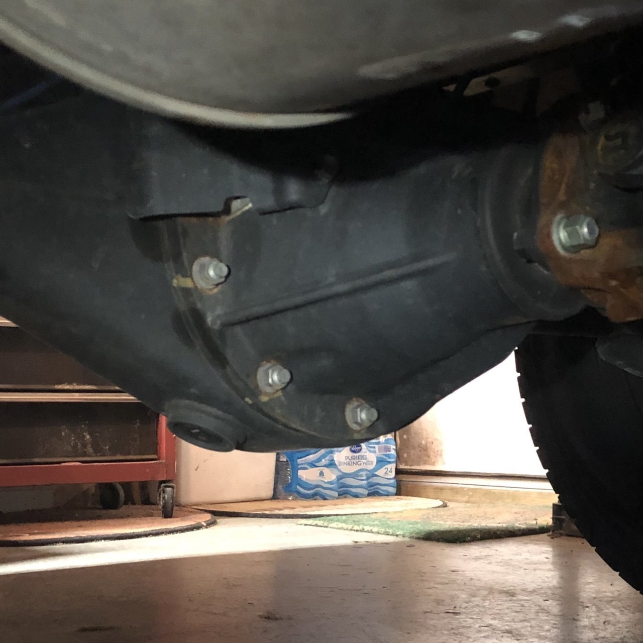

    I’m on a 1000 mile round trip vacation to North Carolina. Like an idiot I looked under my truck at a rest stop, noticed this. I can’t recall if it was ever there. I touched and it doesn’t feel wet, but greasy and leaves black residue on my finger. Is my diff gonna grenade on the way home? 21,000 miles.

    if people would read The Forum, I posted that mine looked like this I sprayed cleaner on it and it has not look like that again I believe it is something from the factory like grease that just tends to get warm and look like the differential is leaking

    21,000 miles, still factory grease?

    :goingcrazy: That’s pretty bad, I’d say it’s CATASTROPHIC!!

    BOOOOOM. No, but seriously?

    If your differential is leaking it would look wet, plus it would be covered under warranty in the event it grenaded.

    Really? Enjoy the vacation. When you get home, clean it with degreaser and watch for a while to see if it comes back.

    Shure. I know it may be disconcerting to see, but yours does not look like an issue at all, and as pointed out by aussieboyroo, it may be melting grease from the sealant they used on the gasket and it’s comming from outside of the diff on the edge of it. That’s why Id clean and watch it for a few months.

    Yeah but if you have never noticed it before that does not look like it's very wet

    I understand some of them May leak, but common sense says it would be wet

    You'll have a hard time lemon lawing a vehicle because of a tiny oil seep. It's not service affecting at all. At the rate it's weeping it will take 30 years to lose a pint of oil.

    If I saw any actual drips I'd be more concerned, a (usually) small area of discoloration from oil seepage shouldn't be a big deal.
