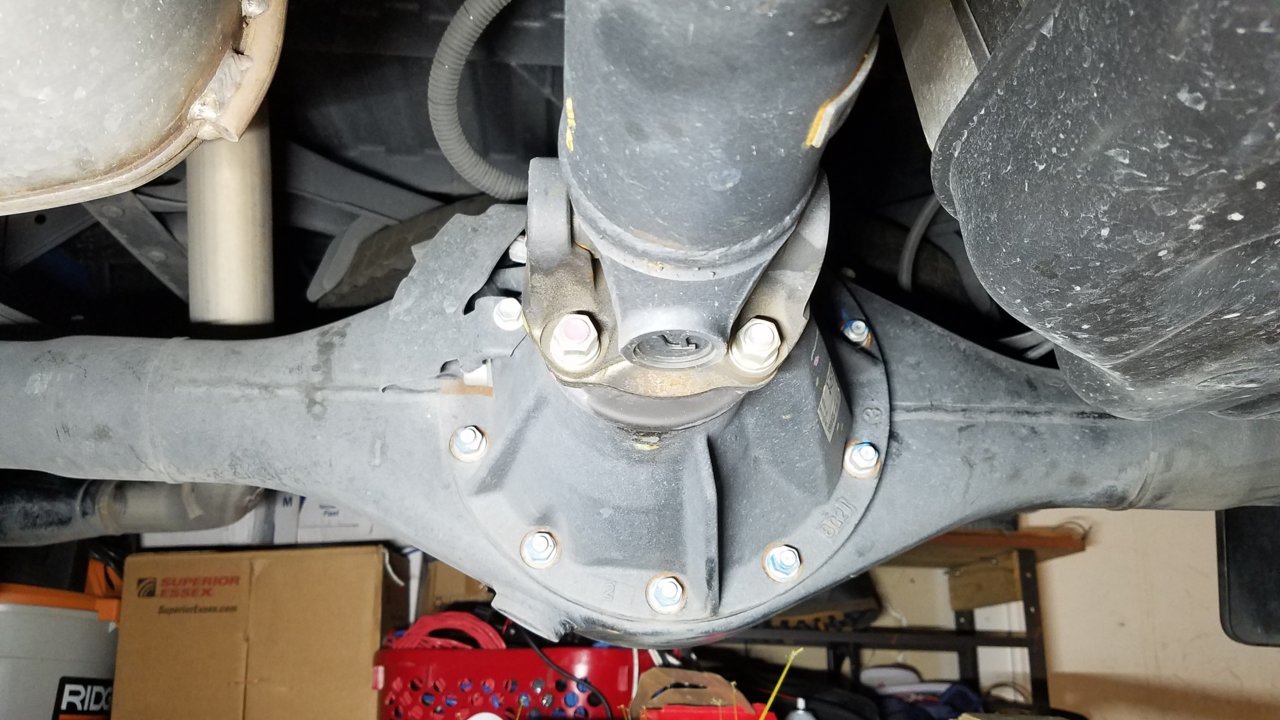

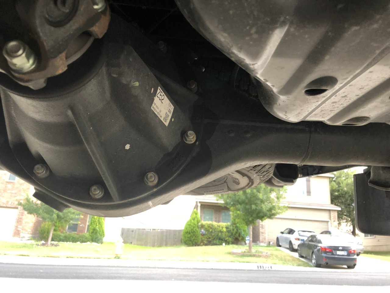

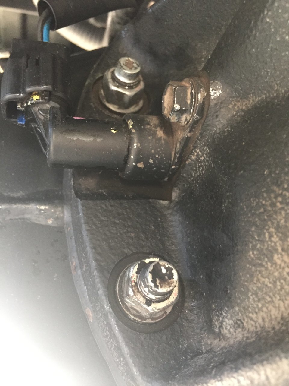

    Cheers. I think I was most startled by the grease patch on the right side of the photo, closest to the shaft.

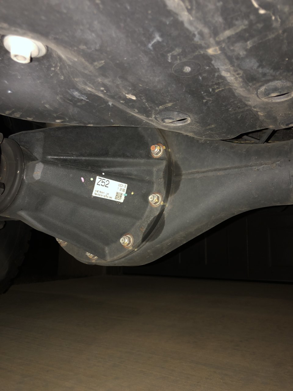

    My update on this subject:
    I reported my concerns with corporate, they acted on it.
    I took my truck to another dealer, got a rental for the day. They who cleaned it and and ran it for 1 mile.
    They say is is bone dry, and it shows in the new pics. Someone mentioned it being assembly grease drying out, I would be very happy with that root cause, since I really don't want them to pull my diff. apart.
    So I am now documented in the owner data base with Toyota and will now monitor it.
    Note all the dealer did was cleaned the oil and ran for 1 mile.
    Before 10150 miles
    After 10345 miles

    Oh gesh, sorry. I only looked at the tiny spot on the cover in back like everyone else’s, and originally saw it while outside so it was hard to see too.
    Your input seal does look worse, bit its not dripping in your driveway, blowing back all over the differential, or spun all over the bottom of the truck above the driveshaft, right? It should be fine until you get home still, I would take that in though. Again, sorry for missing that one!

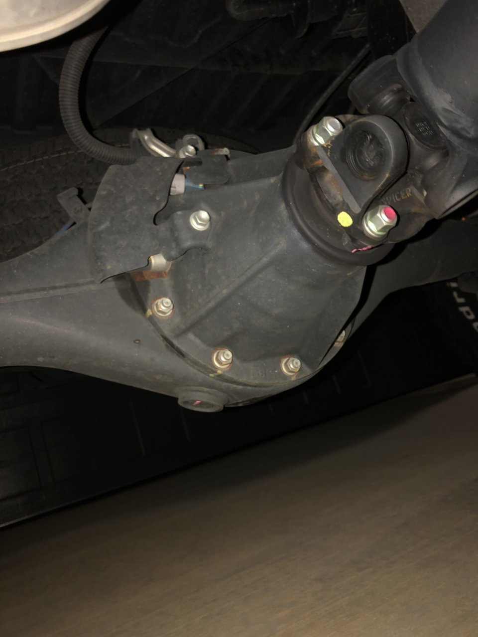

    Don’t be sorry. Ugh. This will be the sixth time I’ve taken this truck in, unrelated to this. It is not dripping in the driveway as far as I know. I have it parked on concrete here until Friday so I’m gonna take a look to see if anything drips. I don’t think it’s sprayed anywhere.

    Still dry, so I think we are good.

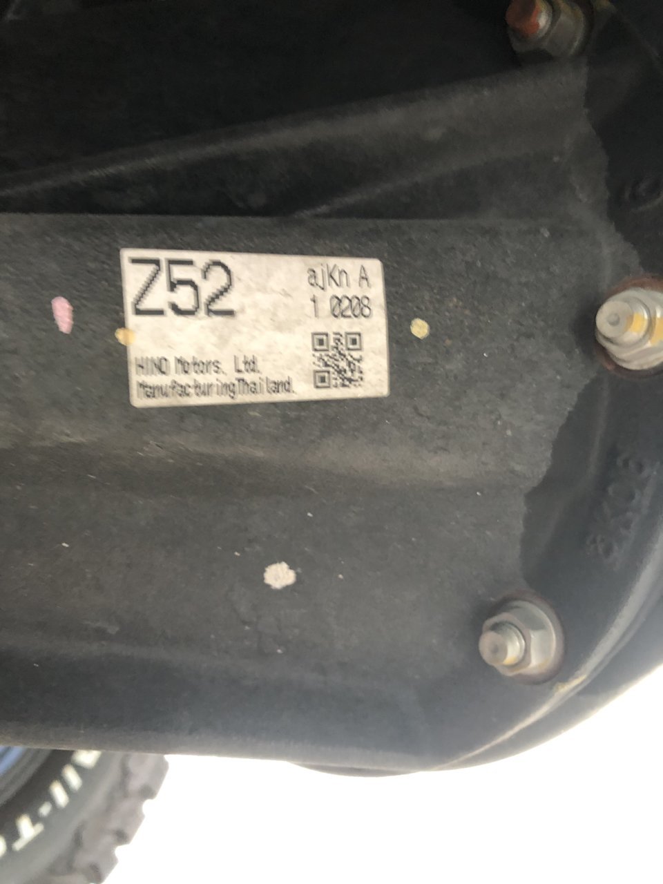

    I just went out to check my 2018 TRD OR with 15,500mi and my rear diff looks almost the same as this. Except my seepage spots don’t look nearly as fresh as these do. I cleaned off with brake cleaner to see if it’s something from the factory or what, it looked about that old.

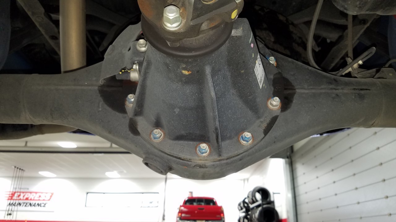

    Here is mine at 29k miles. Dealer said improper install from factory. Replace diff seal and axle seals.

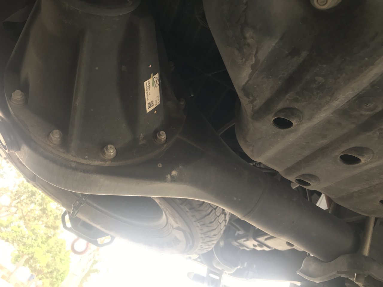

    My 2018 with 15,000 miles ...

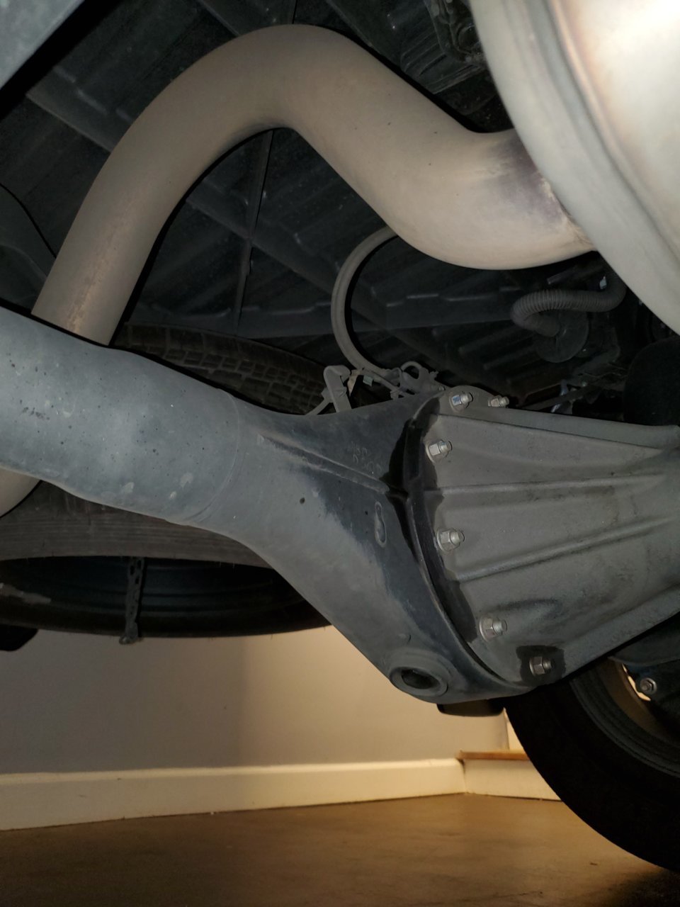

    Dangit, i got same weepage of rear diff on 2018 with 10,500 miles.

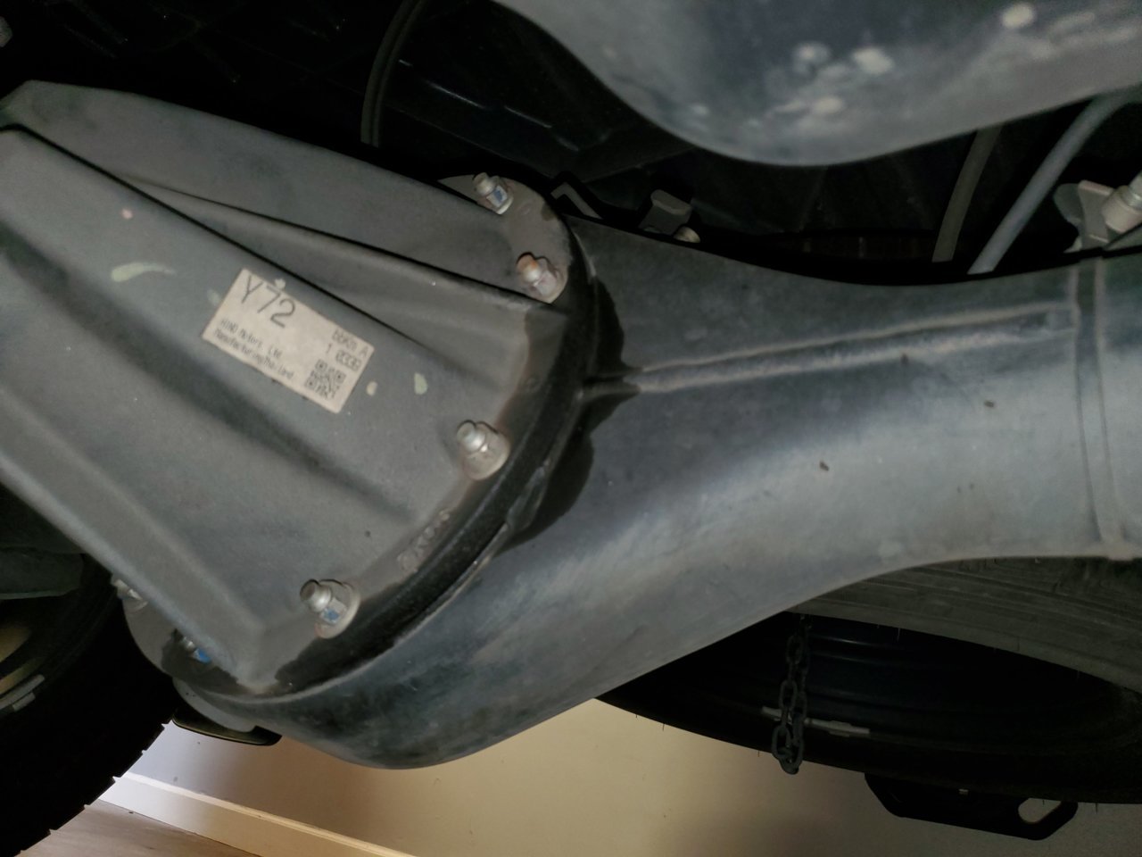

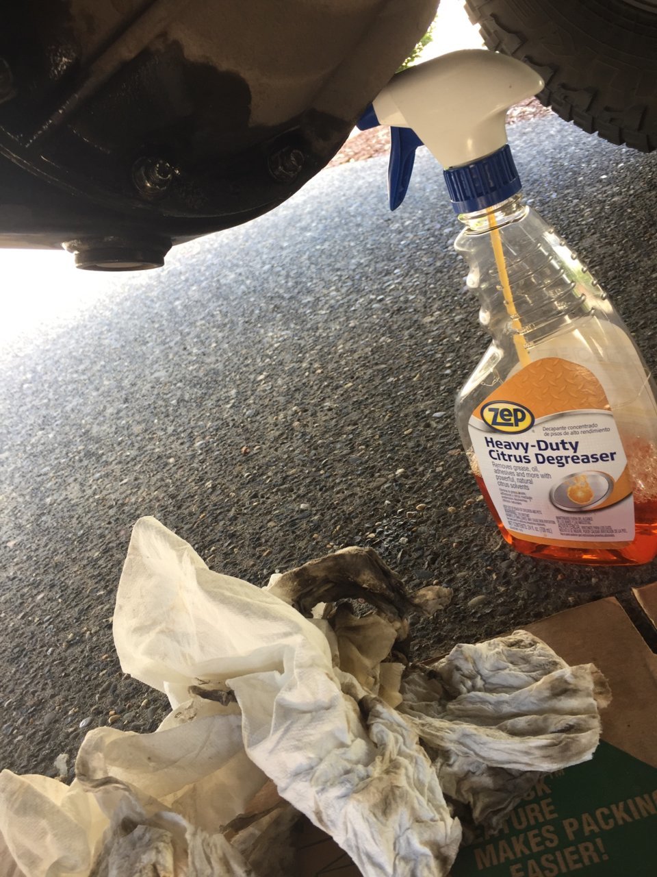

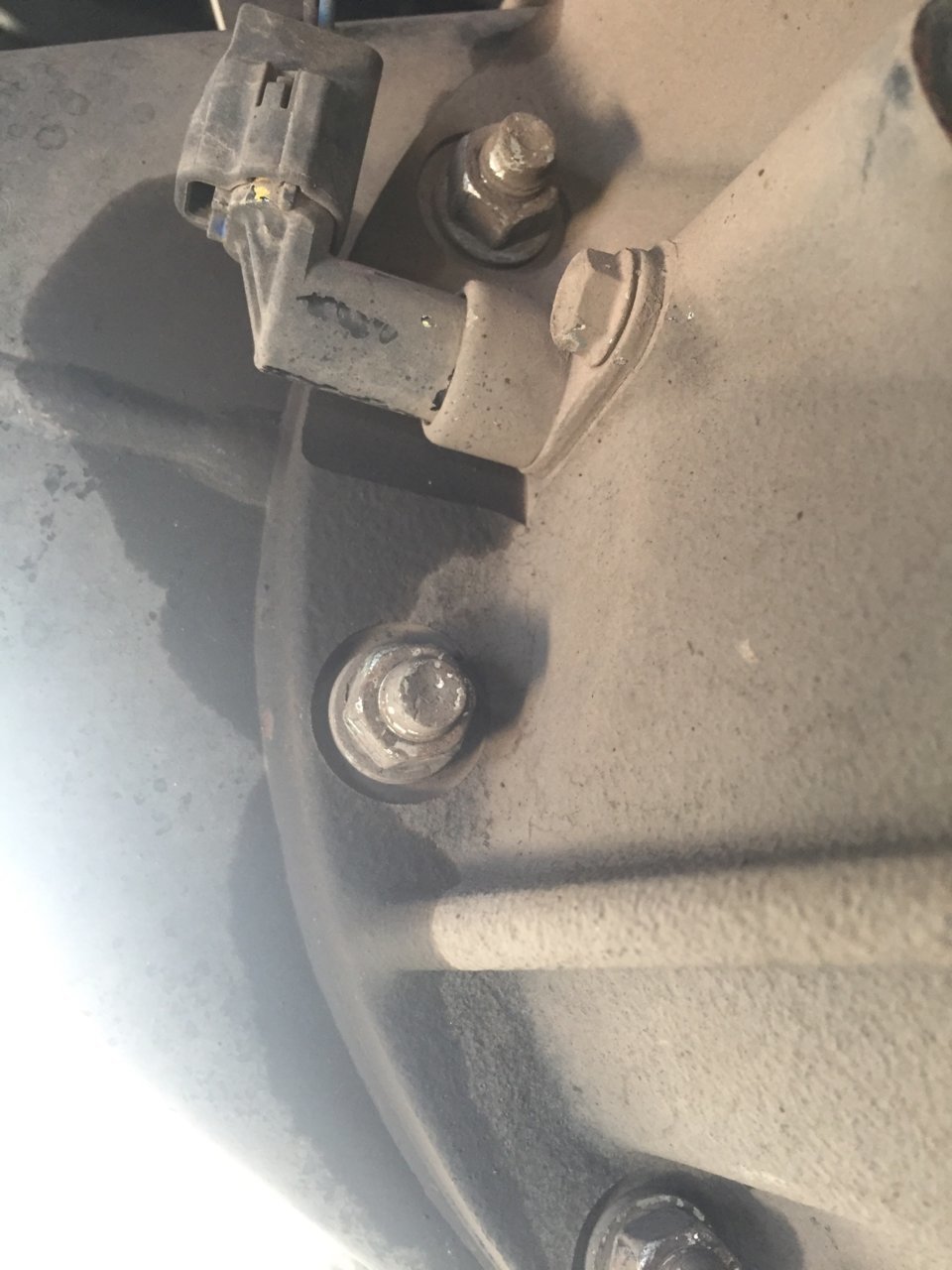

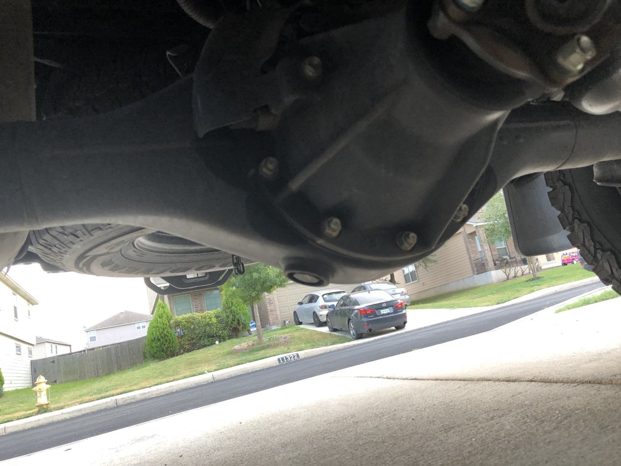

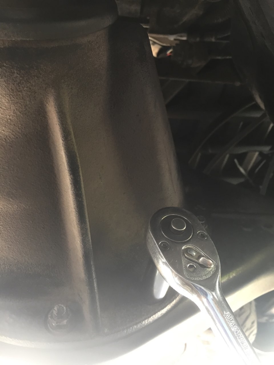

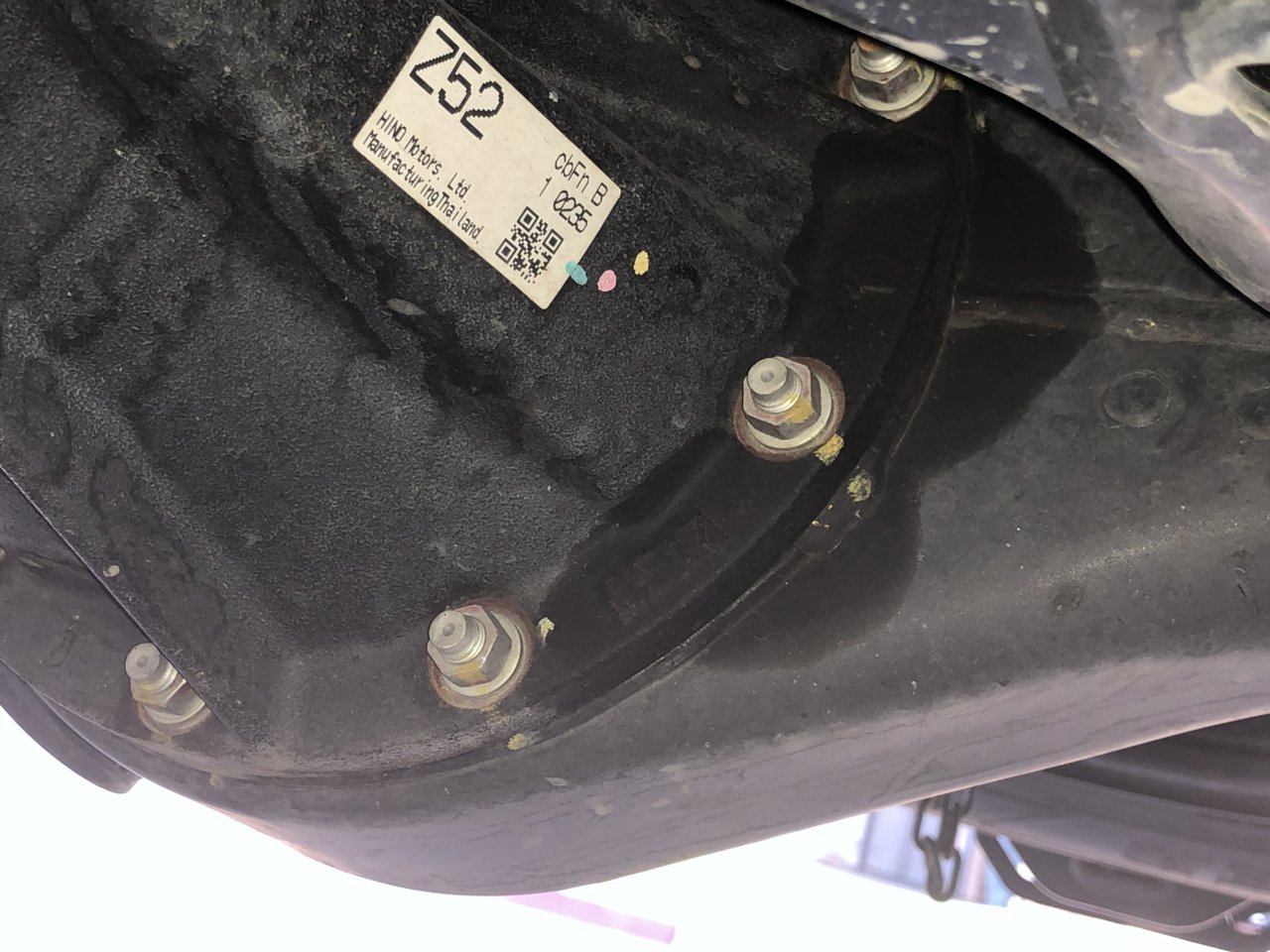

    It’s not residue from the factory.
    The dealer replaced my leaking rear dif gasket at 3,000 miles. It was dry after that for about a year and a half.
    It’s seeping again, but at least it’s not wet like before.
    I just cleaned it up yesterday at 17,200 miles, snugged up the nuts and will keep an eye on it.
