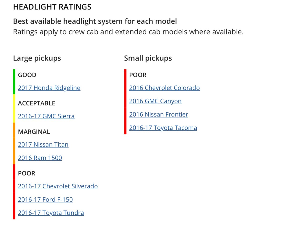

    I agree with the OP assessment that the Tacoma headlights are bad.
    If you’re getting flashed, your front end has perhaps been raised a bit, or rear end lowered by weight?
    I purchased brighter low beam bulbs and they gave me perhaps another 20 feet of throw down the road, and I’ve not been flashed by oncoming vehicles.
    Try Phillips halogen headlight bulbs. Their +60% or +80% are a bit brighter than stock bulbs and throw just a little more light down the road, don’t blind oncoming traffic and are decently priced.
    For high beams, I think you can get +100%, which aren’t actually 100 percent brighter, but as you turn off your high beams when vehicles are approaching, they too are a bit brighter with better throw than the stock high beams.
    IIHS headlight ratings:
    I first read about the Tacoma headlight ratings 2 years ago.

    You lost me once that picture said the Ridgeline was a large pickup...
