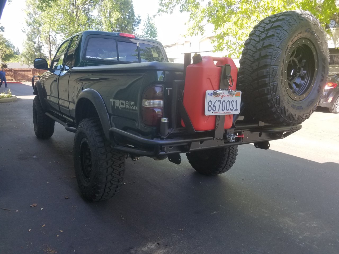

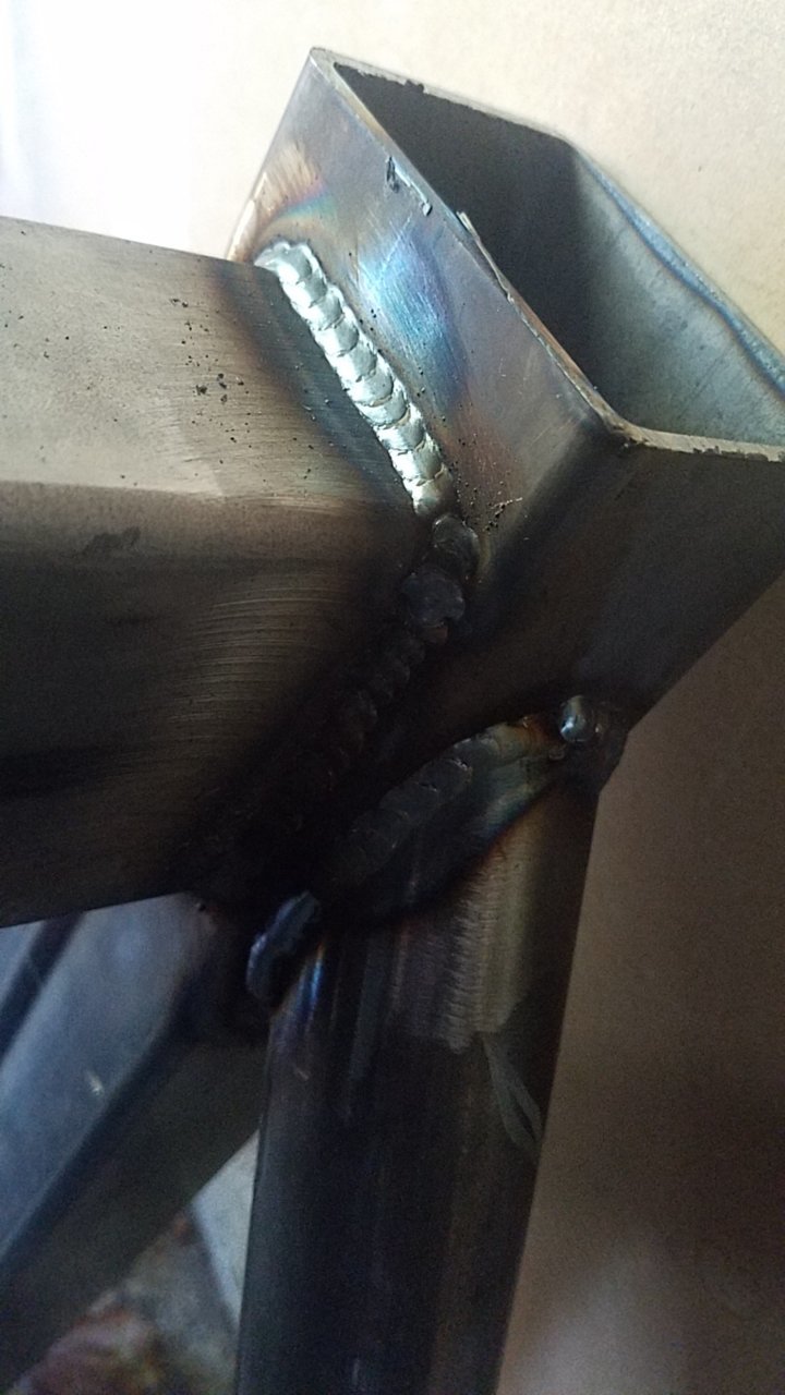

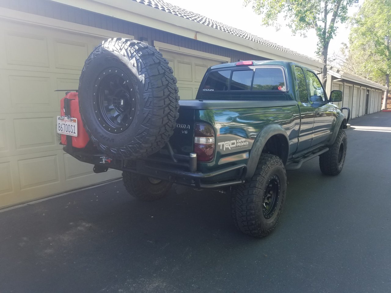

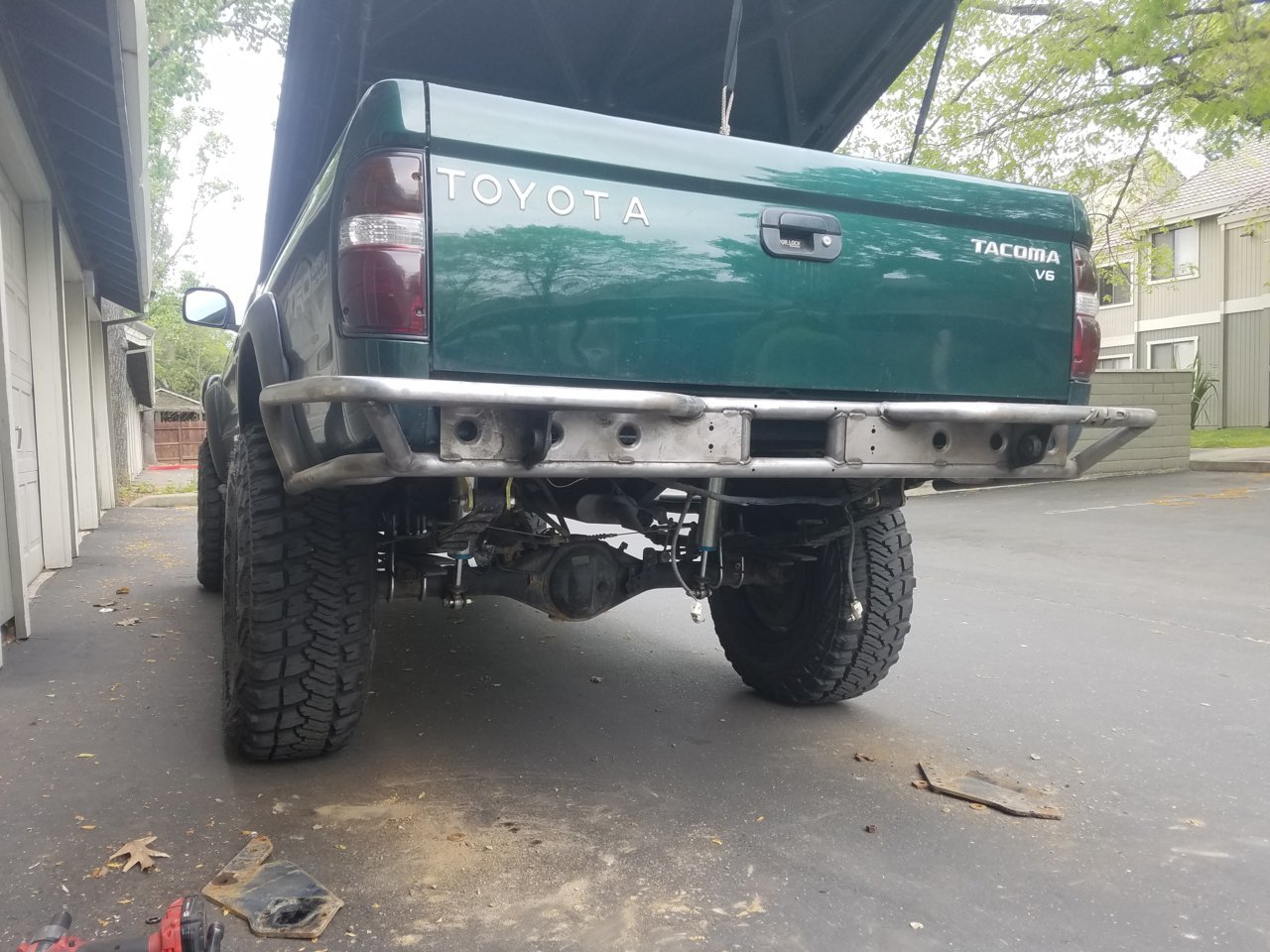

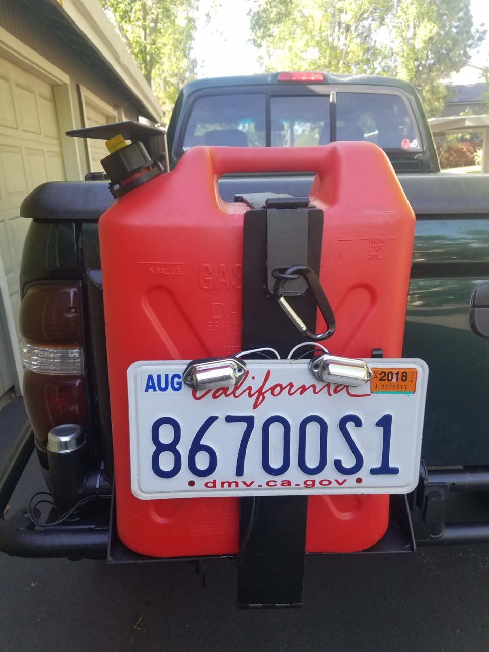

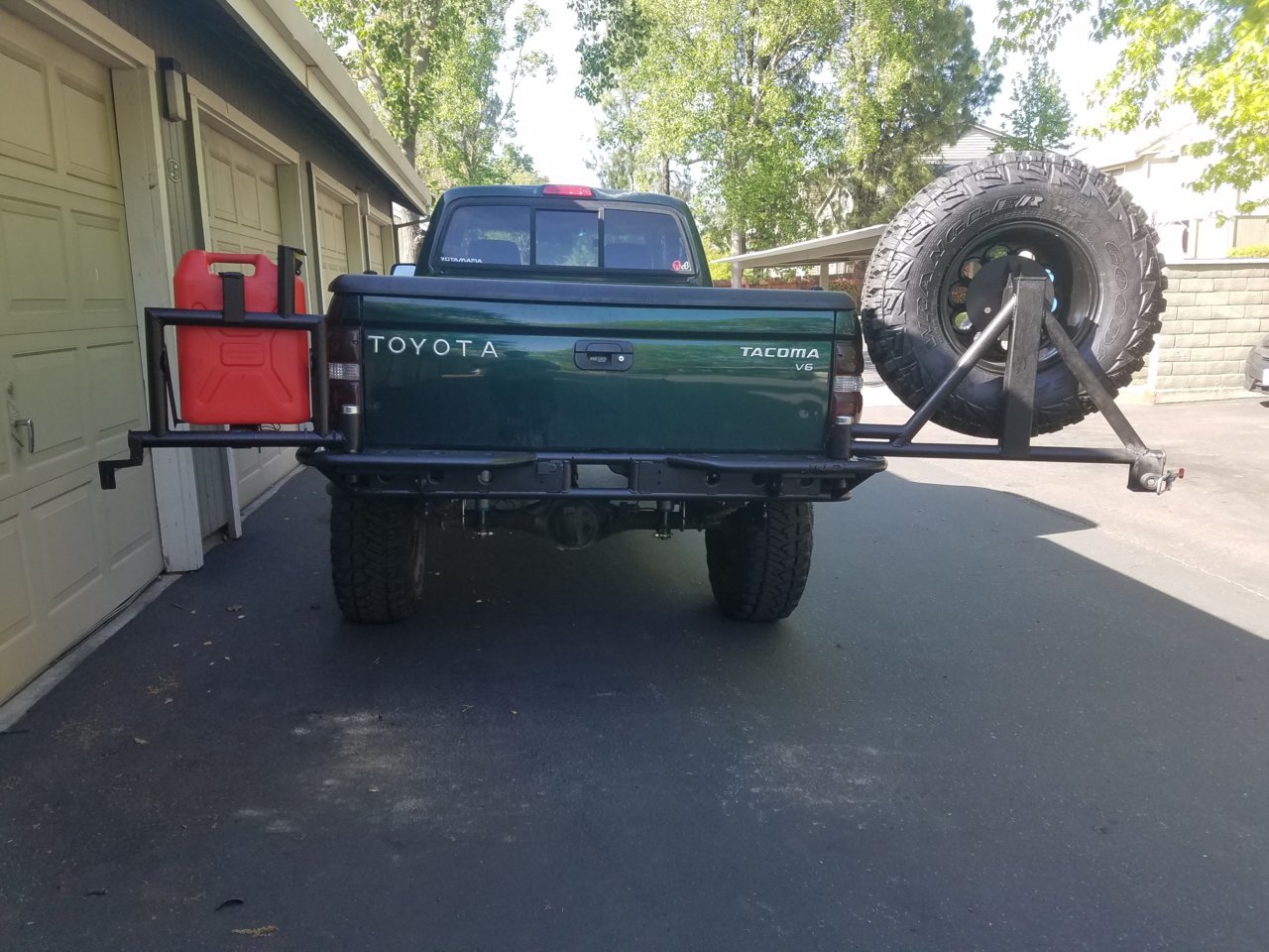

    Progress! I'm way stoked on how this thing turned out! Took the all pro tube bumper, added some rectangular steel and put in ruff stuff specialties spindles, cut a bunch of tubing and flat bar and just made a swingout and Jerry can holder (Costco 13 bucks, will do till I get a metal one but i couldnt pass it up). Came up with the idea to make room for a second Jerry or a water jug if I turn it 90 degrees and use a tie down or lockable and secure the other way for one jerry. Everything locks for security and seems strong enough. Dakars feel the extra 200 lbs though lol but I'm still stoked, if anything it fixed some of the bro lean. Lincoln 140hd and mig 75/25 was killing it! Got some really good beads in!

    That's so sick
    Hella jelly

    Random question, whyd you mount your spare on the passenger side? Is there a technical reason? it seems like everyone does it

    Taco lean would be my guess...

    Because when the swingarm is extended, the drive would have to walk around the tire to get to the back. Mounting the swingarm out to the right creates a more user friendly experience and access to the bed.

    I did it that way for a few reasons. First, the taco lean. The battery, driver and gas tank are on the driver side so I had almost 1" driver side lean so I was hoping this would help. Second, it's easier for me to look over my shoulder at blind spots passenger side to compensate for the tire than if it were on the driver side and third, which is more a preference thing and idk if it would make a difference, is that I'm right handed and if my pin didn't catch it'd be easier to catch it from swinging all the way out and it's easier to handle the latch with my right hand.

    to add if your on the side of the road its better to be away from the road then into the road. safety first.

    Oh and I did a dual swingout so it doesn't extend as far ( likewhen I open it in a parking lot after getting my groceries) or put as much stress on the spindle when i hit speed bumps and such
