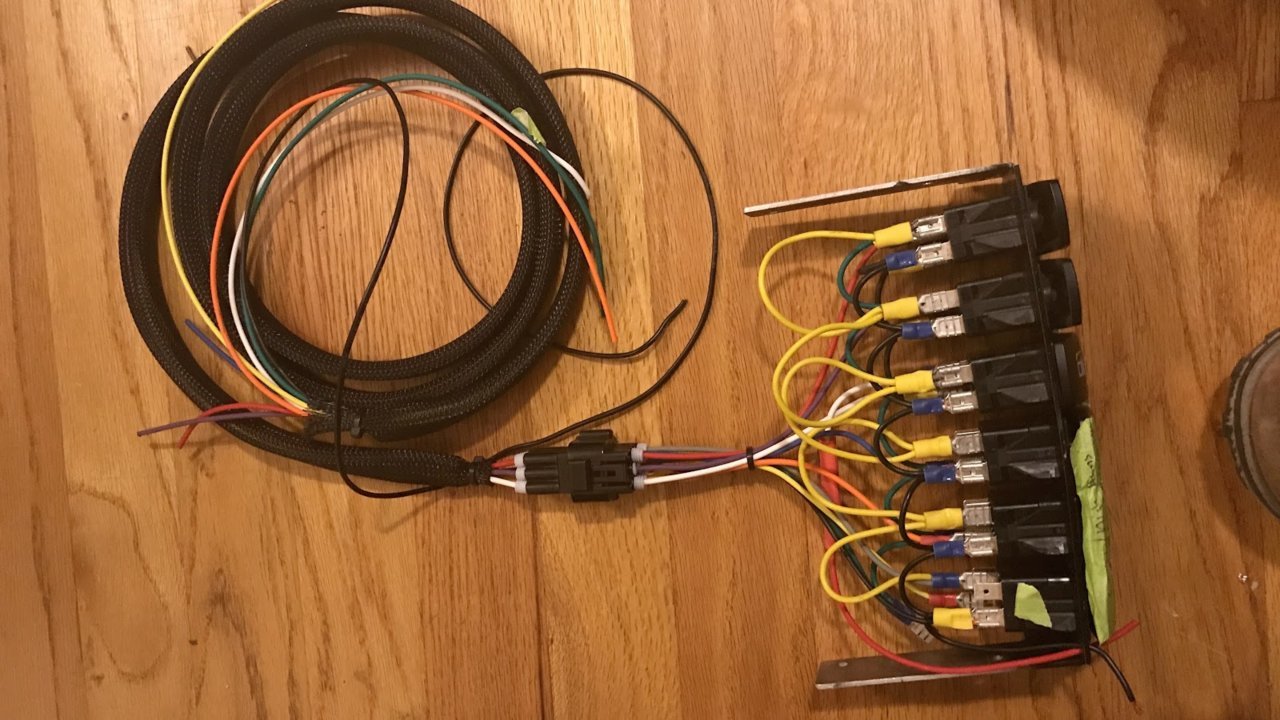

    Yeah, you can run a single powered trigger wire into the cab instead of a wire for each. Much cleaner. Unless you have multiple trigger wires like one off the reverse lights, one off the head lights, and another that powers everything else, etc.
    While I'm thinking of it here's some things I learned along the way.
    When you wire your stuff up use different color wires. You can get a GXL wire variety pack off ebay in whatever guages you want. That way you can color code each of your accessories. Also use matching color shrink wrap.
    For example I have -
    Light Bar - Yellow
    Bumper HID's - Orange Wires
    Fridge - Purple
    Aux Tank - White
    Inverter - Red (this one is on a 150amp relay with it's own breaker)
    Reverse Lights - Blue Wires
    Relay Trigger Wire - Green
    It makes trouble shooting and install a lot easier.
    I put all my switch panel wires into single connector. This makes things much easier to install and if you ever have to remove it's super easy. I got mine on https://www.corsa-technic.com/
    Just make sure you have the proper crimping tool for the crimps for the connector.

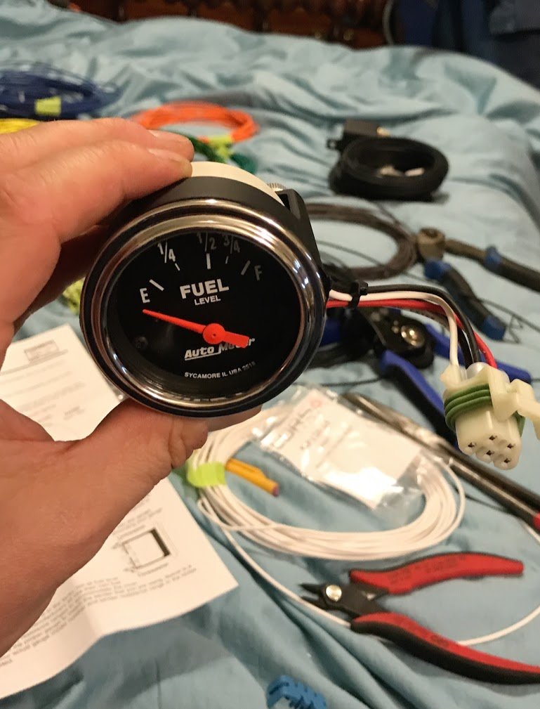

    I have another one on my aux tank guage too.
