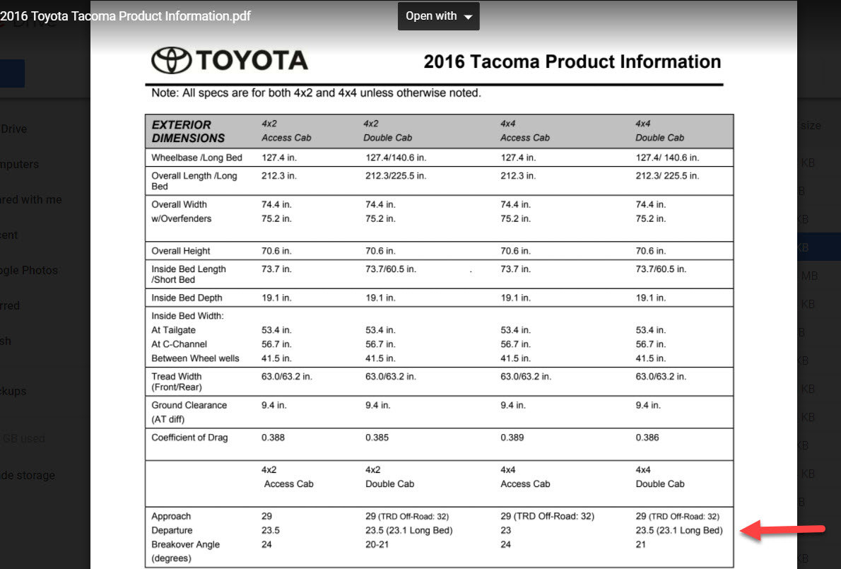

    The brakes are probably not more powerful, just that the hydraulic booster allows better control for the A-TRAC system.
    The OR and Sport are the same height. The only difference is the approach angle that is due ONLY to the removable air dam:
