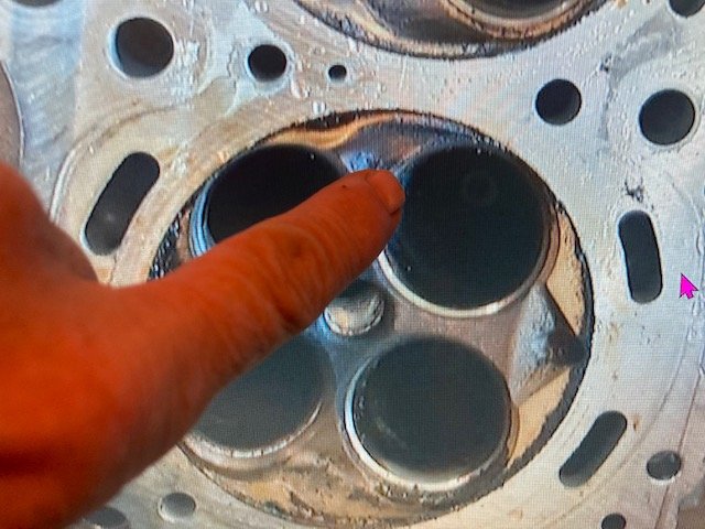

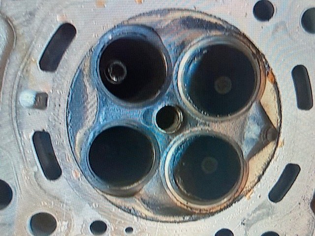

    Here is a pic of a 3.5 head that had the same air/fuel code.
    This one was the intake that failed,
    top two is the bad cylinder, take a look at the centring of the valve stem hole relative to the casting on the bad valve vs the pig of the "happy cylinder" on the bottom.

    It's interesting how the carbon is accumulating on the opposite side of the injector. The fuel cooling rapidly and not burning completely when it touches the cylinder head. Might have to take my truck out on the highway and treat it like a rented mule to make sure to burn some of that off!

    Yeah after seeing these I give her the beans every once in a while just in case. As well as go on a long drive every once and a while if I've been making a lot of short trips. And injector cleaner a couple times a year when I think about it.
    Ive been surprised too on the amount of crud especially on the intake side.... even on the "good" cylinder. I thought port injection cleaned most of that out....
    Purely conjecture on my part, no analysis done in any lab and the idea came to me with a beer in my hand. So take it with a grain of salt....
