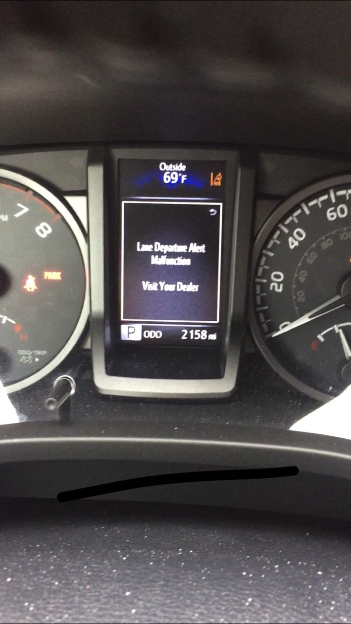

    I'm receiving 3 malfunction messages on my 2019 TRD Sport: Lane Departure Alert, Pre-Collision System & Headlight System. The malfunction messages all say to "Visit Your Dealer". Unfortunately, they can't replicate the issue, and I can't make it happen. Have a case open with Toyota, but they're completely unwilling to even take a look at the issue. 3 pics attached showing malfunction messages. Any thoughts? I'm really struggling with this, as the dealership and Toyota are not willing to work with me.
