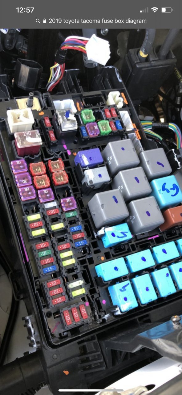

  13. Dec 18, 2020 at 11:31 AM
    #73
    JoBarrera
    JoBarrera New Member
    Dec 18, 2020
    #350022
    Jose
    2019 Toyota Tacoma TRD OFF ROAD
    I’d the same issue, precollision malfunction, air bag warning, stability control warning, seat belt warning, no radio, no alarm, i just take my car to the dealership and the problem was on the main fuse box, they just replace a fuse and everything works fineC78B2374-01C9-40D0-8971-78F59C44E914.jpg

    any chance do u know which fuse was bad?

    Just found the answer to these problem we all have been dealing with. I posted it in another post. Hope this helps!
