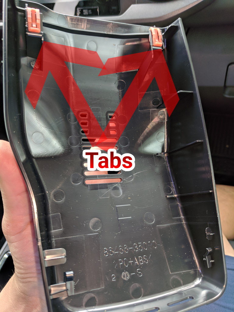

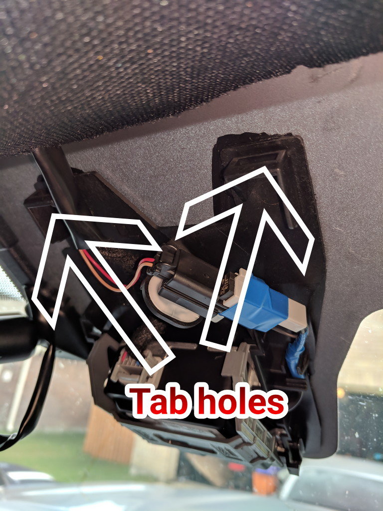

    Item 3 in the drawing (the cover) keeps falling off after a windshield replacement. Have had both SafeLite and Toyota dealer try but with no success. Any ideas?

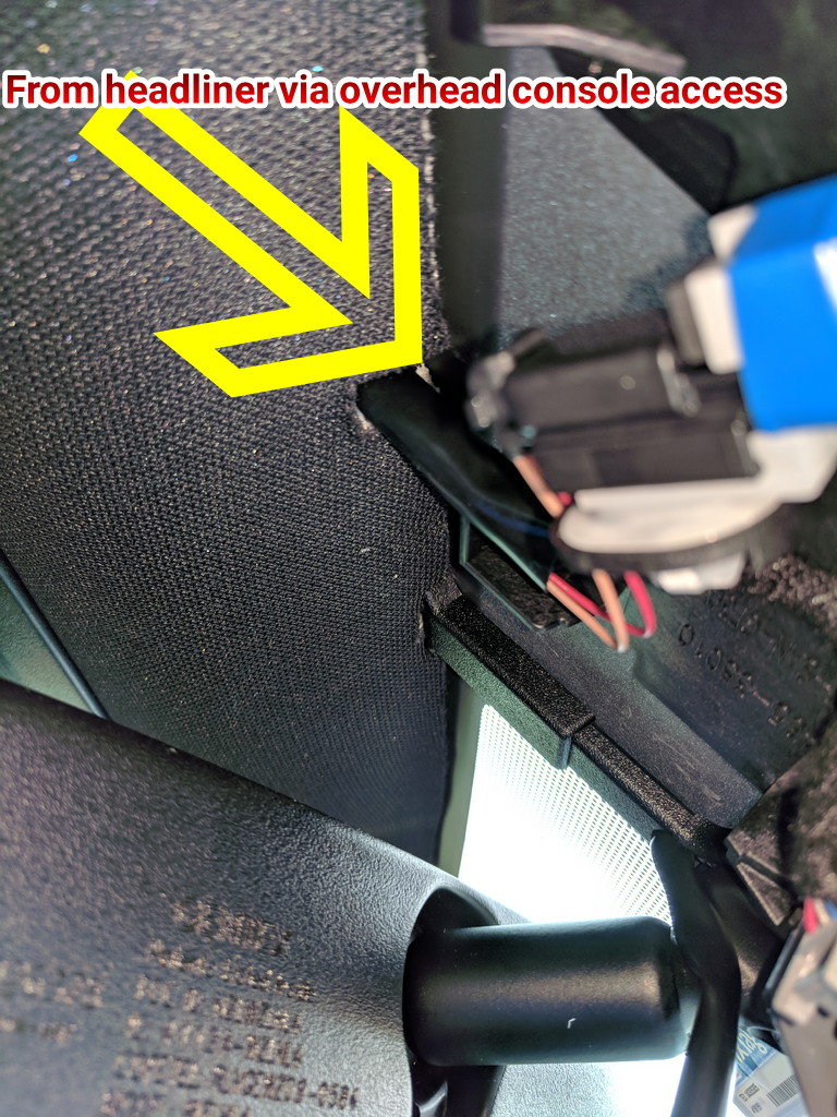

    I wanted to see how the cover was removed. Here are photos. If it is not apparently, the tabs indicate prying off would be risky and hard to fix without a new cover. The best way to remove is to slide it down
    I plan to connect the USB dashcam kit to overhead console wire, use the USB Micro Fem adapter to USB A Fem adapter to connect the panel mound USB A port through the hole into the cover of the windshield box.
    The goal is to have a powered USB port to plug any cable to any cam.

    To be fair, I used Safelite and they ordered in a replacement windshield from Toyota for my 2018. Only problem was the lane departure sensor cover kept falling off. Took 3 attempts but last fix by dealer seems to have this fixed now. The tabs in the photo above goes up in to the holes and the little tabs on the very bottom of the cover click into latches. The cover can just fall out if everything doesn’t lock correctly. It may stay in place for a few days and suddenly fall off! Good luck getting it to stay in place - it is possible.
