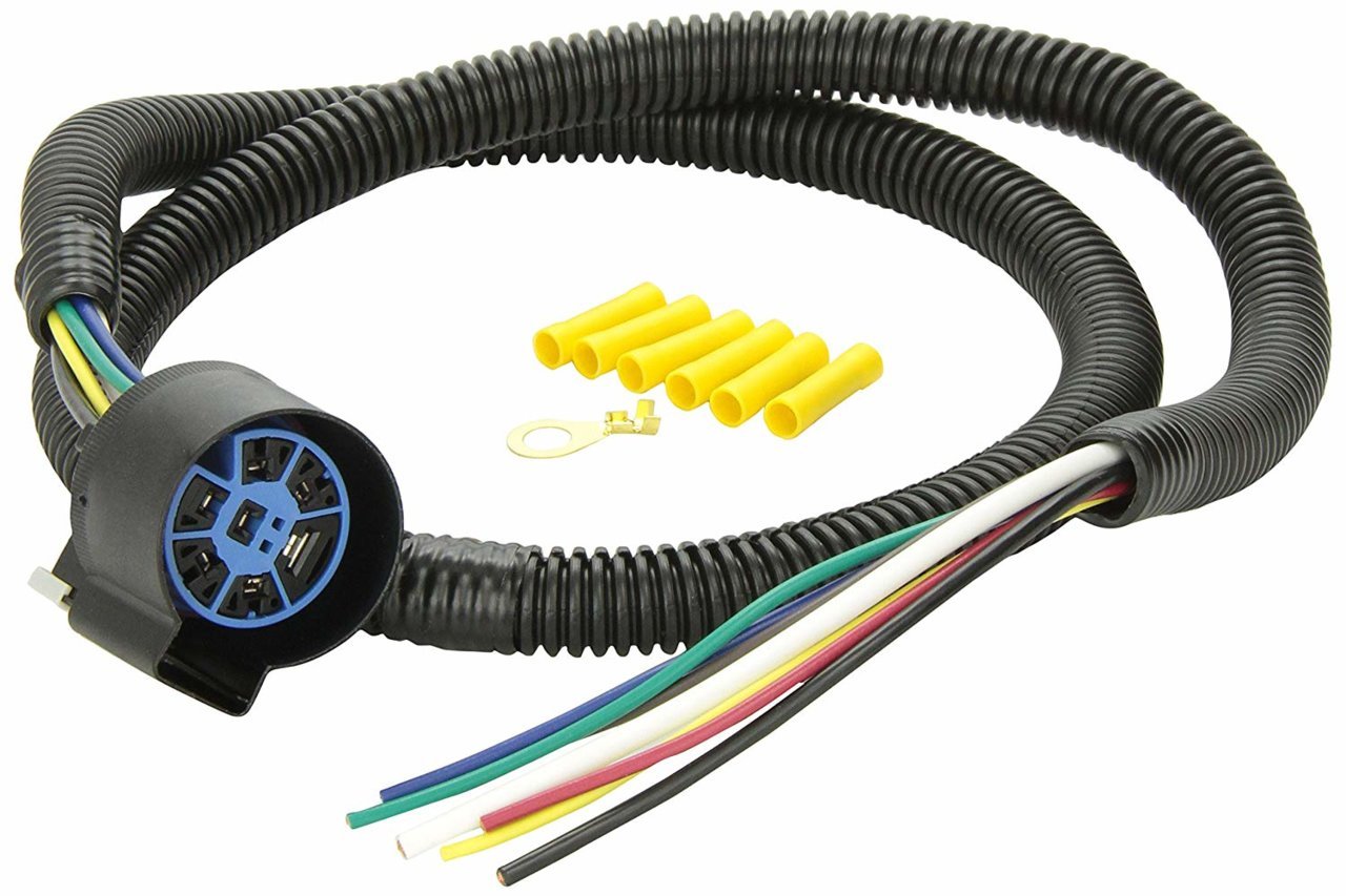

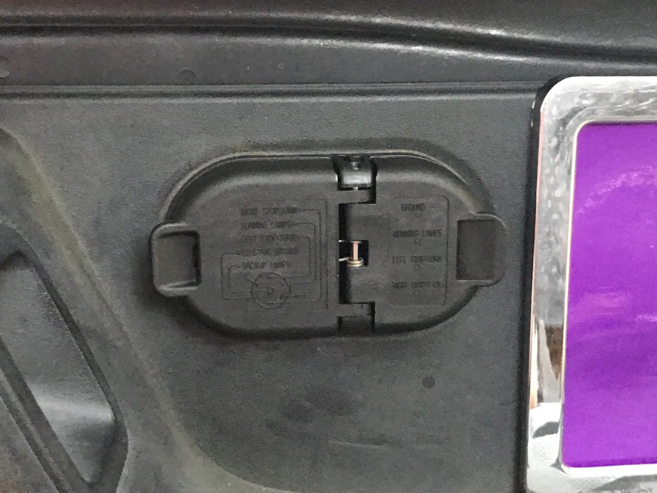

    Installed the Curt wiring harness and wanted to use the toyota factory oem plug (which has Pollack and made in Mexico on the back).
    Needed to also add the
    POLLAK 11-998 4' Pigtail Wiring Harness. Had everything wired up and everything worked except the driver side turn signal and brake light. No wire diagram included in the package that I recall.

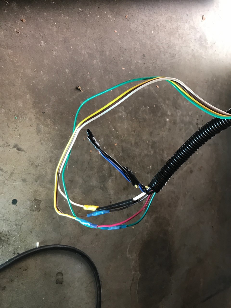

    Ok, thought that was weird. So I redid the yellow wire connection with the heatshrink connector.
    Dang, still nada.
    Well bugger, cut the yellow, brown, white and green wires and connected to just the 4 pin connection.
    WORKED.
    I did look at the connections on the pigtail and thought everything looked ok.
    Nope. Finally read the Amazon reviews for the pigtail and found out that the Pollack decided to use the RED wire to supply power to the driver side for brake, hazard and turn signal.
    Sigh, started over, getting pretty fast by now.
    Success.

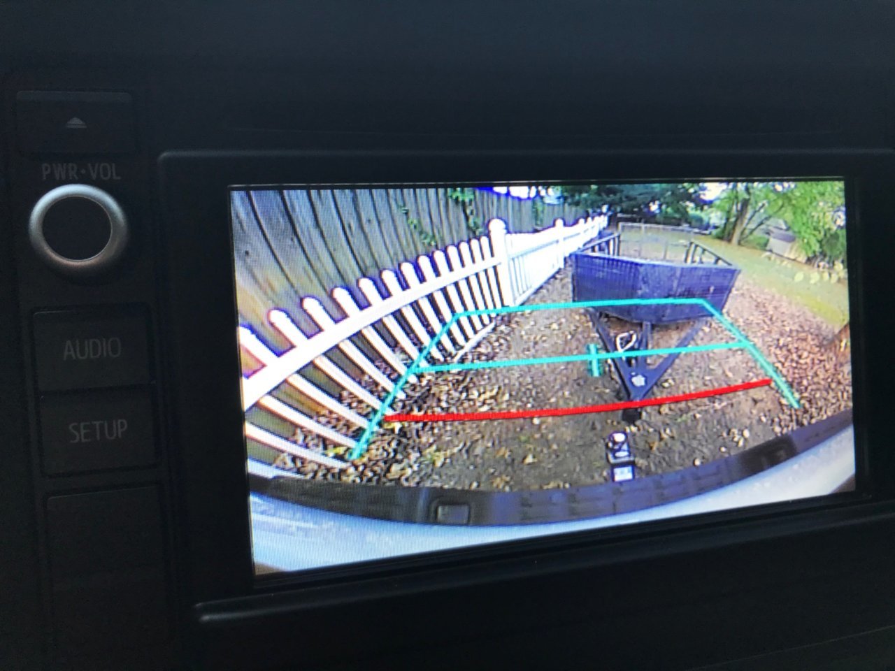

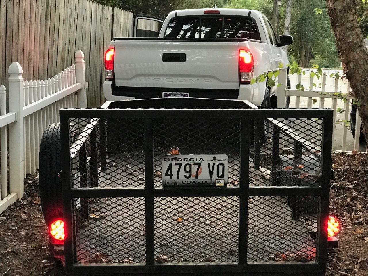

    Also including pics as to the location of the hitch on the camera and in real time. Pretty close.
    Here is what this pigtail is:
    Red - Left Turn and Stop - 14 gauge
    White - Ground - 10 gauge
    Blue - Electric Brakes - 12 gauge
    Green - Right Turn and Stop - 14 gauge
    Black - Battery - 12 gauge
    Brown - Running Lamps-tail lights - 14 gauge
    Yellow - Backup Lamps - 14 gauge
