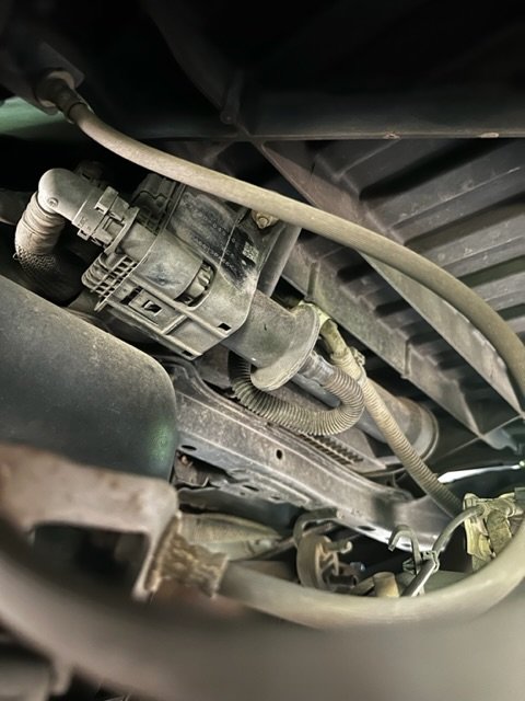

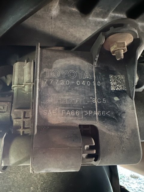

    Hey sorry for the delay. I haven’t had a chance to get my OBD hooked up.
    was wondering if you knew what this part is? Haven’t been able to find anything online. (Photos attached)
  12. May 20, 2023 at 3:47 PM
    Dm93
    Dm93 Test Don't Guess
    Mar 3, 2015
    #150066
    13,502
    Texas
    2014 DC OR 6spd 4x4
    Predator tube steps, Ranch Hand grill guard, Magnaflow CatBack exhaust, Toyota tool box & bed mat, 2LO Module by @Up2NoGood, Rearview Compass/Temp Mirror, Tune by @JustDSM.
    That's the EVAP charcoal canister & leak detection pump assembly I believe.
