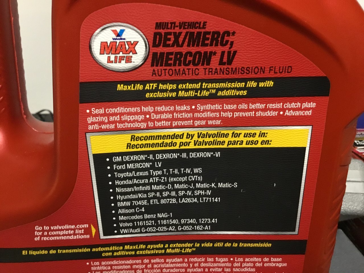

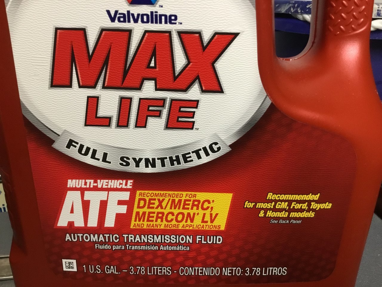

    That’s the funny thing about the transmission level check. If you drive it several miles to the dealer, the transmission gets hot and is then above the recommended temp to check the level, so it takes hours to cool back down.
    100 degrees can be reached by driving around your block once or twice.
    The actual fluid check after letting the transmission warm up to just above 100 degrees only takes a few minutes.
    For those who have not researched or checked their own transmission fluid level, it’s not difficult.
    If you can change your own oil and you’re a do-it-yourselfer, you can do the transmission level check:
    If you can dodge a wrench, you can......never mind, I digress.
    For those of us checking at home or taking it to the dealer, when the proper temp is reached, the overflow bolt is removed and if a little fluid dribbles out, the transmission level is full.
    The problem is, if no fluid comes out, you still don’t know how low it is, so fluid must be added until it flows out of the overflow tube, and it’s no fun working around a hot exhaust.
    Or, you can do a check by just adding a quart first while the truck is cold and before starting it so that you don’t have to worry about a hot exhaust contacting your arm or hand. Then, bring it up to temp and remove the overflow. If some fluid comes out, then it’s filled and you’re done.
    If no fluid comes out, then it’s still low. In this case, you can then just let it cool down at home and repeat the procedure of adding a half quart or one quart later in the day, or do it on another day if you so desire.
    TW members have reported anywhere from about 1/2 quart to two quarts low.
    Other TW members will have tips on how to determine the temperature of the transmission.
    If you’re new on TW, you can do it!
    There’s more satisfaction in doing it yourself and also knowing it’s done right. And, it might take a lot less time than bringing it to the dealer.
    You can use any fluid that meets Toyota specs.
    AF0AC26D-C935-42F1-B433-2AB41C0B03B2.jpg 3DDB073E-EBE5-4913-BF95-D9F103F1A409.jpg
