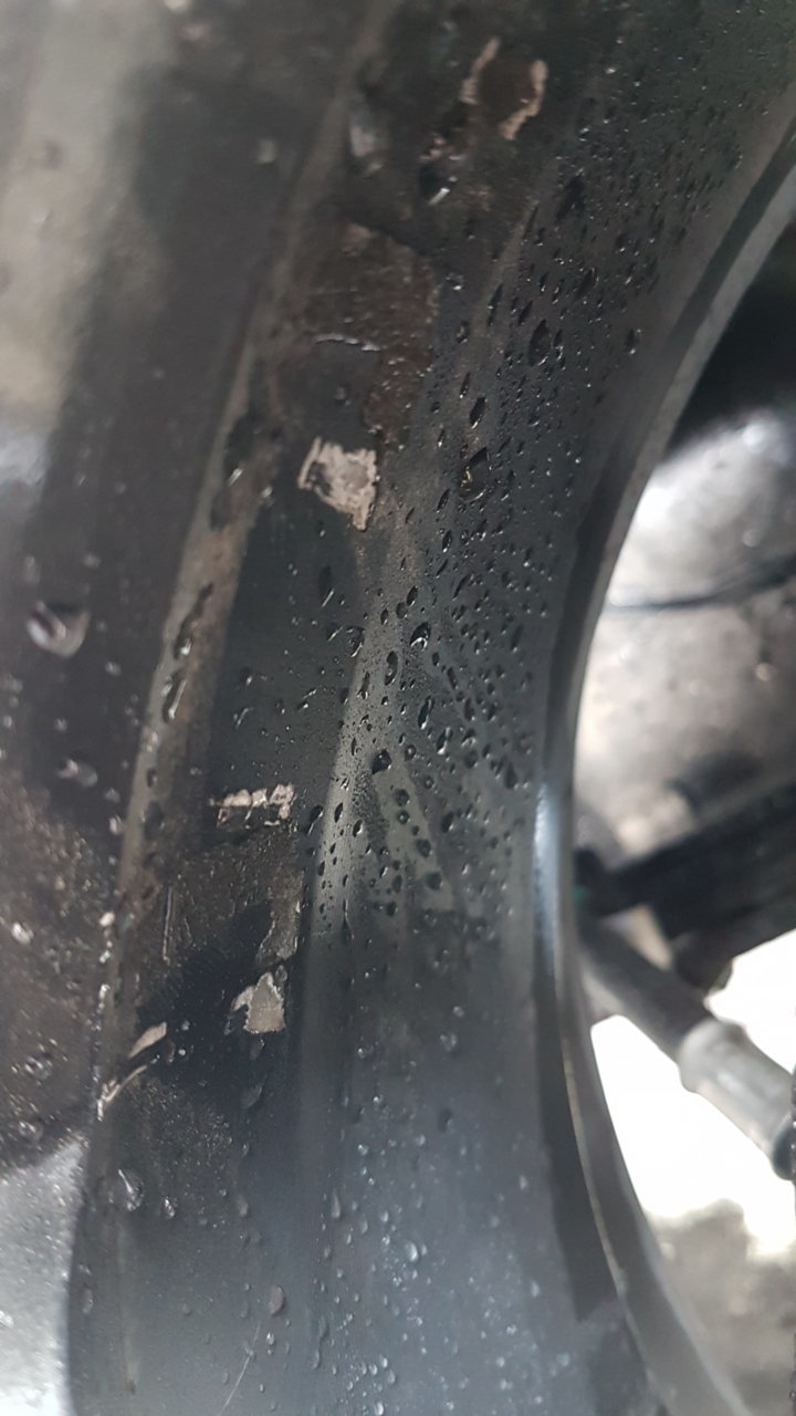

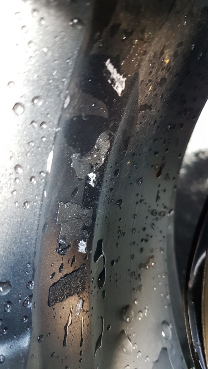

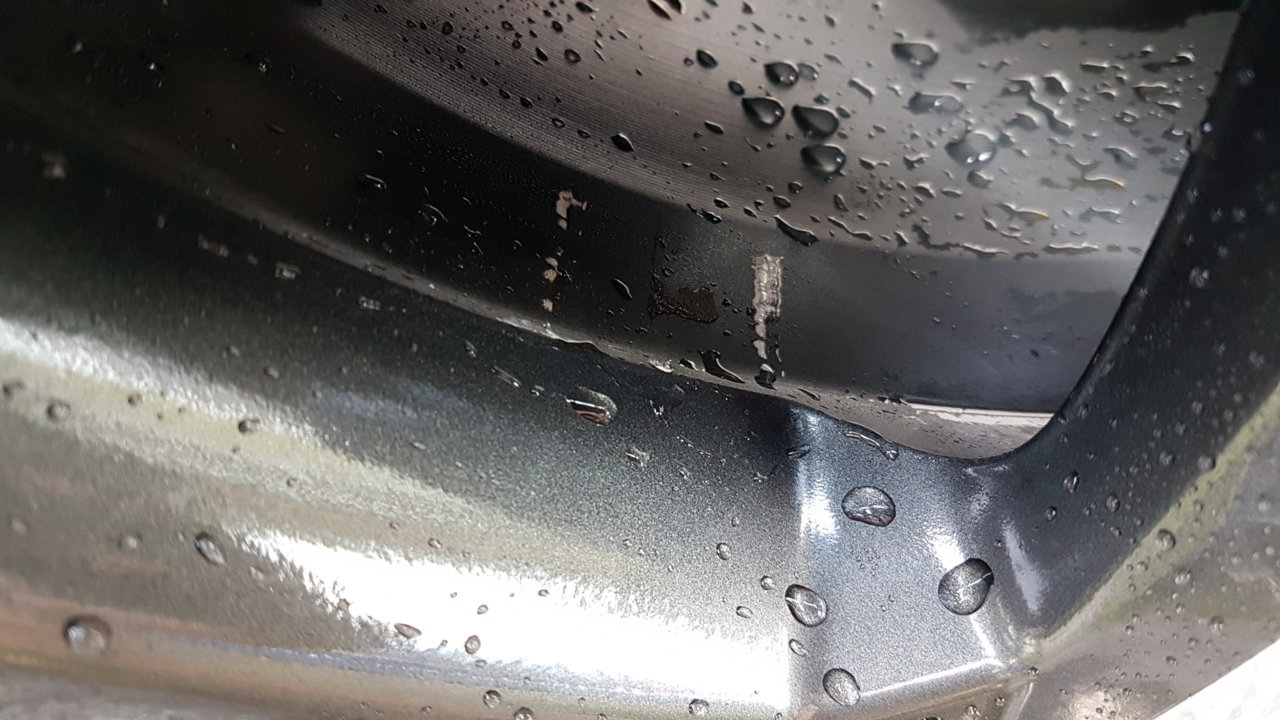

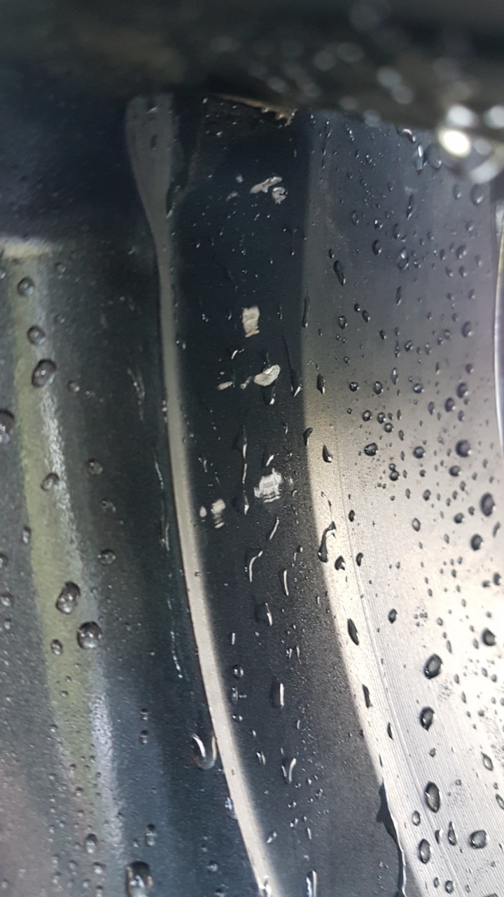

    On another note... I'm not having a great evening now after washing my truck and finding all four wheels were gouged out with what looks to be a screwdriver while taking the weights off. Not impressed.
    I don't know what kind of crowd they have working there. I've lost all trust in them.
    When I picked up the truck on delivery, there was rock chips all over the hood and bumper (new truck coming in to swap all the parts for me). The tires had 20psi all around so I'm guessing they skipped the PDI.
    I had my factory hard tonneau installed and they just threw the seals in the bed and called it good...
    Terrible.
    I'll be requesting these wheels be replaced tomorrow. You just don't do that...that's carelessness not a mistake. Especially on all 4...
