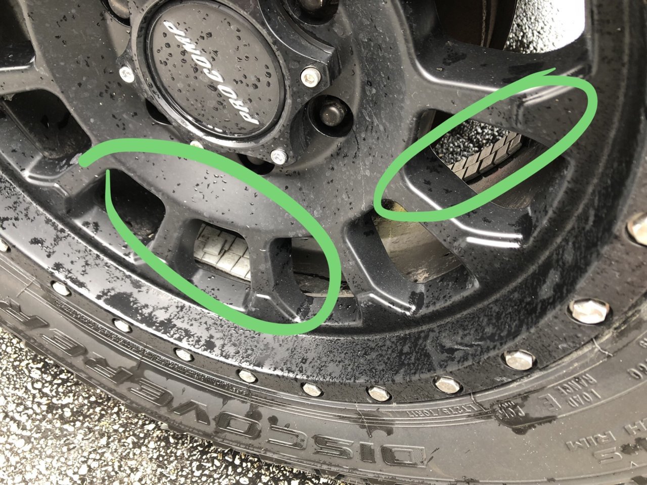

    CMC 285/70/17

    that's a dynamic balance

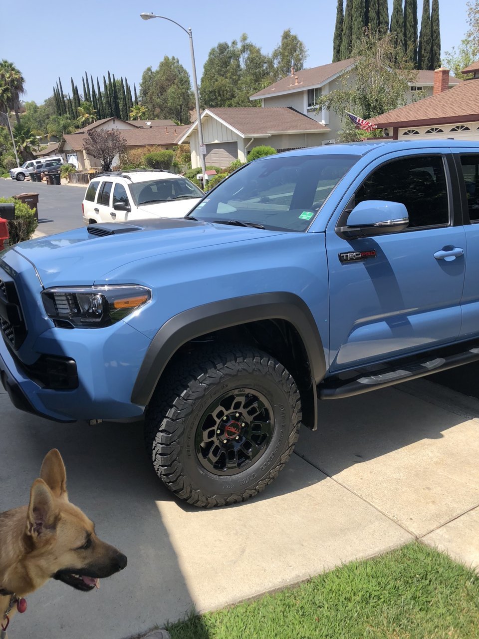

    33660BA7-91EB-4A26-A9D2-A8E3F4DC916F.jpg I’ve got LTs on mine in 265-75-16. No shimmy. Drives great. Somethings wrong with yours.
