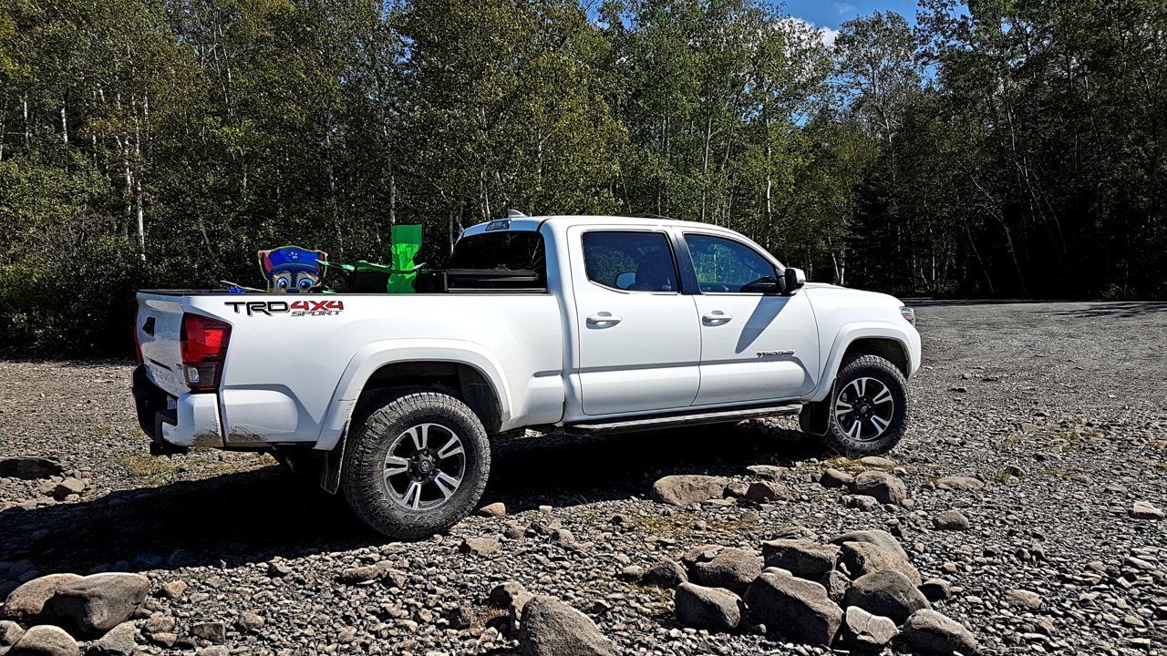

    Hey all,
    Sorry it's been so long since I've replied. Been busy with work and getting this straightened out with the dealer.
    It seems we've finally solved the issue! I'm very happy with the result!
    So here's what we did over the past few visits:
    I went back on Wednesday and spoke with the tech again who balanced the tires. He said even when all 4 were showing balanced perfectly, the KO2s were shaking the crap out of the road force balancer! He had tried it before giving it back and said to the service guys that "it was better than it was but still not right". He said all 4 were shaking the balancer, not just one.
    They touched base with other Toyota dealers. The other dealers said the last few years have been a nightmare with KO2s on Tacomas and Tundras. Most of them have stopped offering them as an upgrade.
    I worked with the parts department who was in contact with the other local tire dealers. They found another tire they thought would work and ordered in 4 new Toyo Open Country AT2s in LT 265/70R17. These are still an E rated 10 ply but have a much less aggressive tread.
    They were not available in the stock 265/65R17 size. I was more than happy to go up a size especially when the dealer offered to put on file that they were recommended. This would not leave any reason for Toyota Canada to deny warranty etc (for example a pre mature failure of a wheel bearing) due to a non OEM size. They would take it on themselves to ensure any issues were covered.
    Instead of ordering these through Toyota, which would take a week, they got them from the local O.K. Tire who had them in stock.
    They were installed yesterday afternoon and I picked up the truck after work. I took a drive on the highway and on some dirt roads. Really gave it a good test.
    Man what a difference! These tires feel very smooth much like the OEM tires. They're loud as balls but are smooth with no vibration what so ever!
    I just got back from a 100km trip on the highway and a rough road to the lake with the young fella. Tires performed awesome the whole trip! Smooth as glass on the highway and rugged yet plush in the rough!
