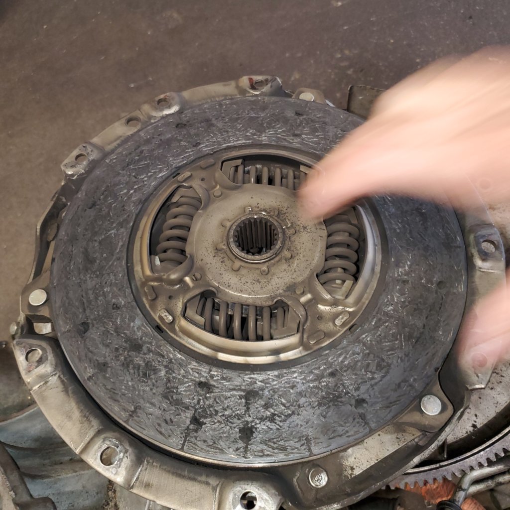

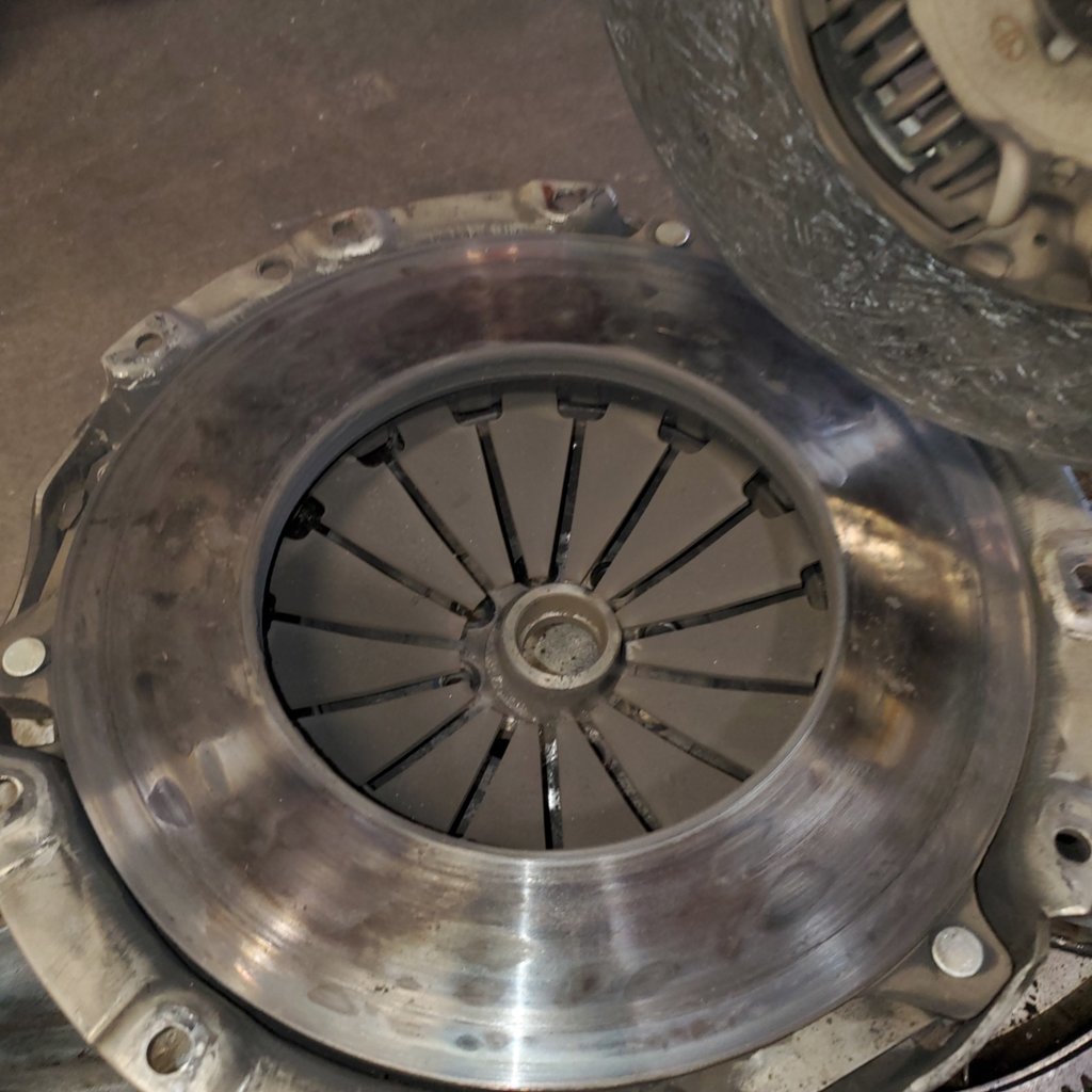

    Update*** so i finally got my truck over to a shop, the issue went away for months, then returned recently as the weather got cooler. Clutch requires replacement, hasnt been opened up yet but was diagnosed from test drive from a highly rated and reccomended transmission shop. Ordered and received a centerforce assembly. Getting installed in the next 2 weeks and will update again. Whats a reasonable price for them to do the accumulator delete? Or easier to do it myself? Anyone have the centerforce clutch,

    Update*** clutch is installed. Old one was toast. So far seems to be alright, clutch pedal returns abit faster than before, taking abit to get used to it today. Picked it up an hour ago.
