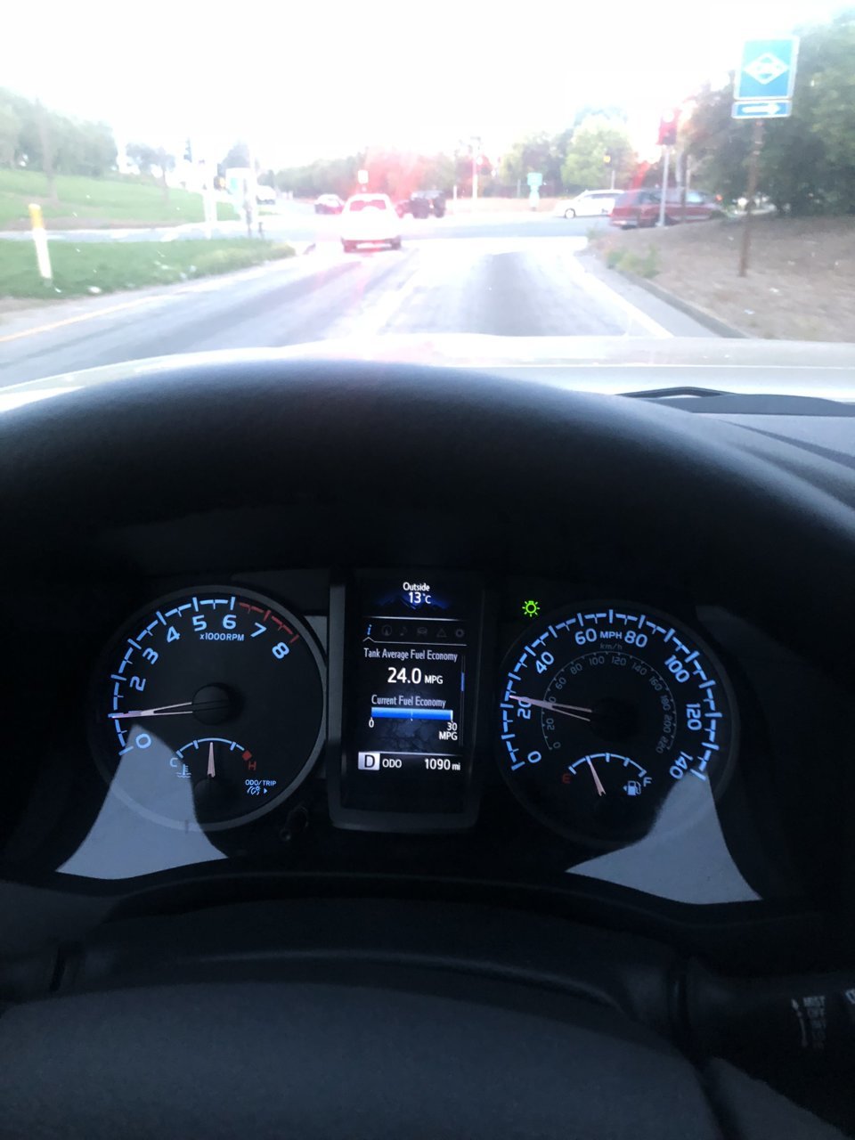

    Just a quick update I changed out my front and rear diff fluid along with the transfer case fluid from the factory fluid that had the tiny metal flakes from the break in period. Put in fresh fluid And now if I go easy on her I’m getting almost 24mpg on the highway. Idk if it’s the computer messing with me but I didn’t see those numbers before the fluid change. I would see 21mpg tops... Moving forward every car I ever get now flushing out those factory fluids will be first on my lists of maintaining it. Picture Just barely getting off on the exit ramp.

    Just a note i see you have 1000 miles so your truck is still in the break in period and your ECU is still learning and making fuel trims. Its normal to have increased mpg as you drive it more. The fluid change most likely had nothing to do with it.
