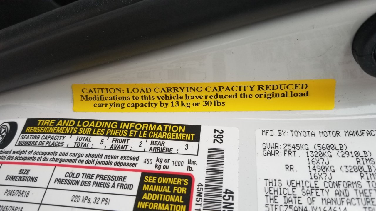

    What he said...I purchase mine in September. Had same issue. Took it to dealership yesterday because of the master cylinder recall, and had the latest TSB / ECU tune applied. Runs MUCH smoother!

    Would you mind checking under your hood for the "authorized modification" label that should have been applied as part of the TSB? If you have it, please post the Calibration ID that is written on it. Since your work order states Rev 2 of 0058-18 I'm wondering if there is a new update available...
    I believe my TSB'ed '18 has 8966304A6100 but still exhibits the surge in 0058-18 Rev 1 and the stumble in 0062-18.
    Thanks!

    I looked under my hood and didn't see any new stickers. Checked the driver door jam and saw this though...the yellow one...IMG_20190103_193720.jpg

    OK. Thanks.
    Mine is going into the dealer on Monday for shifting/throttle issues post TSB. If they find/apply and update I'll see if I can get more information.
