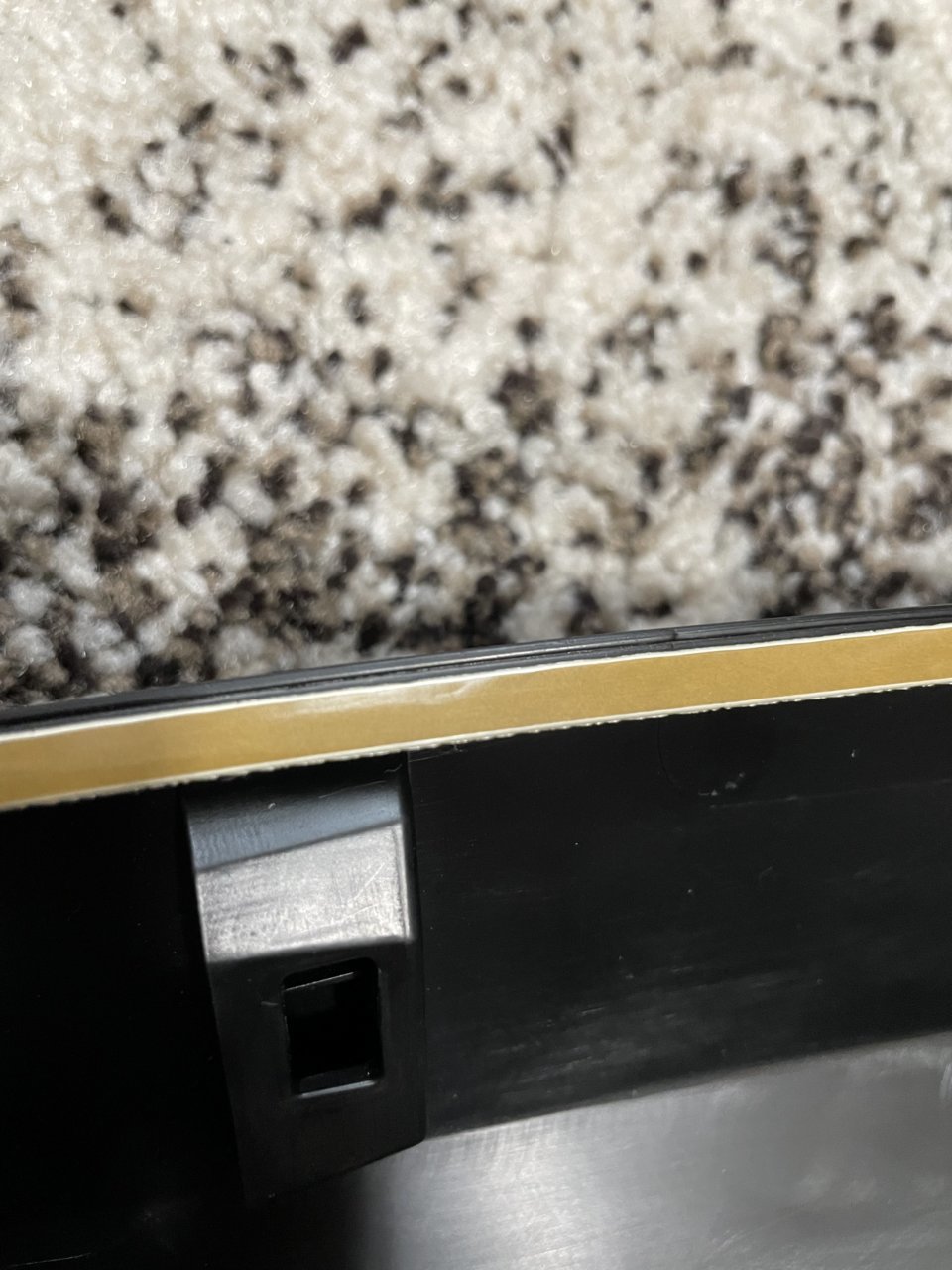

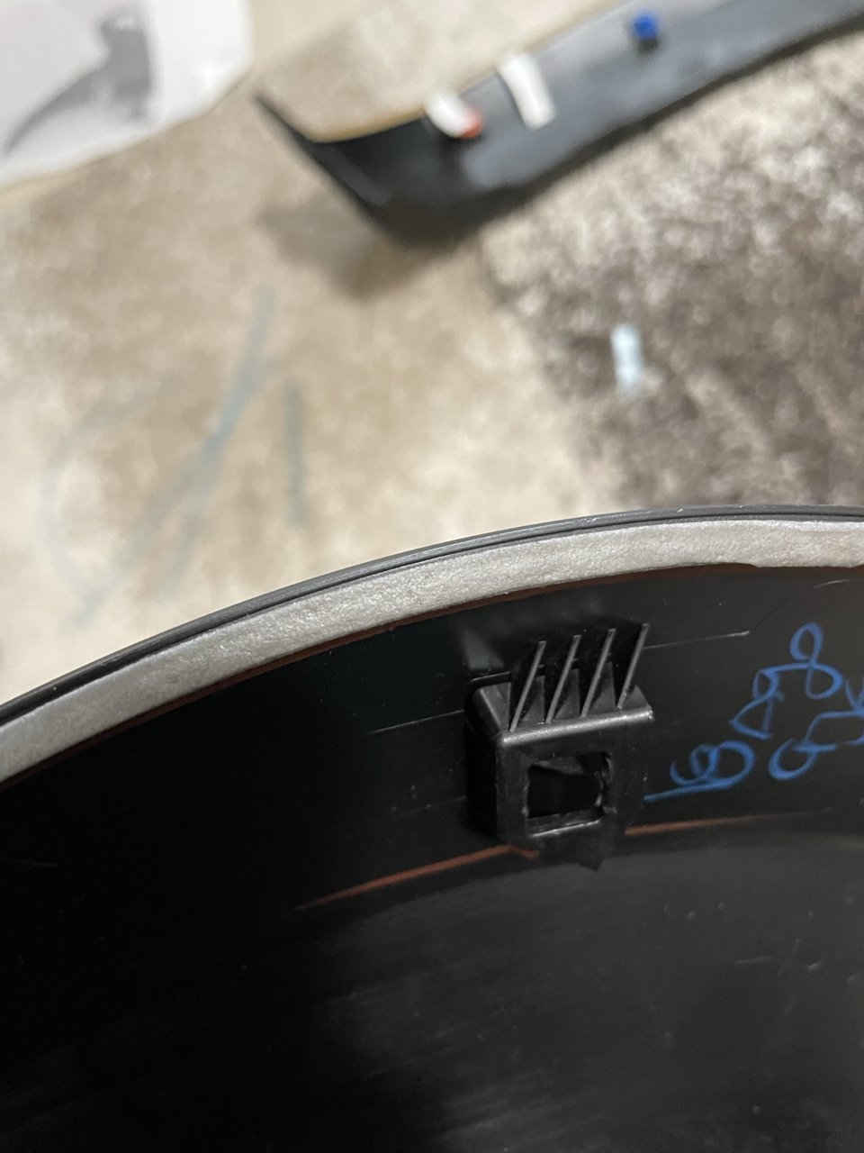

    I thought I'd give an update with the fender flares and molding pieces. I carried it to Toyota of New Bern Collision Center to have them remove the remaining adhesive and to put new adhesive on the flares and molding pieces. I have to say they did a piss poor job as they didn't get all the adhesive off and the factory adhesive they used was damaged by being folded.
    I ended up taking them off and redoing it myself. After removing all the adhesive I used the 3M Automotive adhesive and it turned out like factory new. see for yourself.
