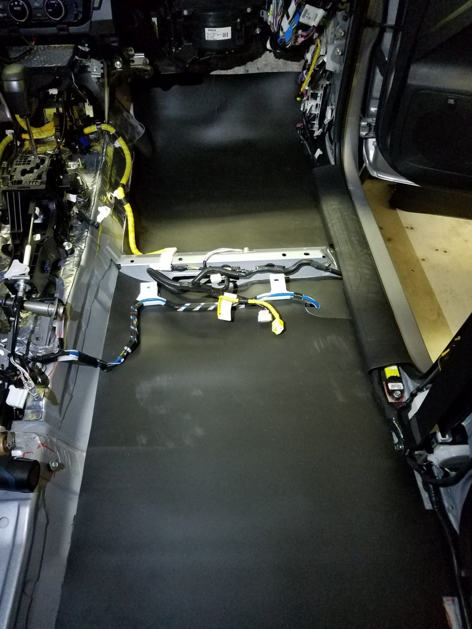

    Yeah, I've removed most of my interior. There is a sensor on the floor under the plastic door sill trim piece just in front of the B-pillar. In the back, on a double cab, they are in the C-pillar near the bottom. None in the doors.

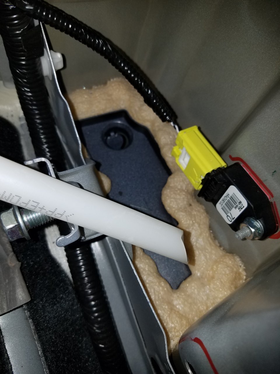

    There are sensors on the door (what you are talking about is the harness connector from the door). The sensor is located around the area of door handle towards the bottom of door. The others are correct. Had the airbags deployed, then def would have been totaled .Good luck and glad you're ok.

    I've had my head all up inside my doors; there are no airbag sensors in the doors. This is the sensor in the bottom of the C-pillar. You can read the part number... it is an airbag sensor. Pull up your front door sill trim and you'll see one just like it on the floor in front of the B-pillar.
    Edit: Sorry, you might not see it unless you pull the B-pillar trim...

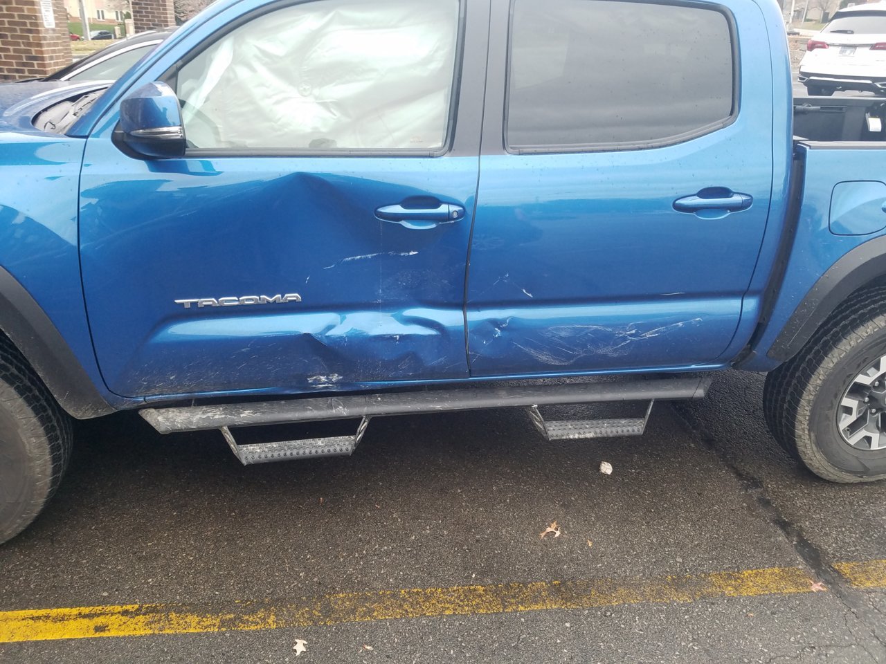

    I hope you and your boy are O.k. Unless there is significant frame damage, which I doubt, they will probably fix that especially with no air bag deployment.

    Hi there I do this kind of work it dont look to bad definitely fixable i have done worse the a pillar doesn't look bad too good luck hope you and your boy are ok....

    It looks like it took a hard hint to wheel. Could have major suspension damage, front diff damage, and possible frame damage at control arm connection. Only body shop/Ins adjuster will be able to give you an exact answer our looking for (totaled, or not)
