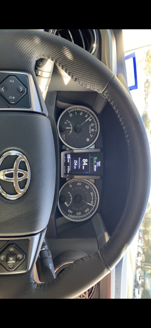

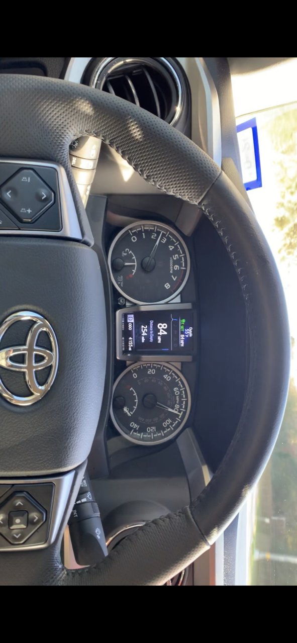

    Honestly, I'm not sure it has anything to do with the lift. I'm 100% stock with the exact same issue. I can put it in sport mode and force it to shift into 6th some of the time but generally it just ignores my up shift. When it listens i get about 16mpg, if i leave it in drive i get 14.5 mpg tops. The thing stays at like 4000 RPMs all the time on the highway and gear hunts between 4 and 5. I've taken it back to the dealer twice they tell me that's just how the tranny's are in these. Makes me wish i had waited to custom order the manual like i was originally going to. Honestly this is the only thing about my Tacoma that really bugs me. Coming from a 9mpg wrangler TJ, 14 IS a step up,but its still nowhere near the advertised mpg. ‍♂️

    In addition to the suggestions above, slowing down will help. This truck has the aerodynamics of a brick and it doesn't have the power to pull you along at 84mph (87.5mph accounting for your tire size) at low RPM.
