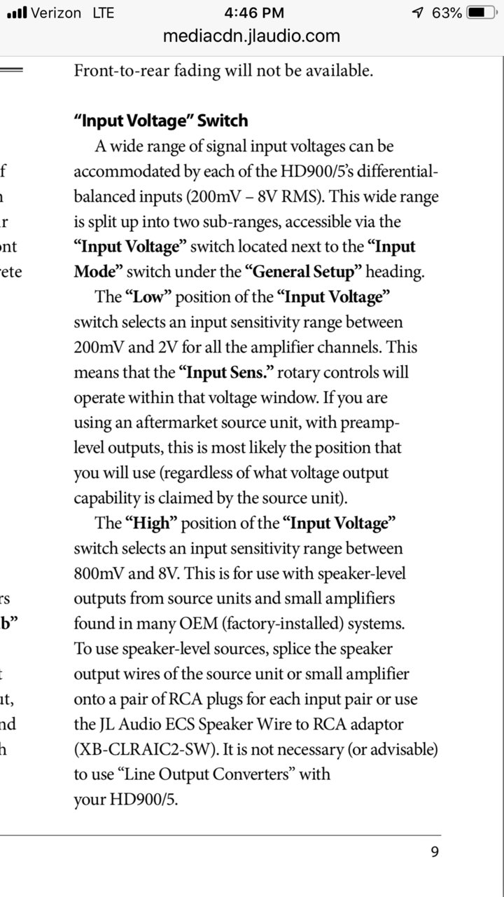

    Thank you, I do have 1 question, You mentioned that u didn't use a Loc with your setup, could I have been better off without the Lc7i with my Jl 900/5 ?

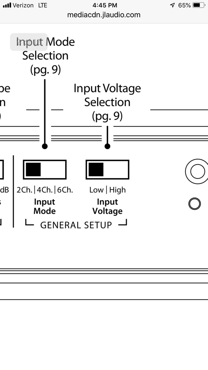

    I wouldn’t say better off. Just don’t need it. Read through the manual on the JL amp. If it’s like mine, it will have language about not needing a line converter since the amp has a built in high level or low level input switch. As long as the amp has this feature...you don’t need the Lc7i converter. Non-JL people might read and disagree...but only because they must not know JL. I went over to the HD 900/5 and pulled these screenshots. Read the last sentence.

    Oh wow, I have the manual and I must've missed that part. Ok well the Lc7i is hooked up now, I might make the adjustment of taking it out momentarily to see if I can tell any differences, thank you sir:thumbsup:

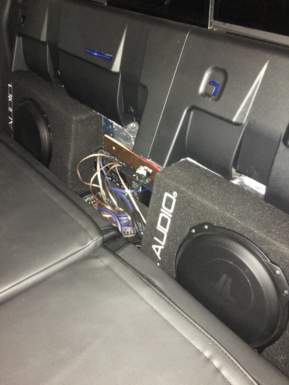

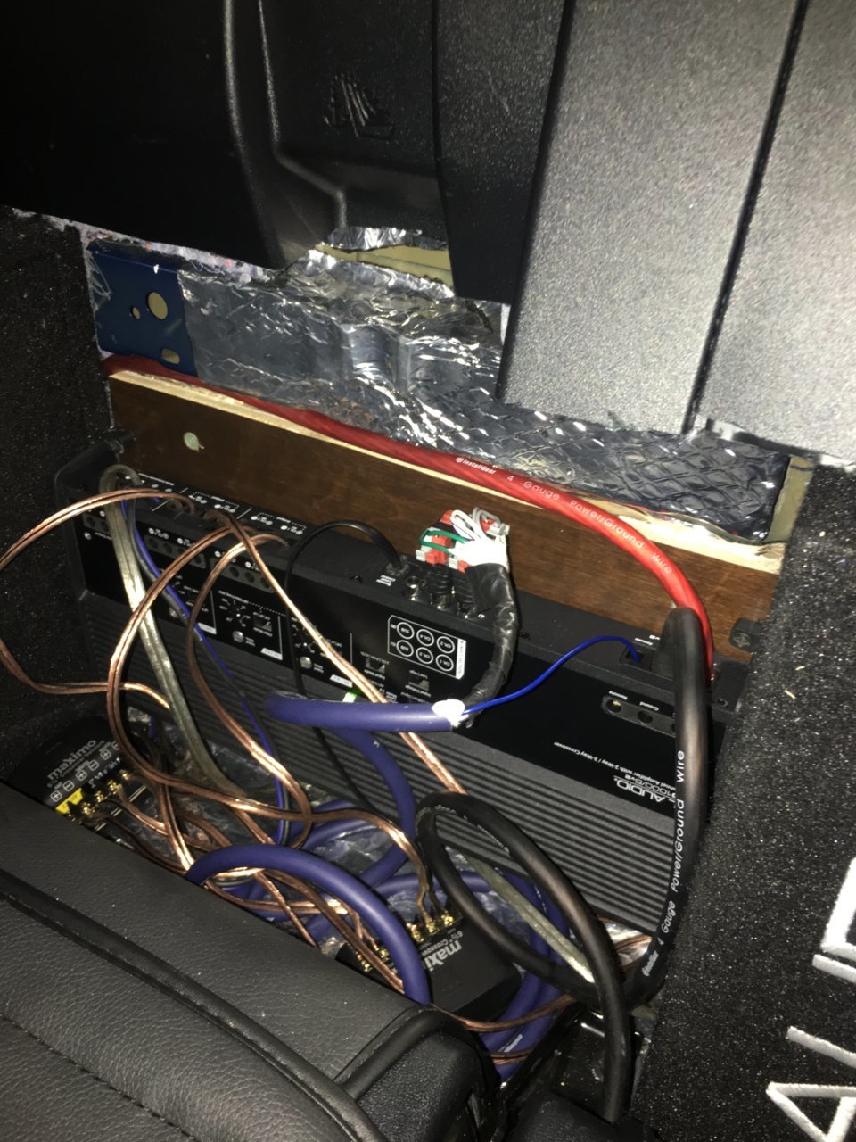

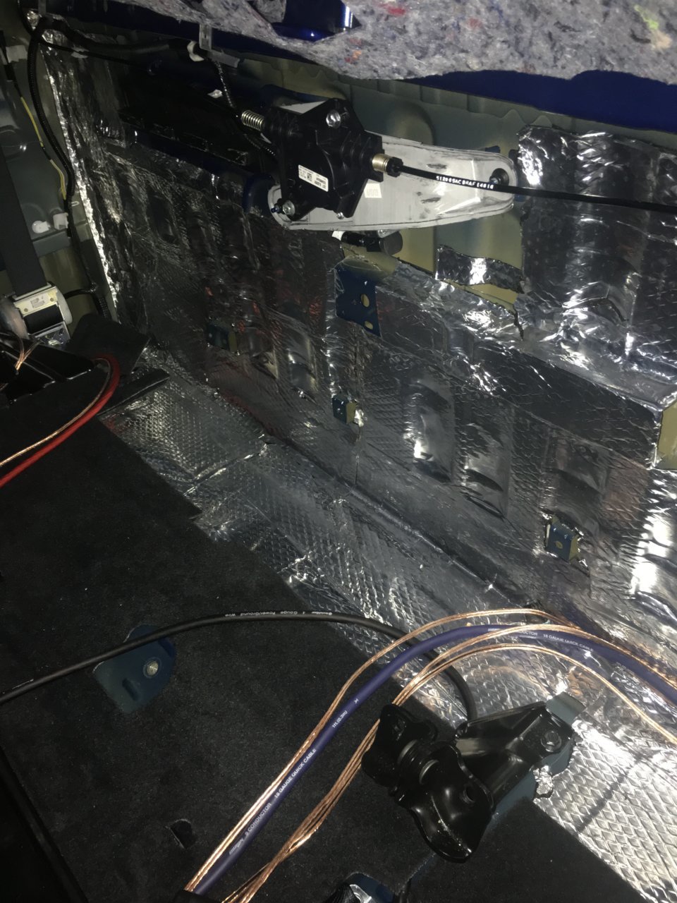

    9054159F-8C6B-465B-B47C-024C595D9AB2.jpg Super happy with the subs. I do not always love my front morels...it’s hard to explain but I just don’t like them on all music. Just not crisp enough sometimes. Enough that I’m considering replacing them.
    I ended up making a small wooden mount for the amp between the subs to kee everything tidy. See pic.EB7C4DD0-C677-4464-A0CA-220E5989D6D9.jpg

    Did u need to cut it. Or it was an optional for more room clearence ? Would it fit without cutting the metal off ? .. TIA

    To fit the speaker boxes I did HAVE to cut it. They would not fit without removing those cross members.
