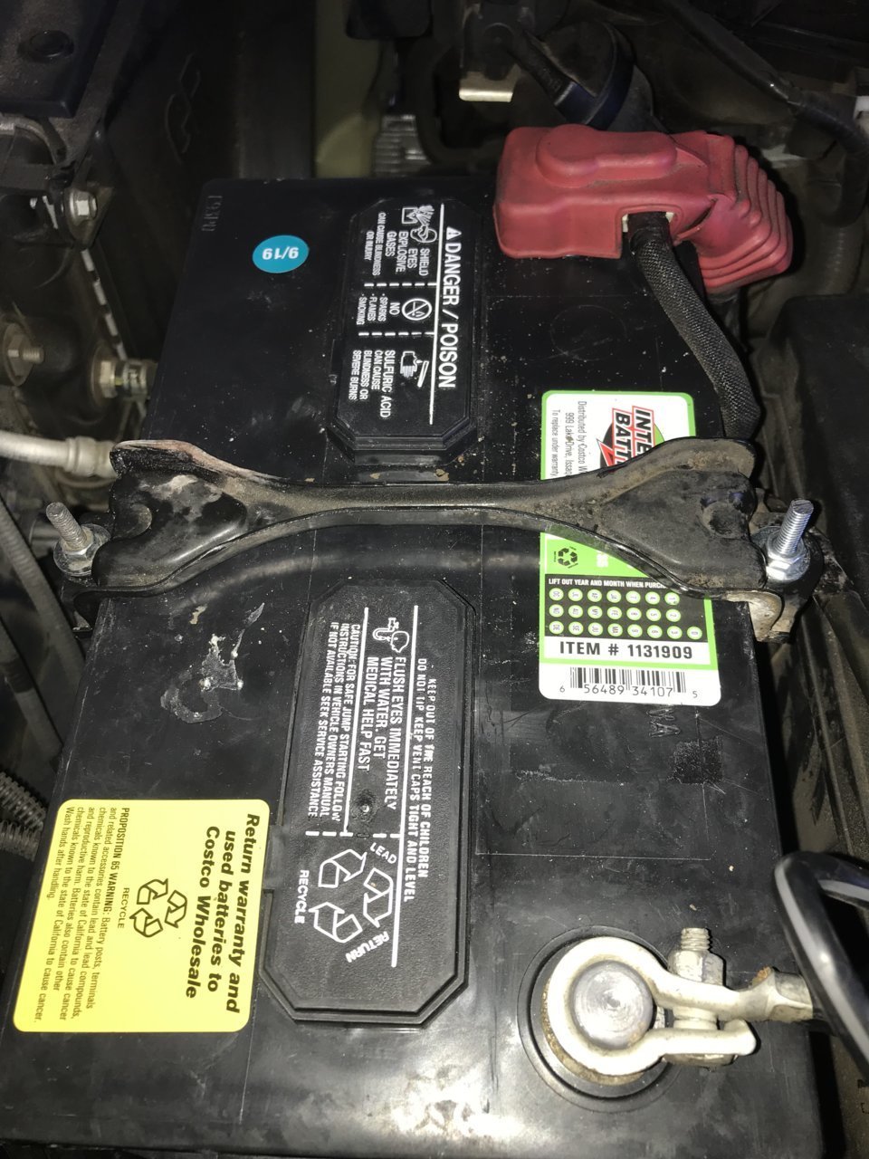

    I modified my 2017 to use the 27F
    shakerhood and BillsSR5 like this.

    Battery Tray from a 2nd Gen with Tow Package.

    I cut the edges off the plastic tray on the bottom and I used two j bolts to hold the battery down.
