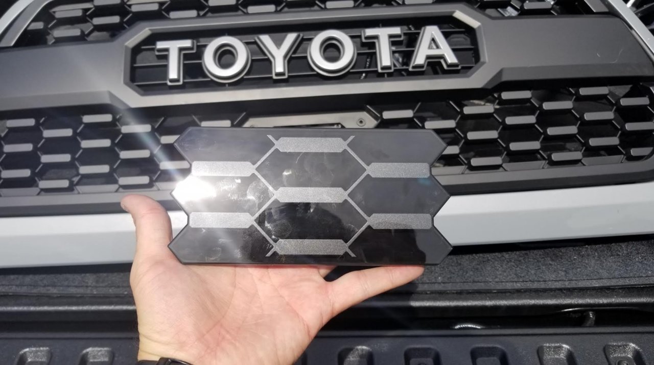

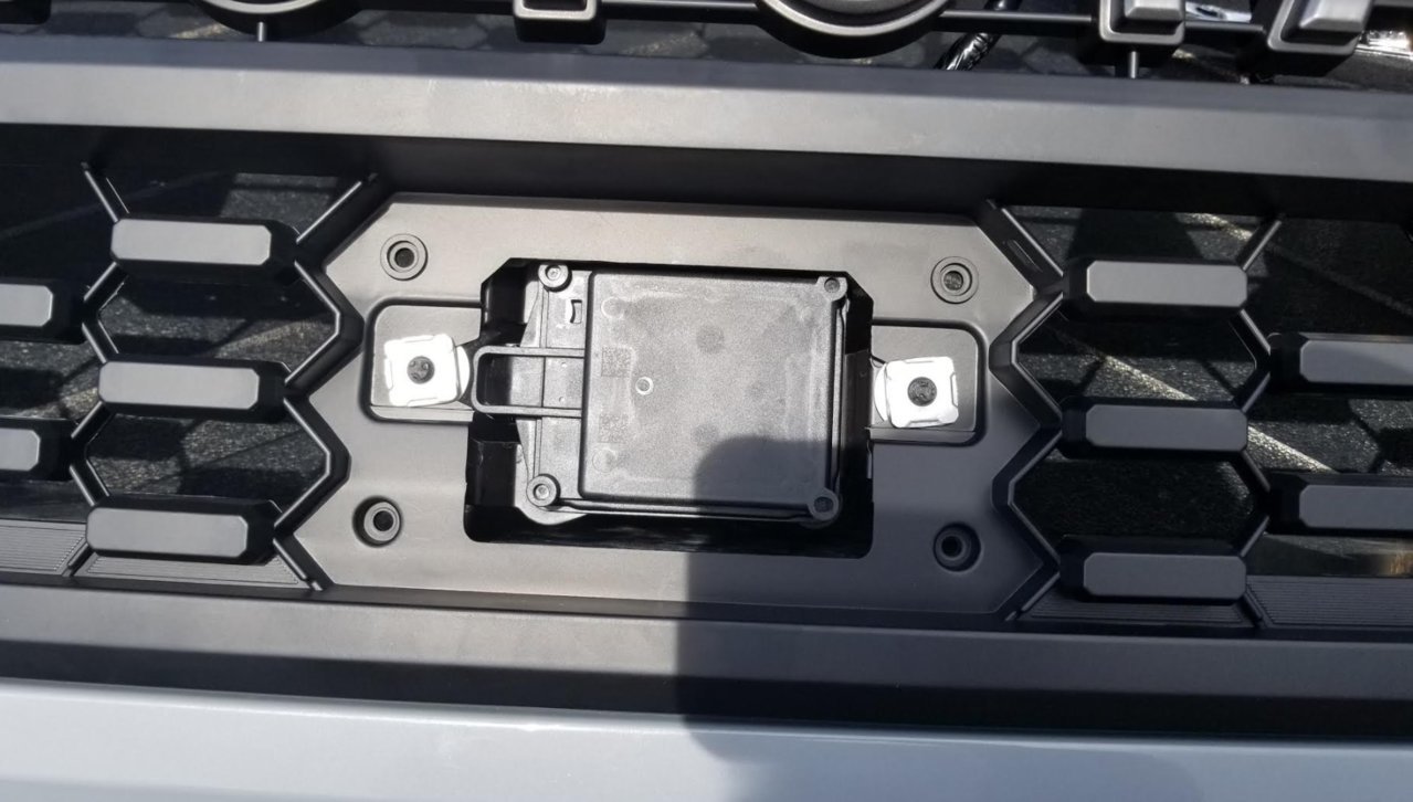

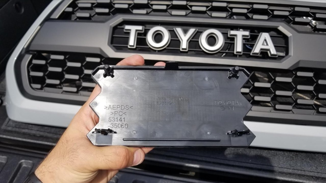

    I ordered the OEM garnish PN 53141-35060 and it is NOT flat. I need to modify it and probably double sided tape it to work with the grill we picked up on ebay for $120

    18 Inferno Sport DCSB 4x2
    Thanks for the picture. In what way do you mean that's not a flat piece? Looks pretty flat to me...
    As for your mounting situation, it actually looks like you have the same ebay grill i do (4 screws to remove the 16/17 garnish replacement holder). Based on that picture, It looks like the top mounts for the spring clips will line up, though you'll need to probably drill out the screw holes so they're larger. For the clips on the bottom corners and top center, dremel some cut outs?
