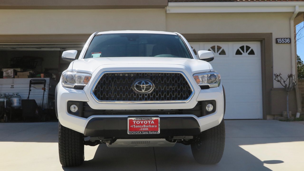

    Well to kill this grille thing for me. I got the final "Can't do it" from my last dealer on selling me a 35180 so I just went on with buying the OEM 35170 from Amazon. Put it in yesterday and used the original wire harness with no problem. Used the first factory clamp mount and moved the wire harness right down the grille line of the old ones ...Just used two new black zip ties on the same spots. The "star clips" were a P.I.A. to remove from the new 35170 fascia and I ended up cutting them off with the dremel tool.
    Whole deal ended up costing me more then 2018 grille would have but I ended up getting a 2018 garnish for free so that helped on the $$ total. It's all OEM and I preferred doing it that way. No radar malfunction yet and I'm lifting it this weekend so I'll wait till that's complete to see if I get any abnormalities out of the system.
