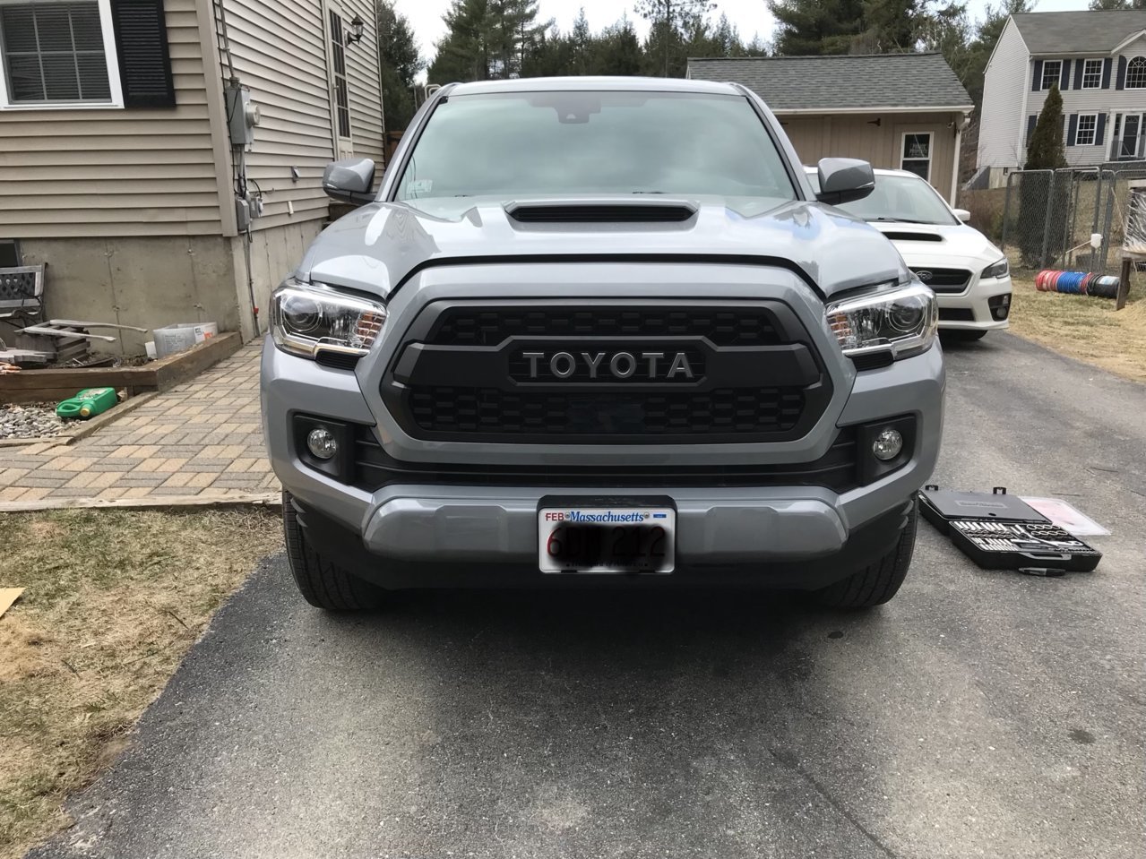

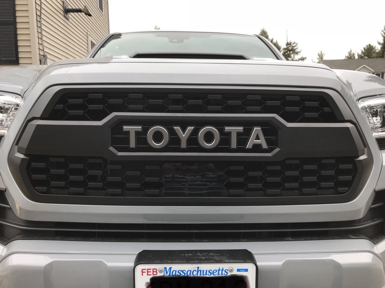

    Purchased grille on eBay. Modified Toyota garnish - cutting upper standoff’s and drilled for screws. Cut garnish lower tabs and mounted standoff’s for screws.
    Thanx for everyone’s input on this thread. Came out awesome :thumbsup:

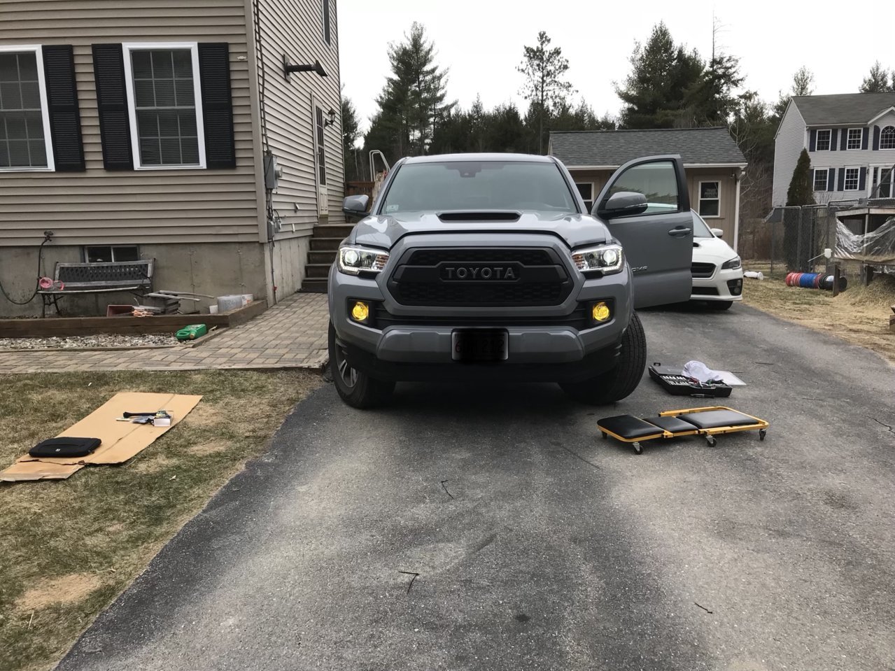

    Hey, I hate to be a dumbass, but just want to make sure that the eight Philip’s head screws that hold the chrome trim don’t go back in, correct? The only thing holding the grill are the snap in tabs, correct?

    correct no screws , I looked like 5 times before snapping it together thinking how is this going to hold but its solid.

    Thanks! Yea, it went back together pretty smooth. Then I look over and see all these screws sitting there and I’m thinking WTF are those?
    The garnish isn’t as snug as I would like. I used some push on units from Ace, but couldn’t get it factory snug. I had to cut the factory ones off. Hopefully, it won’t rattle.

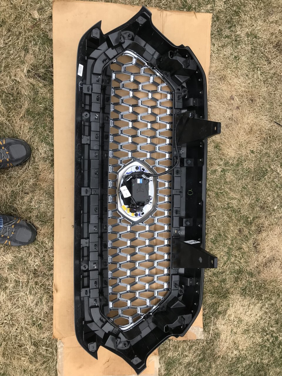

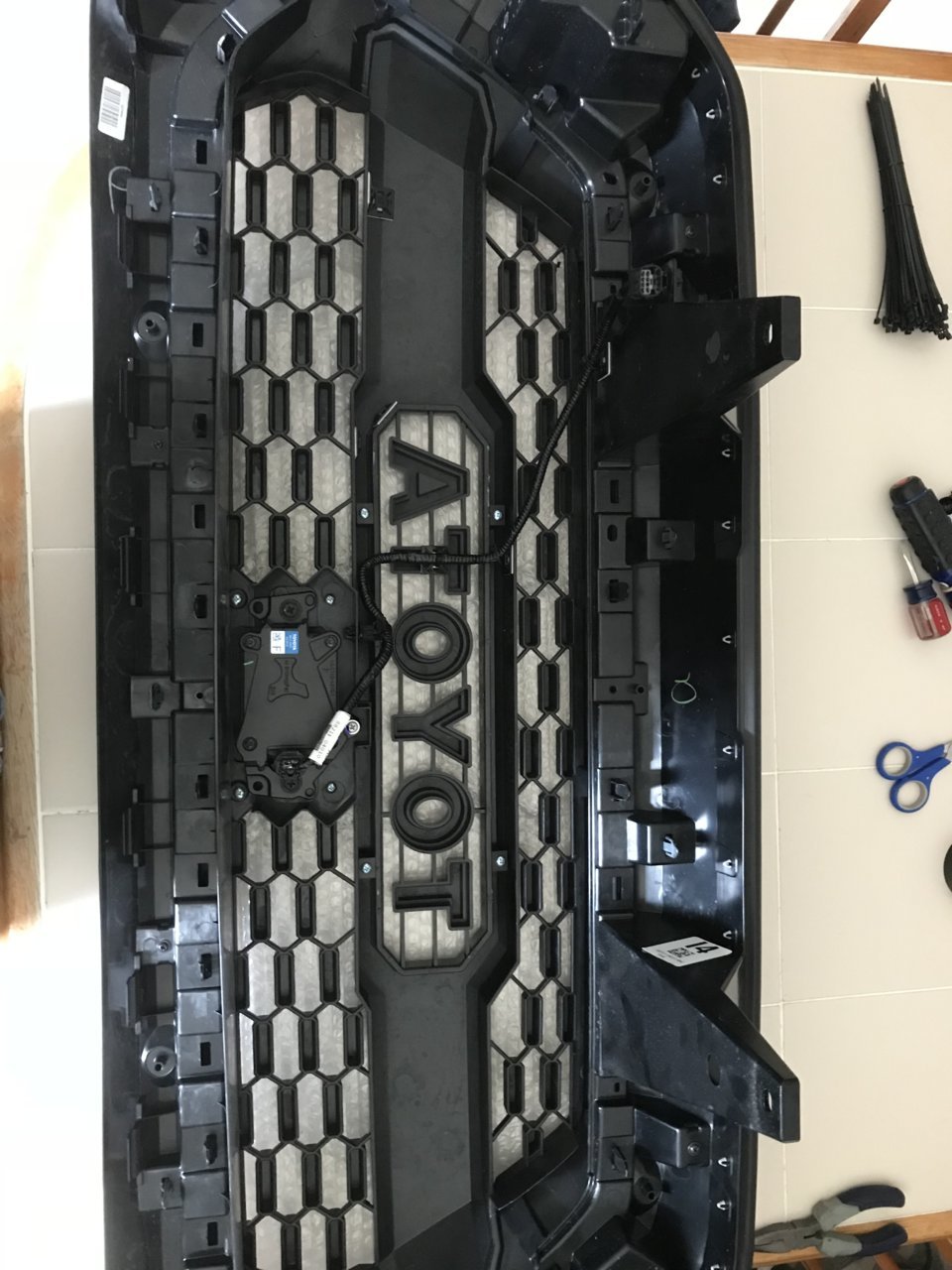

    Got my eBay special $134 bucks delivered from bruceshark-001. No prob painting the outer letters flat black and epoxying them into place. Picked up the OEM garnish $53 from Conicelli Toyota website along with the longer connector wire for the radar $25 Part#88214-04020. Used a Dremel to separate the non-radar cover from the grill. Used OEM emblem nuts $8 90183-06044 from Amazon to secure the garnish on the grill. Now waiting for the longer cord to install it.
