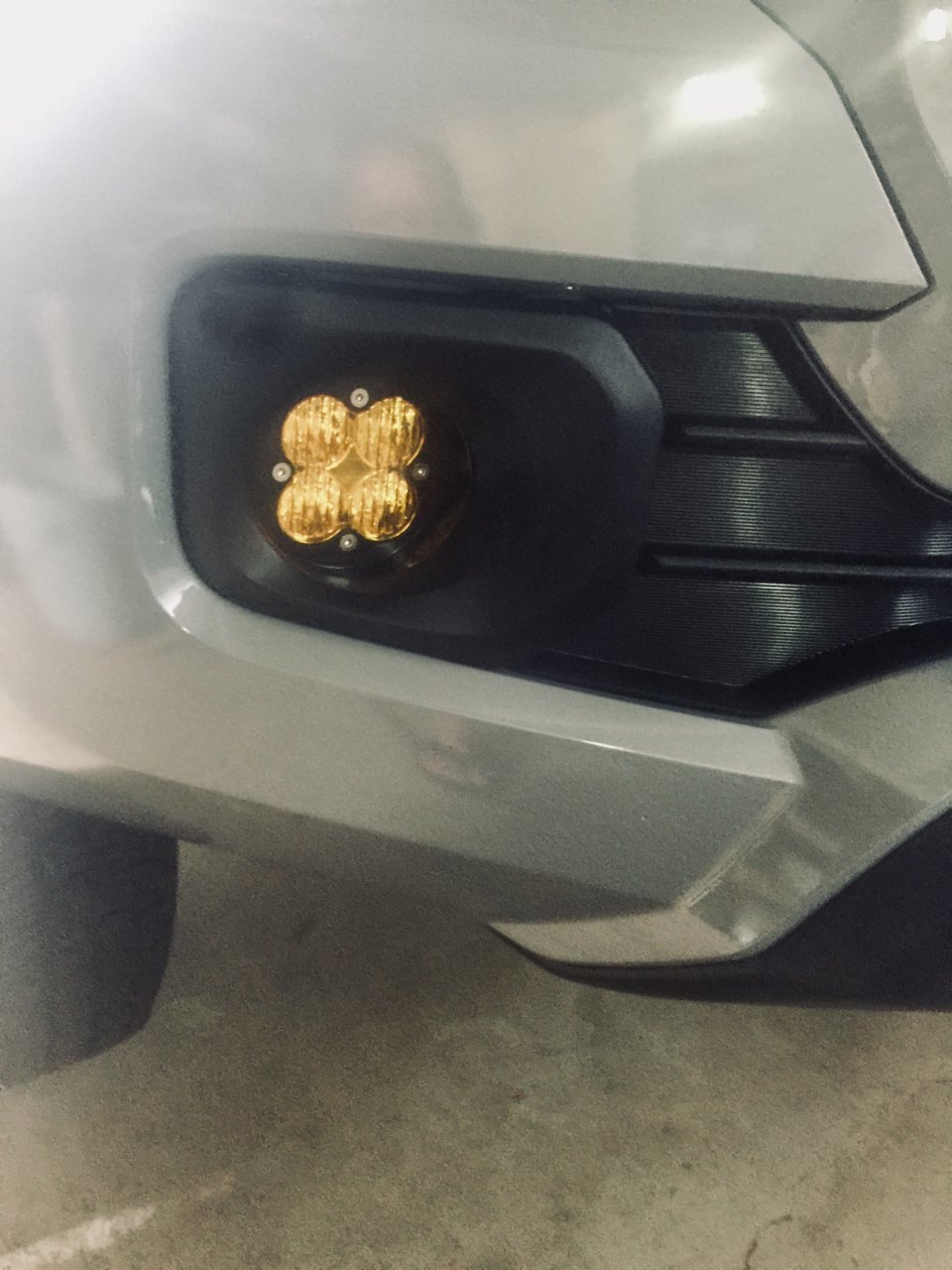

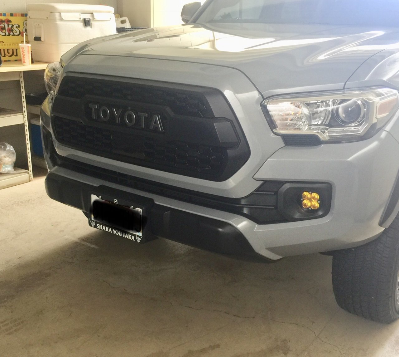

    Got the grill, fog lights and fog bezels up today. Ran into issues with one of the HID bulbs so I couldn’t complete the black headlight install. So far no errors on the dash. Way easier to install the fogs by removing the front bumper.A9C2921F-E362-4822-B666-12E9EE5B9EBB.jpg 46504457-1931-4A3E-910D-D6970A69613E.jpg
