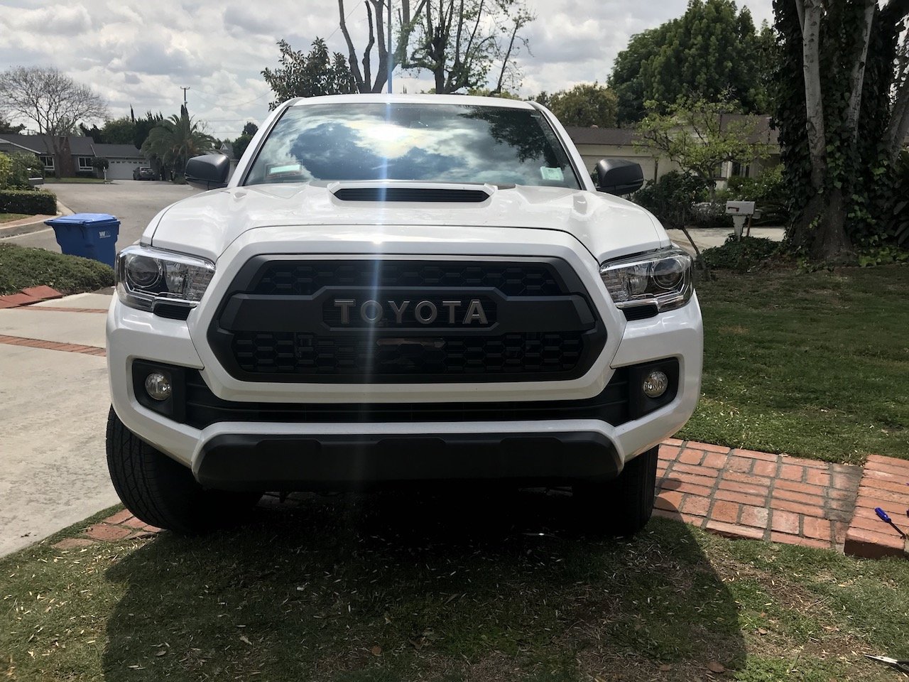

    Yes the little lip that covers the bumper. On the sport models, they’re painted to match the factory color, however I swapped it with an OR matte black bumper.

    I don't know if you guys are just going for a different mod setup or something but my 2018 OR swapped to the Pro Grille with no need for the longer cable, my cable is almost too long I had to zip tie it a few places.

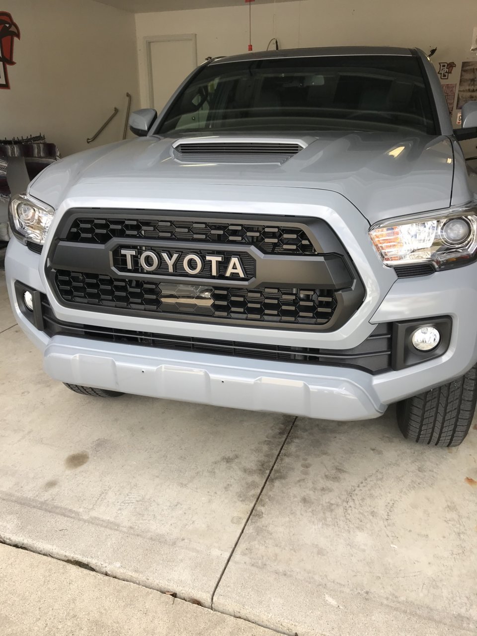

    The biggest thing to look out for is that the chinese grill that you bought should have slots at the bottom to accept the OEM garnish piece. Some of them just have holes at the bottom where they're screwed or melted on. Those will NOT fit the OEM garnish piece. Again, a link to what you bought should confirm.
    I have a pic somewhere of my chinese grille and OEM garnish but it's on my phone. Maybe I'll upload later! It works, and it looks good.

    Here's the item number. 302693428094 . I already ordered the factory garnish. I just want it all to match color wise. If not I think I have the 35180 grill from someone . I'll just Craigslist the Chinese grill if I need to. And thanks Tacoma1818. Love to see the pic.

    632
    Best I’ve got right now!

    Very Nice. Exactly what I wanted to see. I'll hold off on the factory grill that a lot more. I'm sure the one that's coming will be fine. And Thanks. I'll post a pic this weekend after my install.

    The reflection of the garnish in that particular pic makes it look pretty bad (and makes it stand out a lot). From far away, or not at that kind of angle, the garnish looks fine. Matches the knockoff grille perfectly.

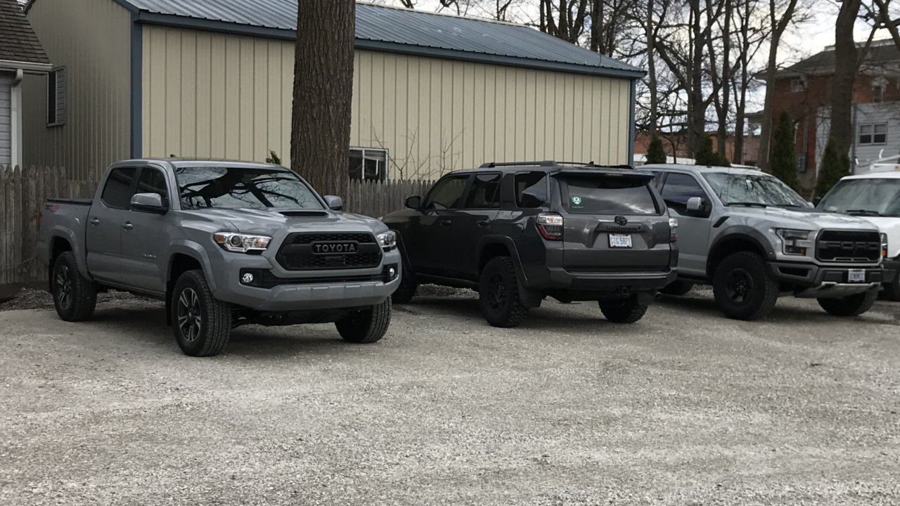

    Here’s a further away shot. This is from when they threw down more stone in the parking lot of the local nano-brew (which is in the back of a storage unit, speakeasy style). Of course the regulars are prepared for the added terrain hahahahaha
