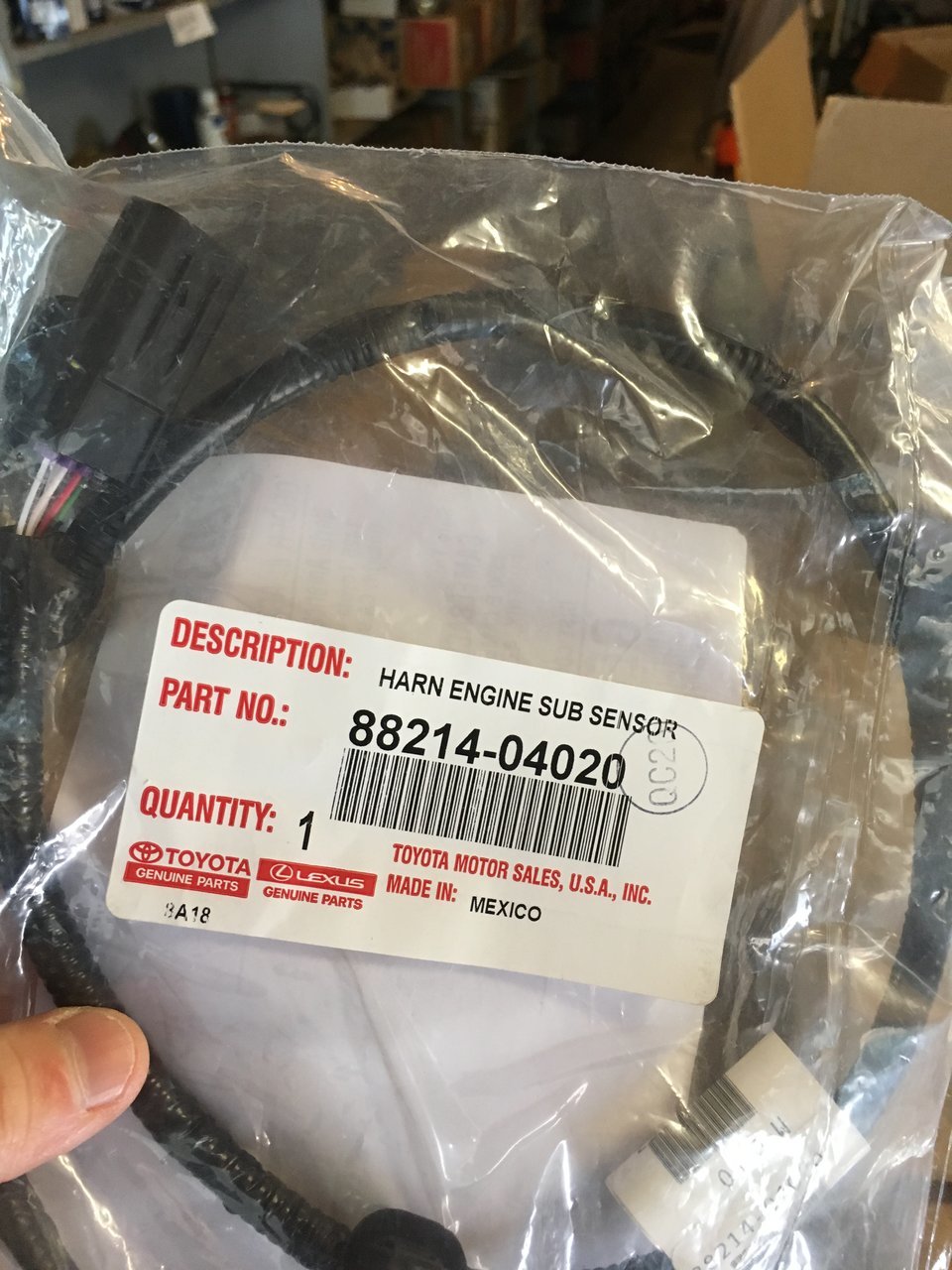

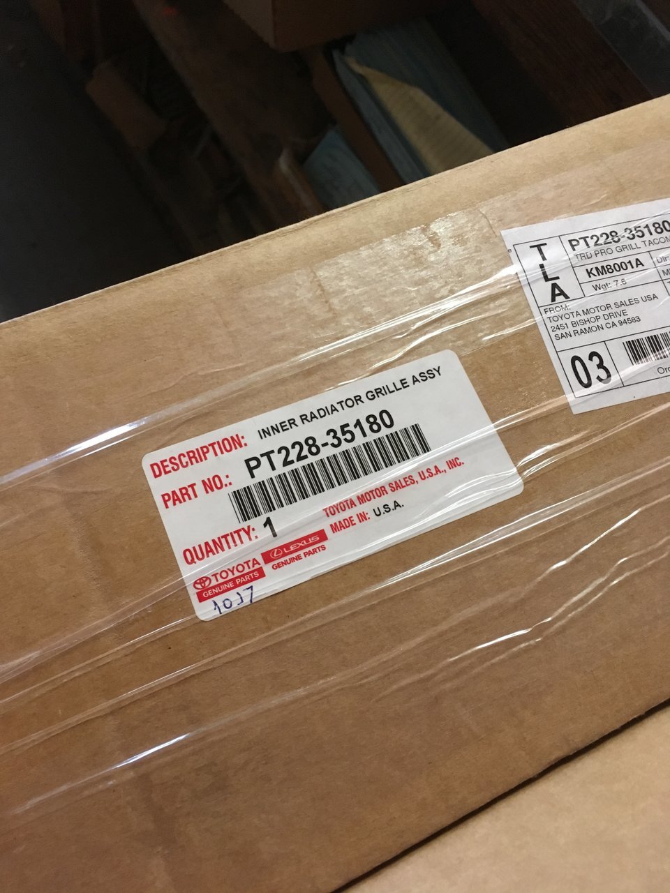

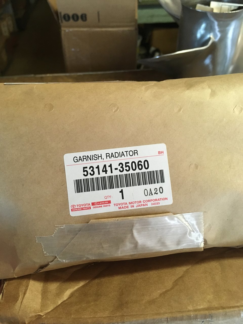

    This is the pro grill for the 18 without The panel, the garnish use the TSS sensor, and the longer wiring harness. The push clips to secure the garnish will be in on Tuesday. All parts were purchased through Camelback Toyota from our member here @gunny1005. Total shipped for all items shown was $249. The two push clips to secure the garnish are $.74 each
    90183-06044 Is the part number for the push clips

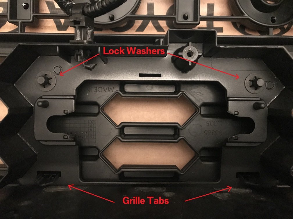

    How do I remove the lock washers from the insert on my 2016/17 Pro grille? I'm getting my 2018 Off Road tomorrow, getting the garnish on Friday so maybe I can do this project on the weekend. Can I get the washers off without destroying them so that they are reusable? More importantly I don't want to wreck the insert which I intend to keep for just in case. Thanks.
