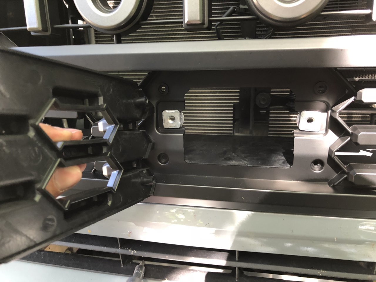

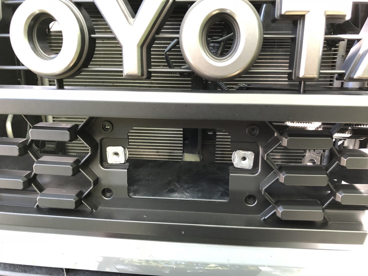

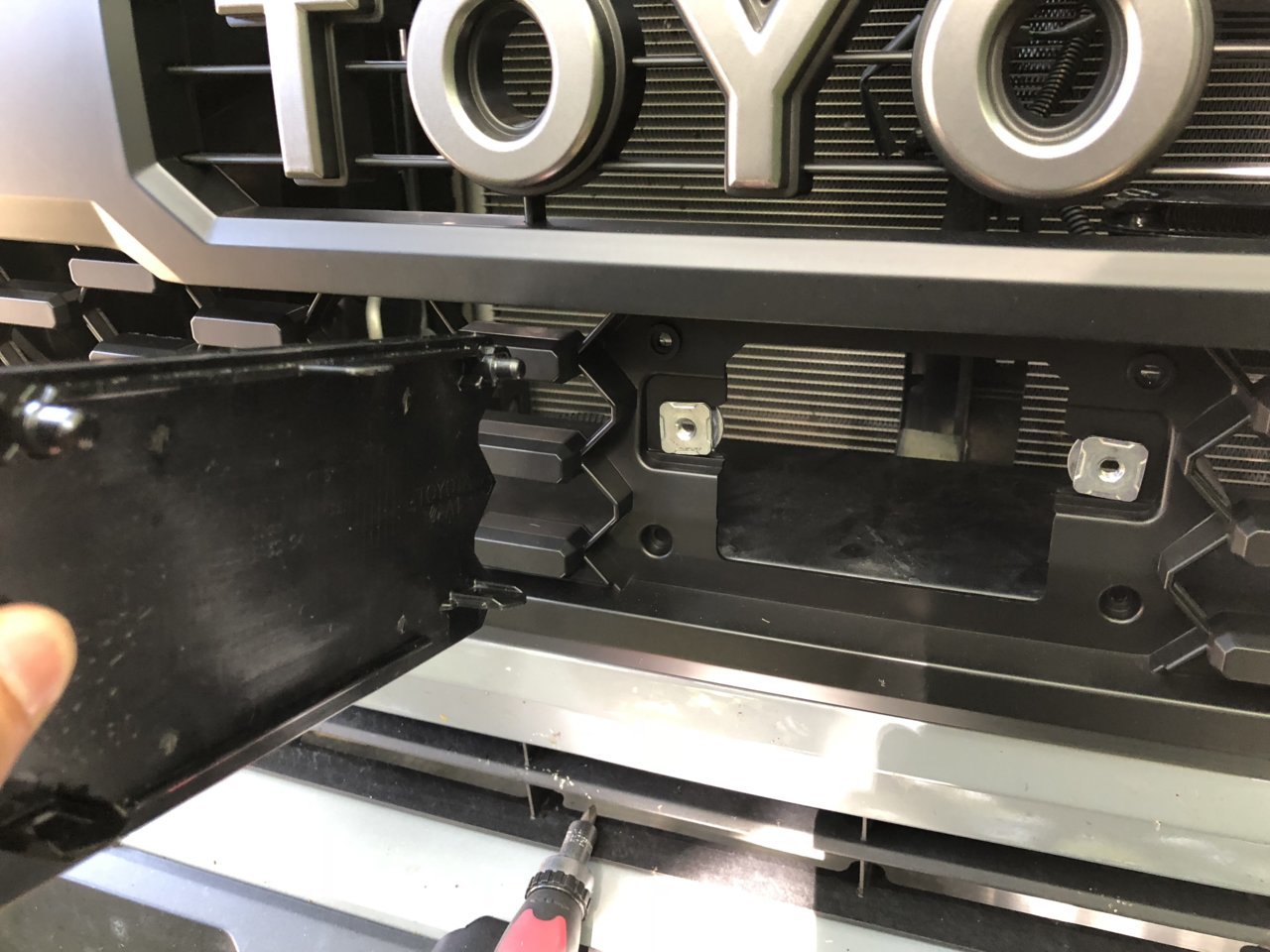

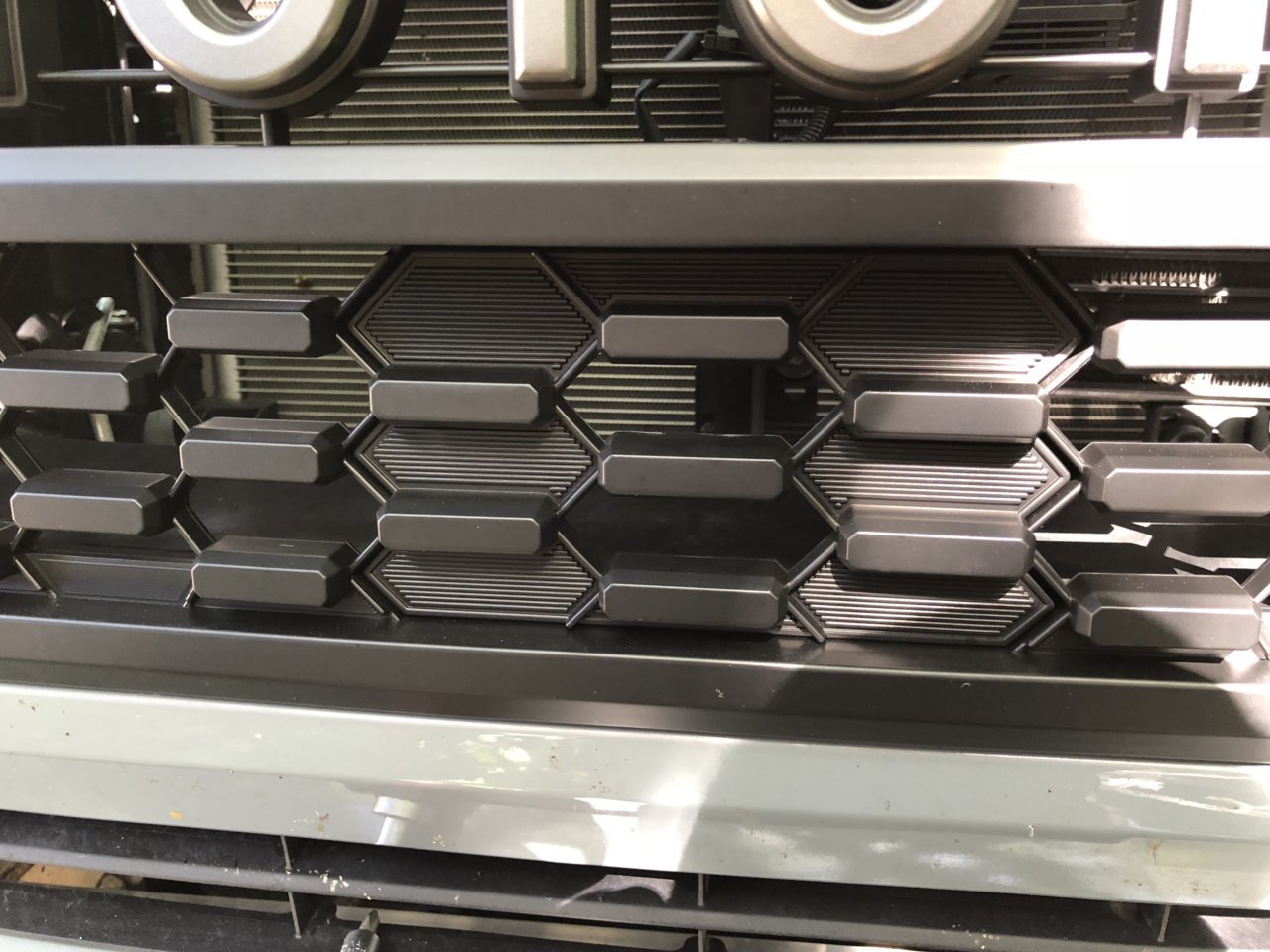

    Ordered chinese knockoff grill. Install was super easy. It came with the cover/trap door over the sensor area. Drove around for a bit, kept getting the error message. ordered the garnish. Just went to install it and it looks like it uses push tabs/clips but my grill has screw holes. I thought I ordered the 2018 grill. Maybe I messed something up.
    Should I just cut off the tabs and like, epoxy it to the grill? I'm slowly reading through the 22 pages of this thread but haven't seen this exact scenario yet...

    Just put a piece of plastic in front of the sensor. The grille doesn't have the slots for that garnish. You could try heating up the grille and cutting in slots that fit the garnish...

    @morebetterjd i would just drill out the two holes on grill for the upper attachments of the garnish and then epoxy a small piece of plastic on the garnish itself where the screws would go then drill from the inside. Go over to page 16 of the thread, a dude named @joostin420 had the same grill you had and has an 18 as well, and he managed to do it. Maybe PM him?

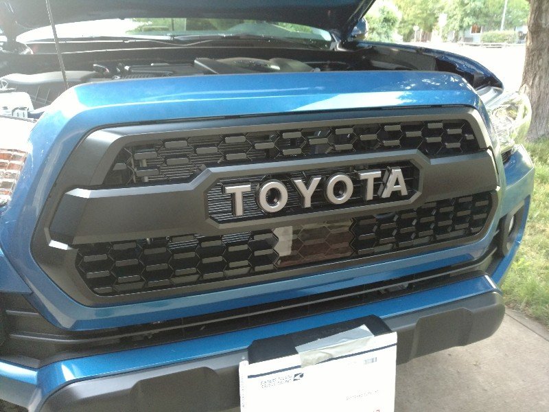

    Grill and nuts arrived. Had the garnish . Looks great. China grill that was working fine out. New one in.....IMG_20180509_195307339-800x600.jpg

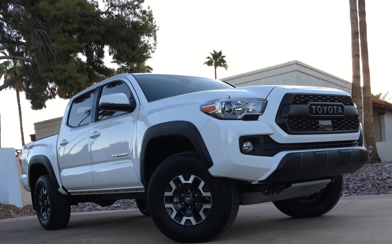

    Installed skid plate and Pro Grill w/ garnish last night... I got it off ebay...all OEM- seller even included new starlock washers. Used the longer harness for clean routing. Easy Breezy. Drove it around and all electronics seem to be in working order. Total time for everything was about 1.5 hours.
