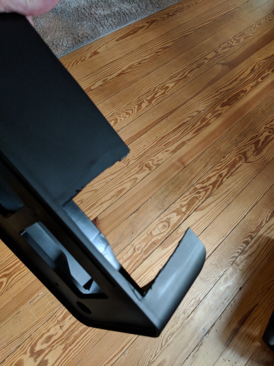

    upload_2018-5-22_6-44-9.jpg Over the 2 holes where the radar goes (on the inside). I put a link for the glue that I used in the post above yours.

    No holes drilled. I'll take a picture of the back of it when I get home.

    It’s dirty but there it is. You just glue the Kydex to the back of the grille.
