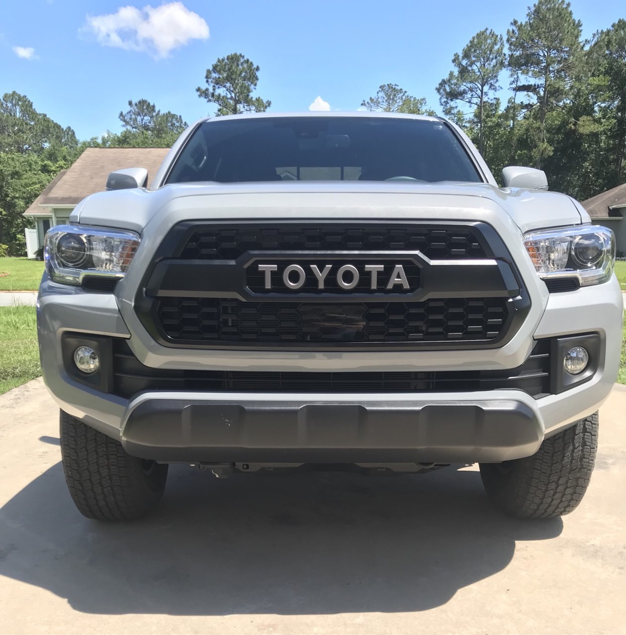

    I installed my OEM 2018 Pro Grille (80 not 70) today! I used the OEM Garnish and 2 Star/lock washers. Broke a couple tabs on the old grille when I was taking it off but otherwise the process went smoothly! The washers were tight to put on over the garnish so I used a pair of pliers to stick through them to widen them out a little more. I was kind of in a rush so I didn’t get to take pictures of the process but the OPs pics came in handy and were helpful!
