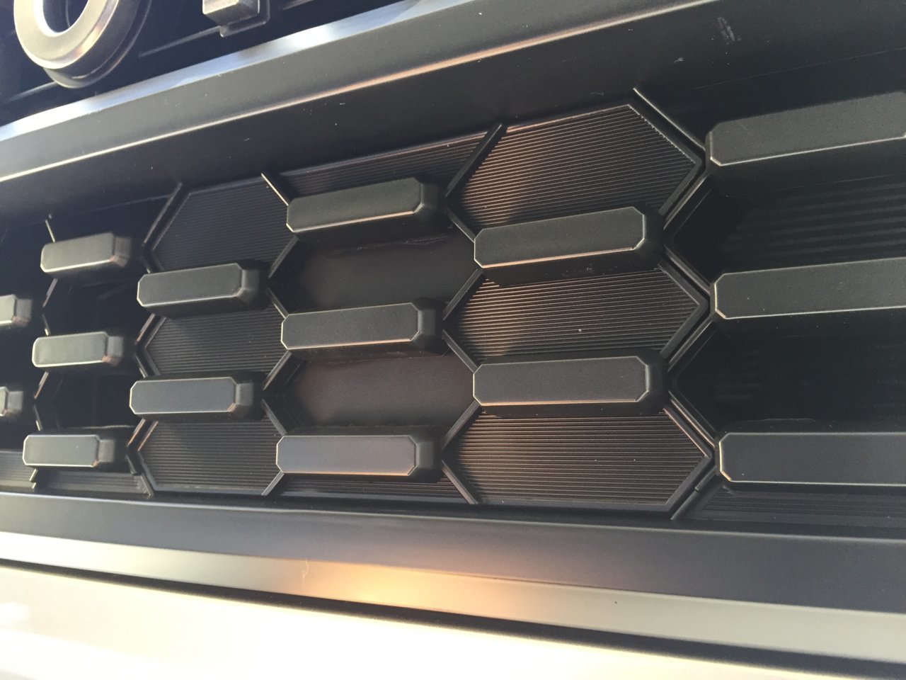

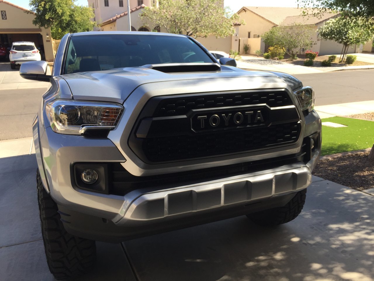

    Just put mine on. A China Pro Grill for a 2018 TRD Sport. I didn’t want or use the OEM Garnish because I didn’t like the look. I can confirm everything works fine. Thanks to @Sixt8kupe for the idea.

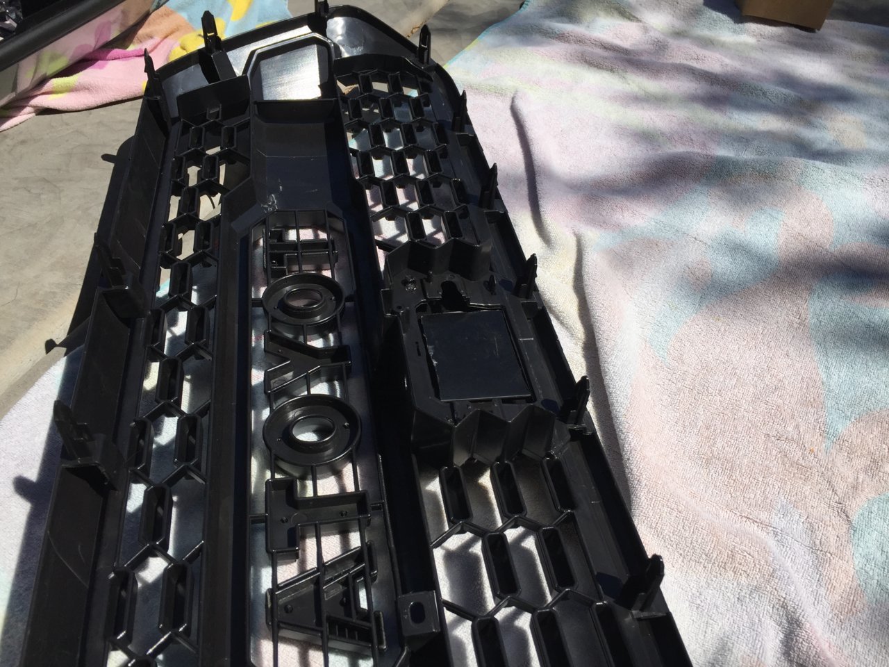

    I received the one piece grill with the stick on letters.

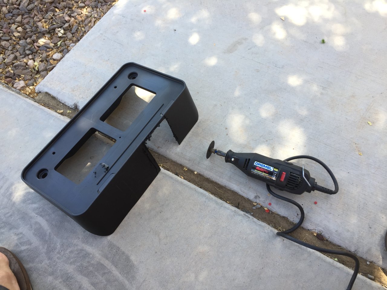

    I decided I didn’t like the look of the seperate garnish for the radar so I cut a piece of the plastic off of the factory license plate holder that came with the truck.
    I then glued with a strong adhesive then sealed with silicone.

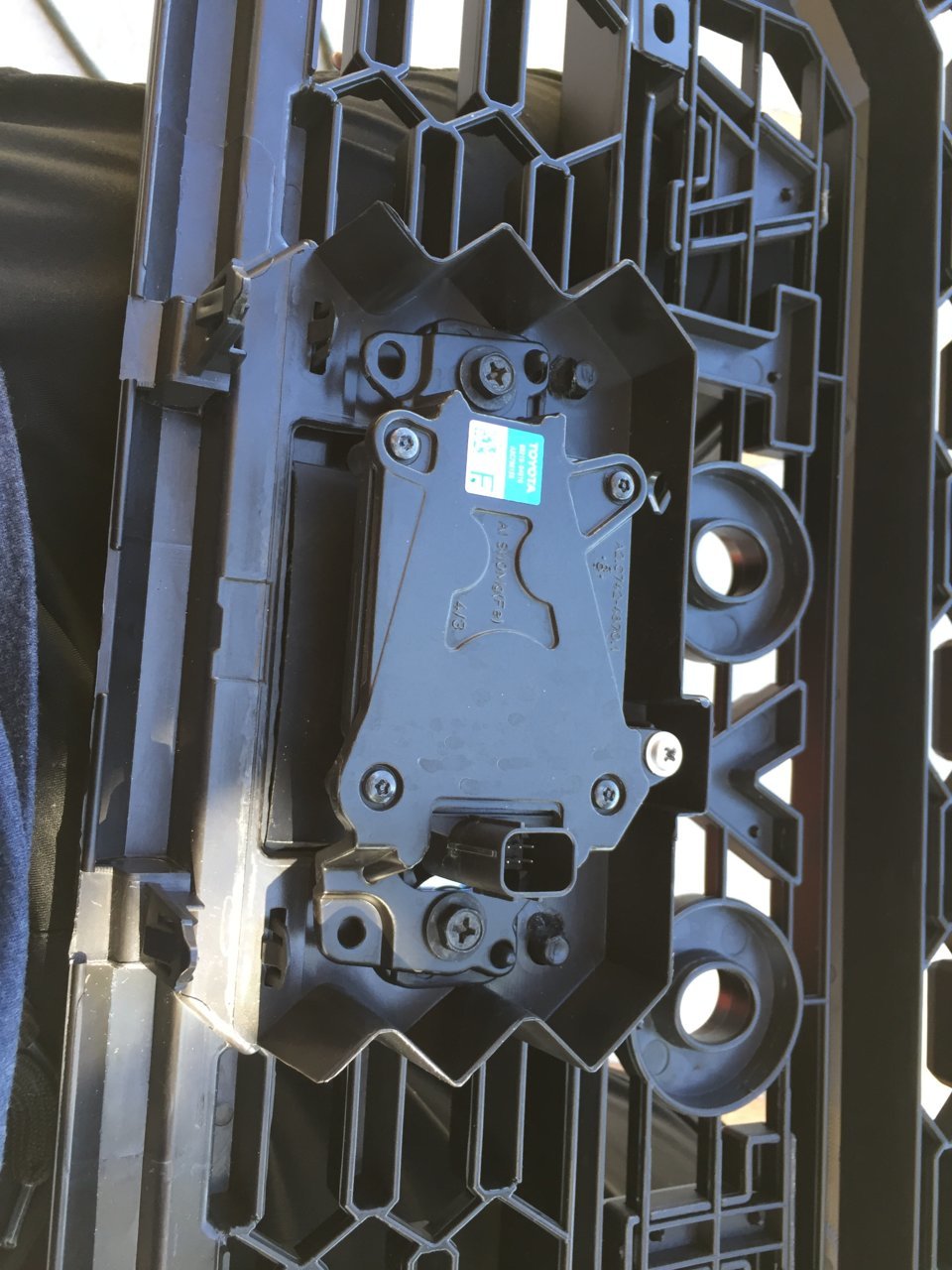

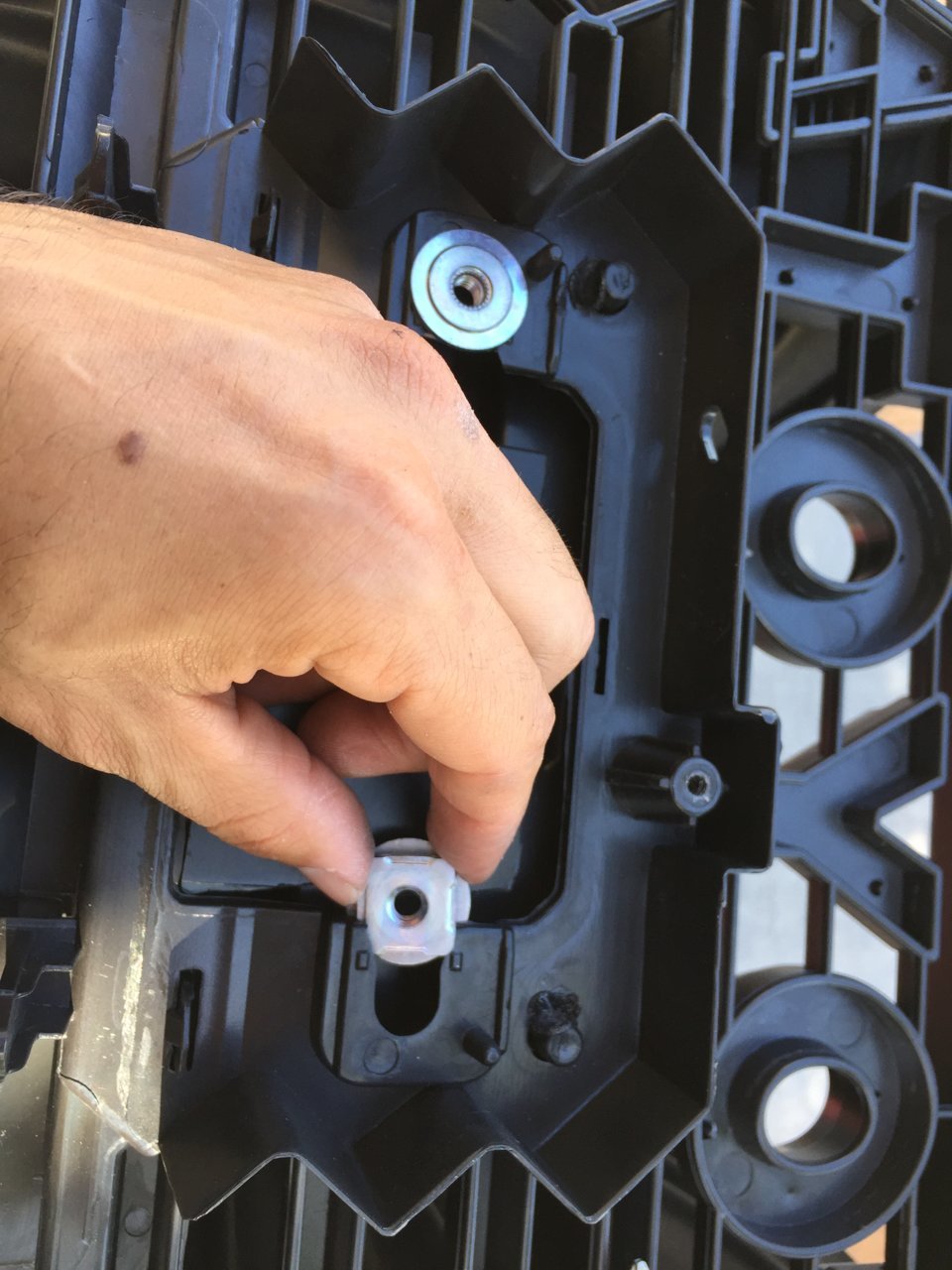

    I then attached the square nuts/brackets that came with OEM Grill into the China Pro Grill.
    Then attached the radar sensor with the OEM nuts and screws.
    Front of the grill where the sensor sits.
    I can confirm that the radar works fine and drove it all afternoon without any issues.

    I like it. I wished I’d seen this before I did mine. Much cleaner look. Nice job.

    Looking extra sharp and no shiny garnish! I can't take credit for it, I got the idea from somebody on here but don't remember who it was or which thread I saw it in. :cheers: to the unknown member.
