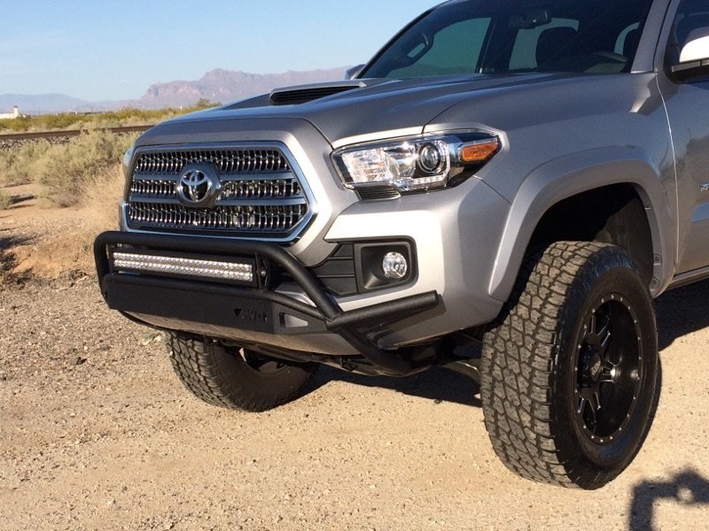

    What is everyone’s thoughts on the pro grill having any conflicts with the look down angle of the cross bar in this bumper guard.
