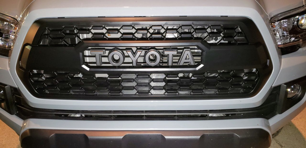

    After putting in a faux Pro grill and gluing plastic in front of the TSS module, I took mine for a drive testing out the adaptive cruise and it kept the distance appropriately. However, has anyone tried to test the PCS after installing the Faux Pro grill with the ghetto garnish?

    PCS worked as it should for me after the plastic install.

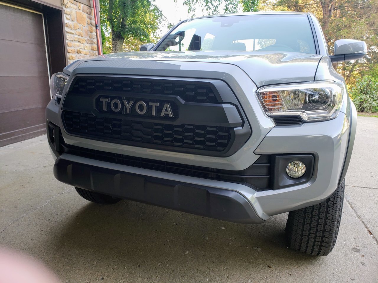

    I’m a little skeptical about the “Recalibration” of the TSS after installing a PRO Grille. I mean what exactly do they re-calibrate? There is no adjustment in the sensor itself. Is it a computer calibration? Can they change the angle of the “beam” through the computer?
    I mean really, do they go in and check th boxes that read “Lift Installed” and the check if it’s a 2” 3” or 6”? Then they check the box for the tire size. Or do they have a reflector on a wall that reflect the “beam” back to the sensor in the grille? So, if what Toyota says is true, we should have to recalibrate when a lift is installed, then when tires and wheels are added, and again if a PRO Grille is installed. I’m no engineer and I’m sure I don’t really understand the TSS but the following is my experience.
    1. Bought pickup, had an error because of snow on Grille during drive home from dealership. When I reached clear road and wanted to use the cruise control again, the TSS wouldn’t allow it. I stopped, cleaned off the sensor, and then the cruise control worked perfectly.
    2. No Errors after that.
    3. Installed lift, no errors.........
    4. After wheels arrived , wheels and tires installed, no errors.....
    5. Installed PRO Grille, no errors.......
    TSS has worked as advertised in all of the above configurations. Even the error I saw was......as advertised. I just turned 3k miles. Maybe I am missing something?????

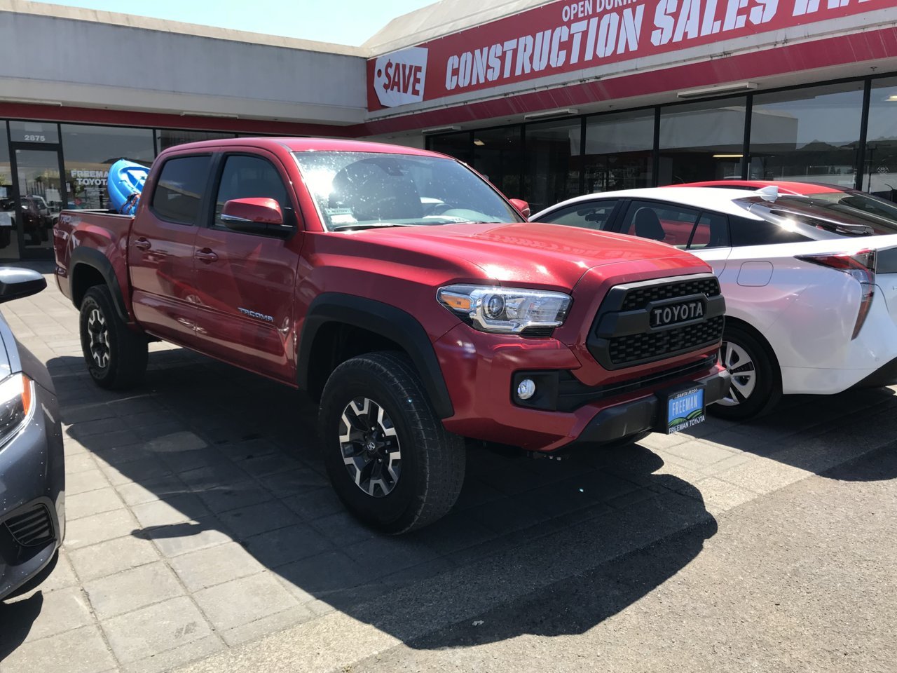

    Bought the pro grille when I bought the truck and had Toyota install it. Mine doesn’t have the garnish piece. No error messages, cruise control and everything works fine. 300+ miles with this grille
