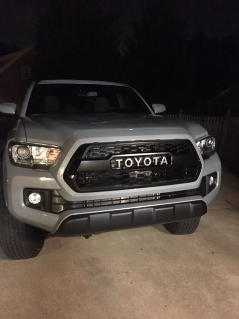

    OEM Grill/Garnish installed...took longer to get the damn TSS pigtail unplugged than everything else (Couldn't wait for daylight...used a headlamp) Pleased with it though...will test tomorrow.
